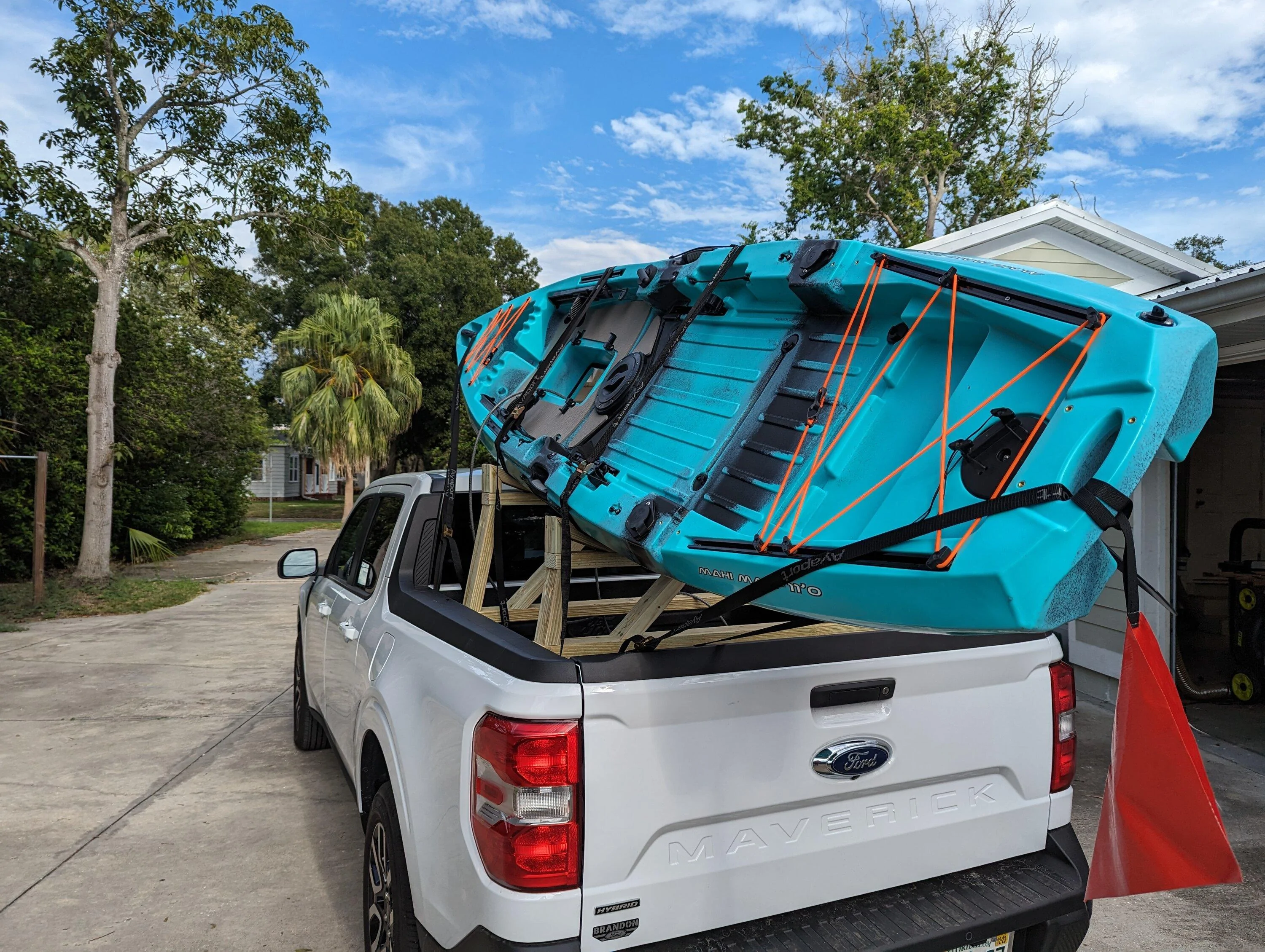

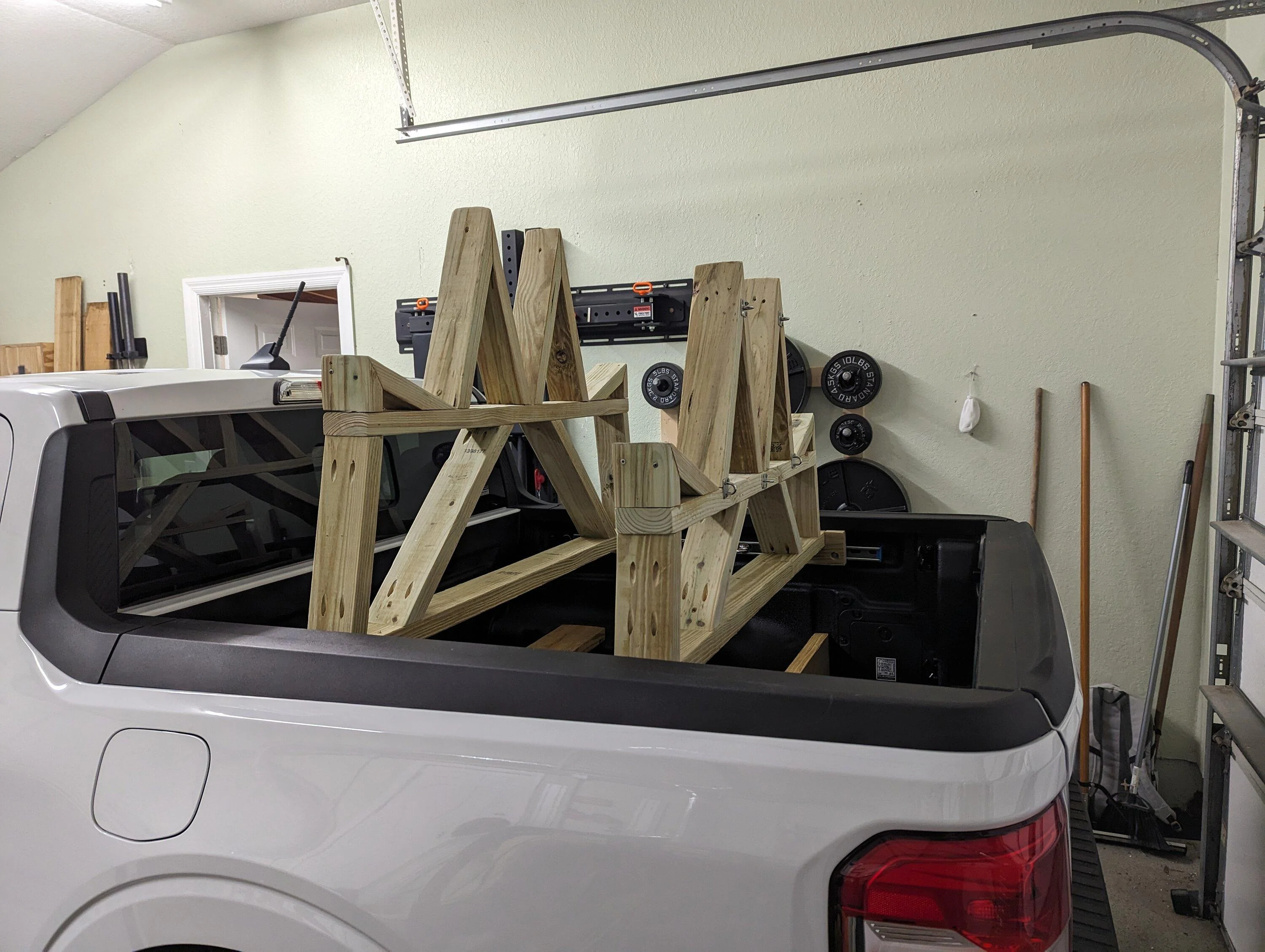

I wanted one of those Viking racks but the bed is too narrow for one, so I just went ahead and shamelessly copied their design. My version bolts on to the unistrut bed rail. Everything feels solid so far, but I still have to test actually driving around with it

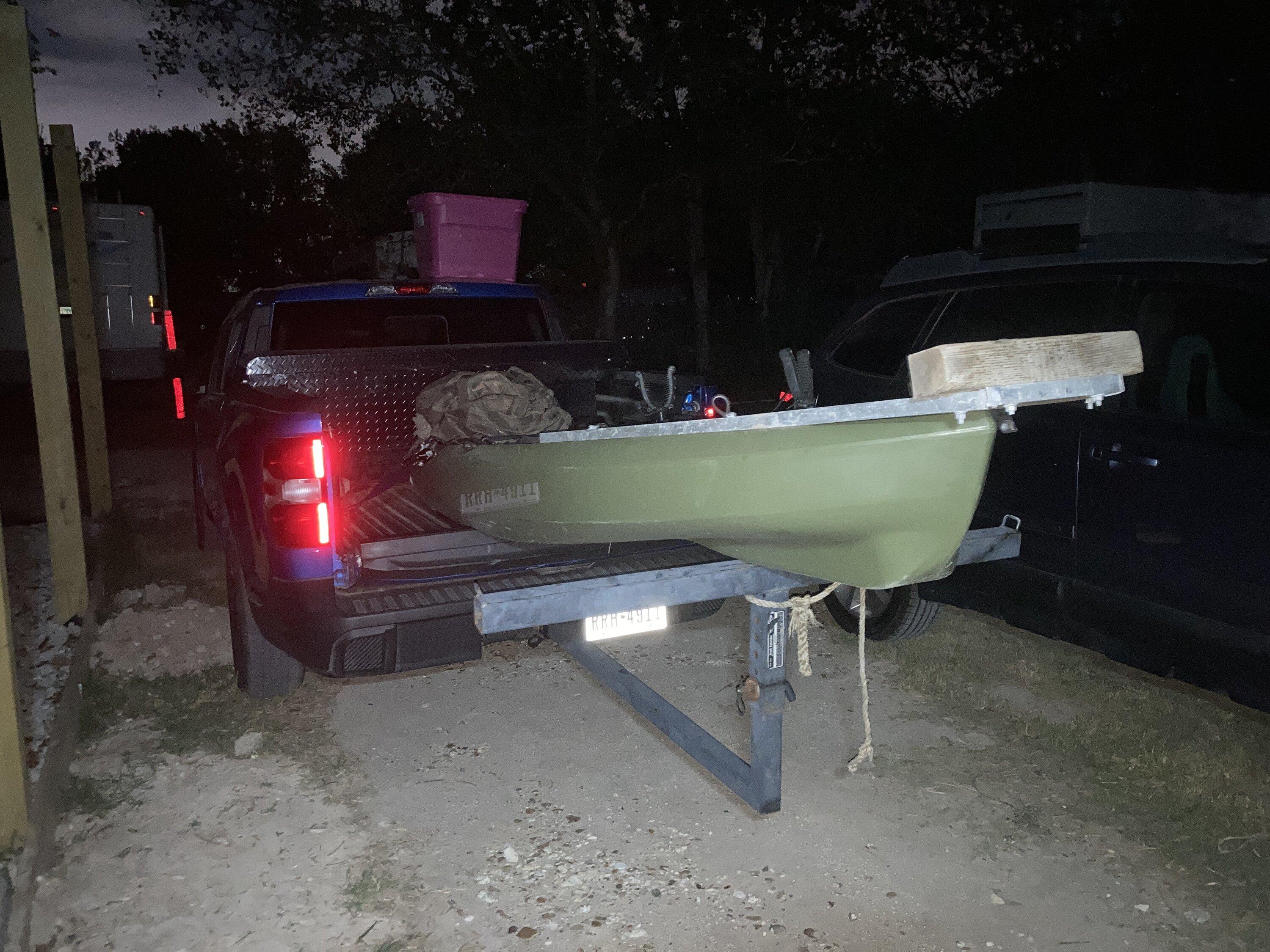

That’s a BIG YAK JACK!
My little 10 footer fits in there good on a HarborFreight bed extender

Nice! I dig it.looks like exactly what you needed.

Initially I just put mine across the 2x4 and 2x6 I keep in the bed + the tailgate in half down position, with a Sheett bed extender. It worked basically fine, but I was always really paranoid about the amount that hung out the back (this one is 11', our tandem is 12'). Hopefully this one will feel a little bit secure with just a little bit hanging out, plus I've got better access to the bed now
Great idea! Do you have a
Great idea! Do you have a close up pick of how you attached to unistrut rail?
I just notched some pieces of 2x4, then drilled and counterbored holes for 3/8 bolts that go into cone nuts
