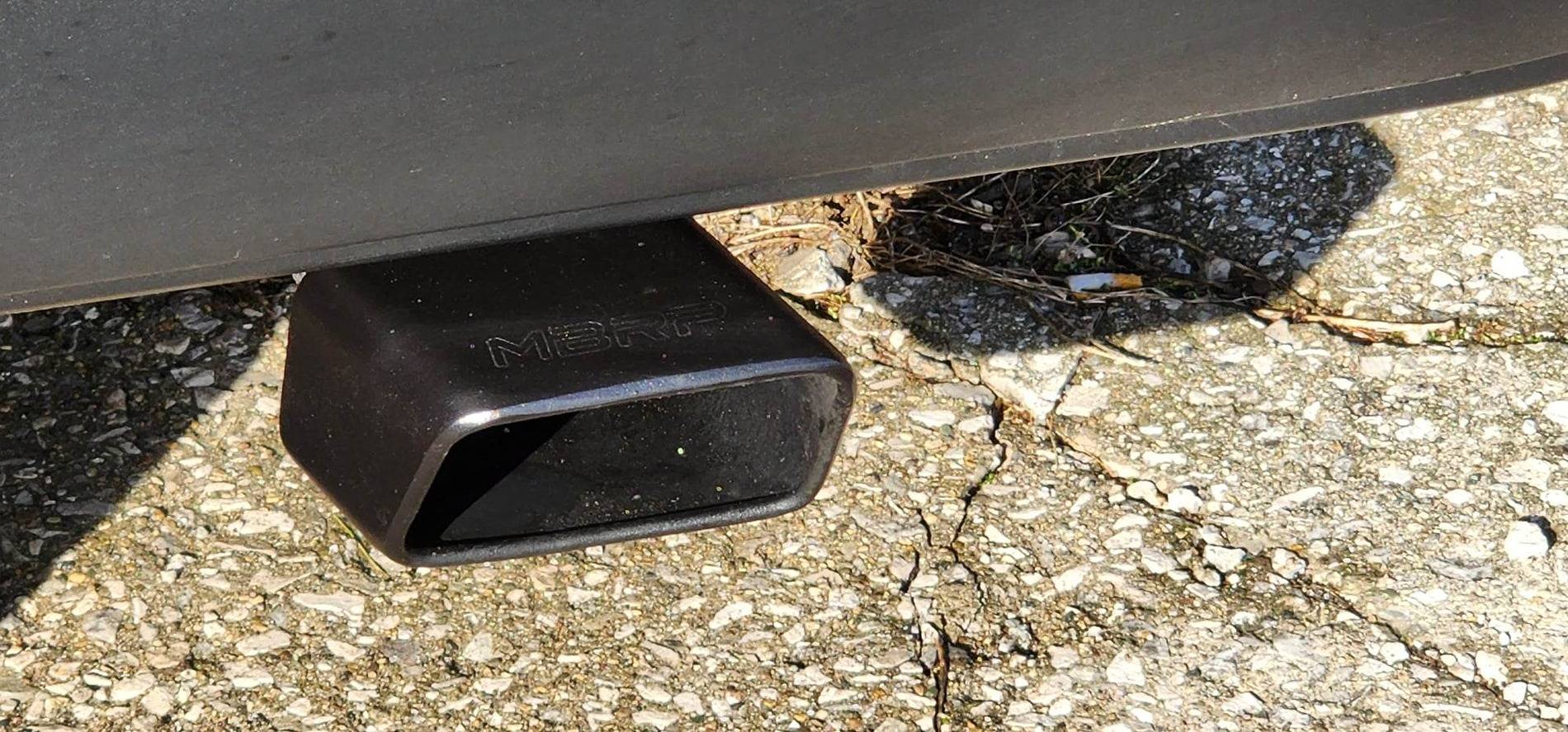

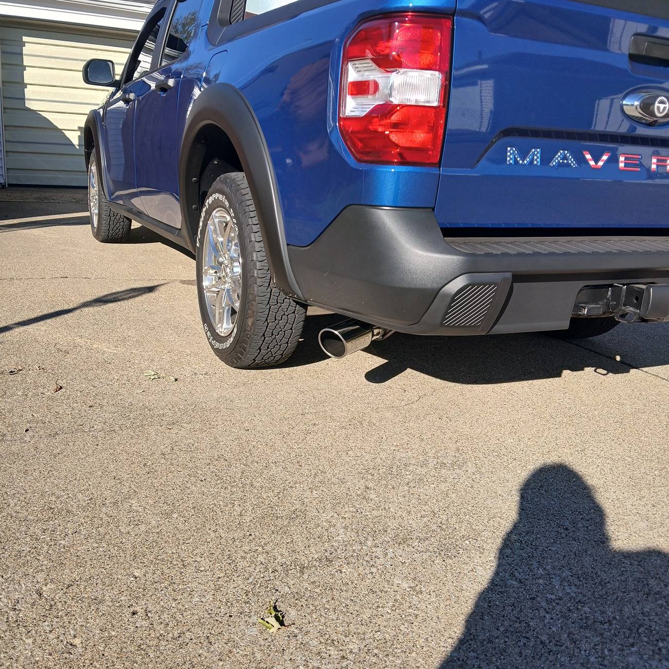

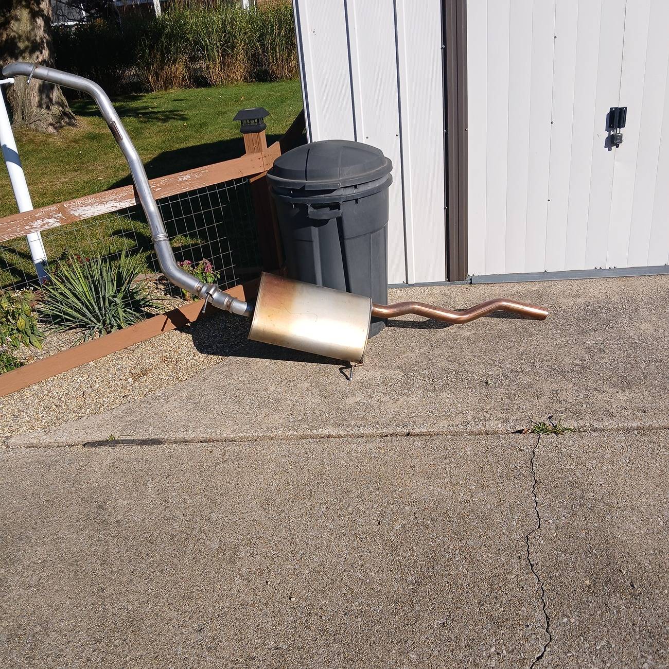

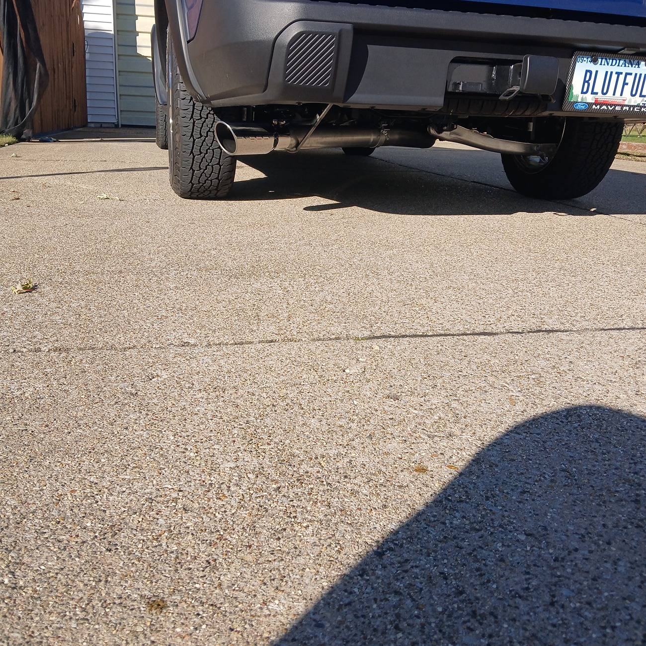

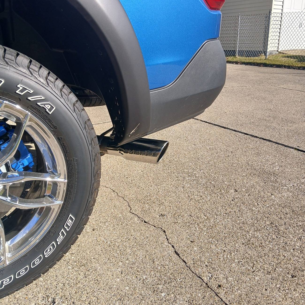

Probably my last mod on my 2024 ford maverick xl awd ecobost. Just replaced my stock exhaust system with MBRP cat back exhaust system uses all original rubber hanging mounts just have to cut the stock exhaust pipe 16 1/4 inches from the back weld on the stock catalytic converter. To cut pipe I got a exhaust pipe cutter from harbor fright $26 made job so much easier than saws all. Then it's just putting the new exhaust together. (Hint) make sure all ends of new system go together before crawling under truck and find out the pipe was smashed in shipping or whenever. But after getting that bent back out it went great. Doesn't sound much louder but I can tell the motor runs smoother and excellarates much faster. We'll worth $405.00 free shipping and no tax. Anyway I love it. Here are a few pictures

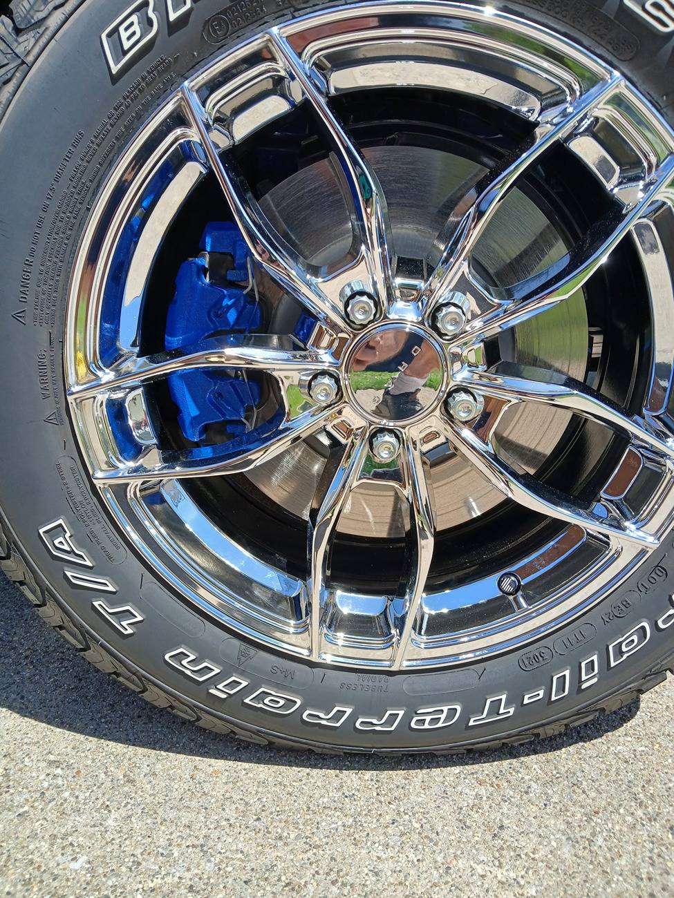

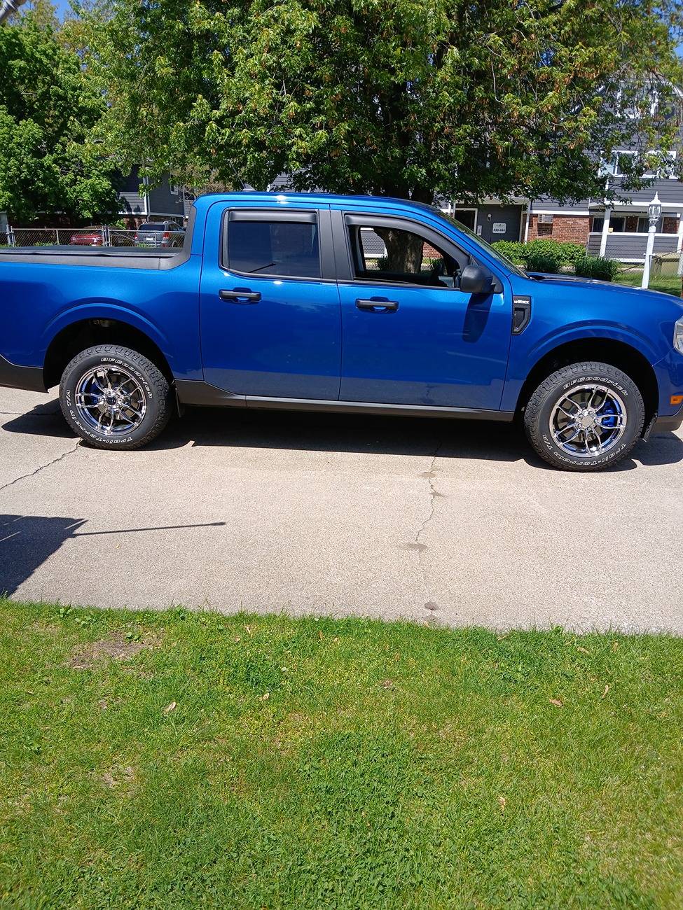

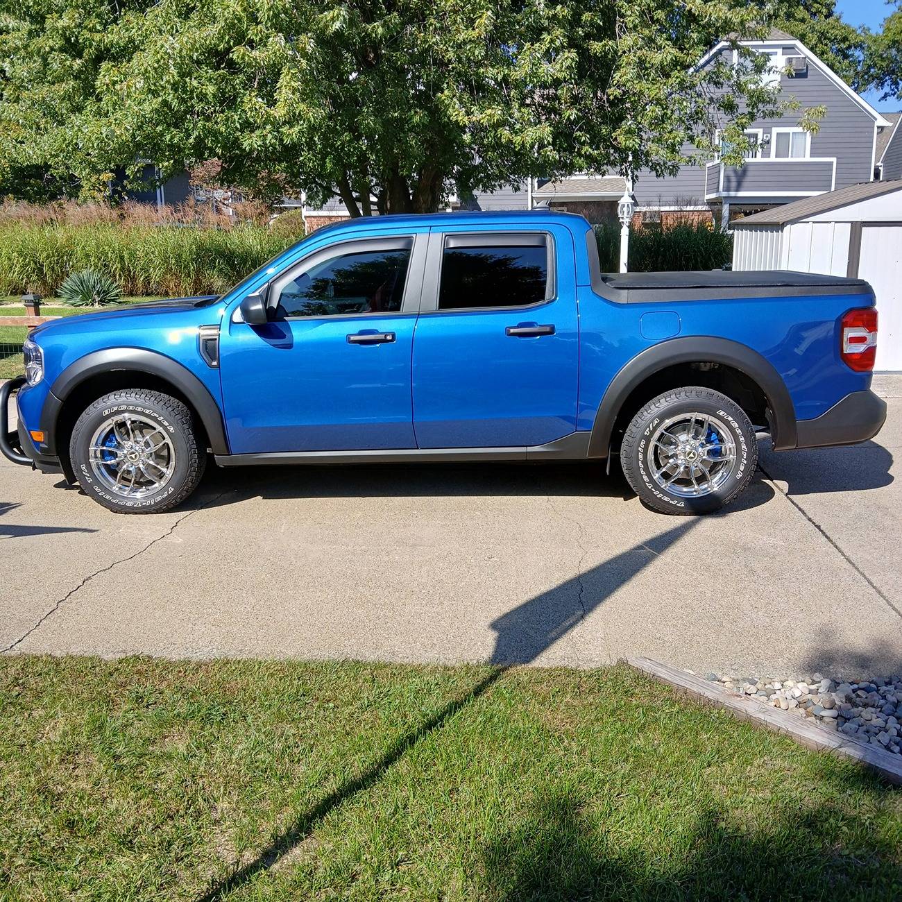

What wheels are on your truck? They look awesome. Could you possibly post a side view, and specs? I would appreciate it!!!
Sure here are a few pictures I got them at discount tire
Ford Maverick MBRP catback exhaust system installed 20240508_122356
Ford Maverick MBRP catback exhaust system installed 20240508_141554
Ford Maverick MBRP catback exhaust system installed 20240508_141630
  • Like
Reactions: Guv
Don's Maverick XL
Donald
Jan 22, 2024
49
233
419
MISHAWAKA
2023 Toyota Corolla hatchback SE
They
They are same size that came on truck they look like chrome but it's actually paint called virtual chrome really like that doesn't rust or oxidize but can chip if hit hard enough. And they shine like chrome. I have a fourm that shows all my mods. I have about $5,000.00 in mods already still have nurf bars to put on then I think I am done. Here are most recent pictures
