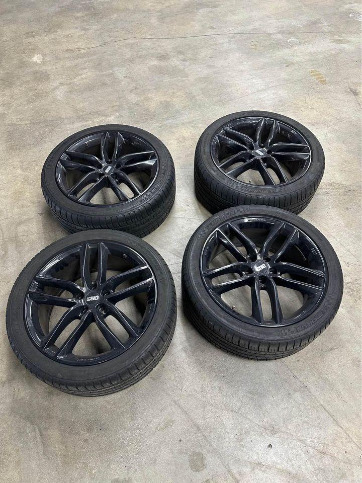

I have an opportunity to buy these off a fusion . 255/40/19 .
I wonder if they will fit and look good .
Wheels will work. Mine were previously on my old Fusion. But those tires are way too short for any Maverick. Note that those BBS wheels are around $600 each these days (I think I paid 1/2 that around 2017).

I can get the whole set for under $1000 . He wants a grand and I offered $800 . They have the sensors and the tires are sport pilots .
Grab them. You can sell the tires for about $50 each, and then buy the correct size tires. As I have already posted, 245/55R19 are perfect and your speedometer is only off 3%. If you desire the stock diameter, then get 245/50R19. By the way, unless you know how old they are, get new sensors. They are designed to die after about 5 years.

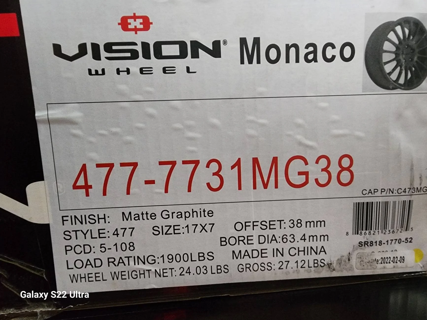

Just a worry wart here and I'm looking for confirmation of these Vision wheels. I should have no problem with them on 225/65/17, correct?
I am an old geezer and never really learned much about cars. Trying to educate myself now with my new 2025 Mav 2.0 pictured below. 1st truck I have even owned and so far loving it - not the steelies though, lol.
