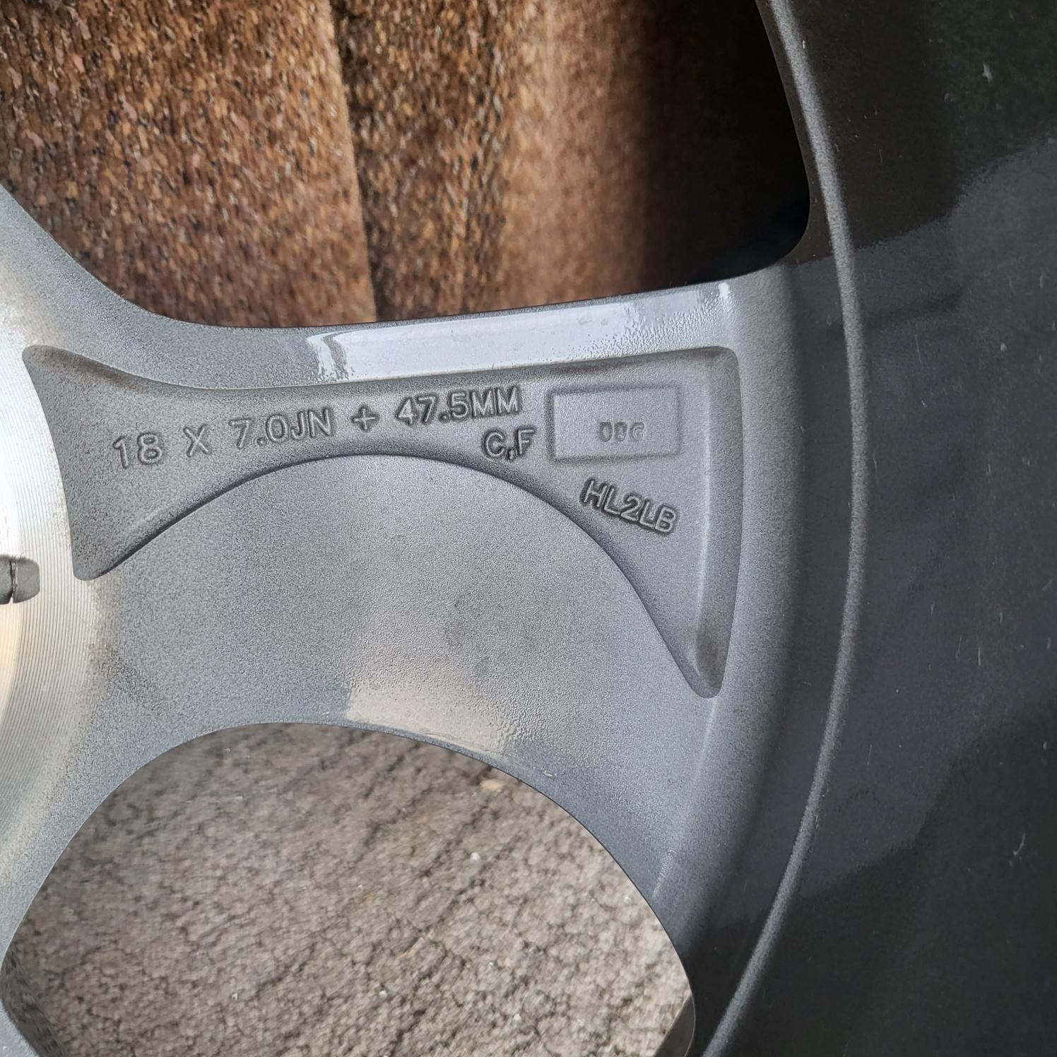

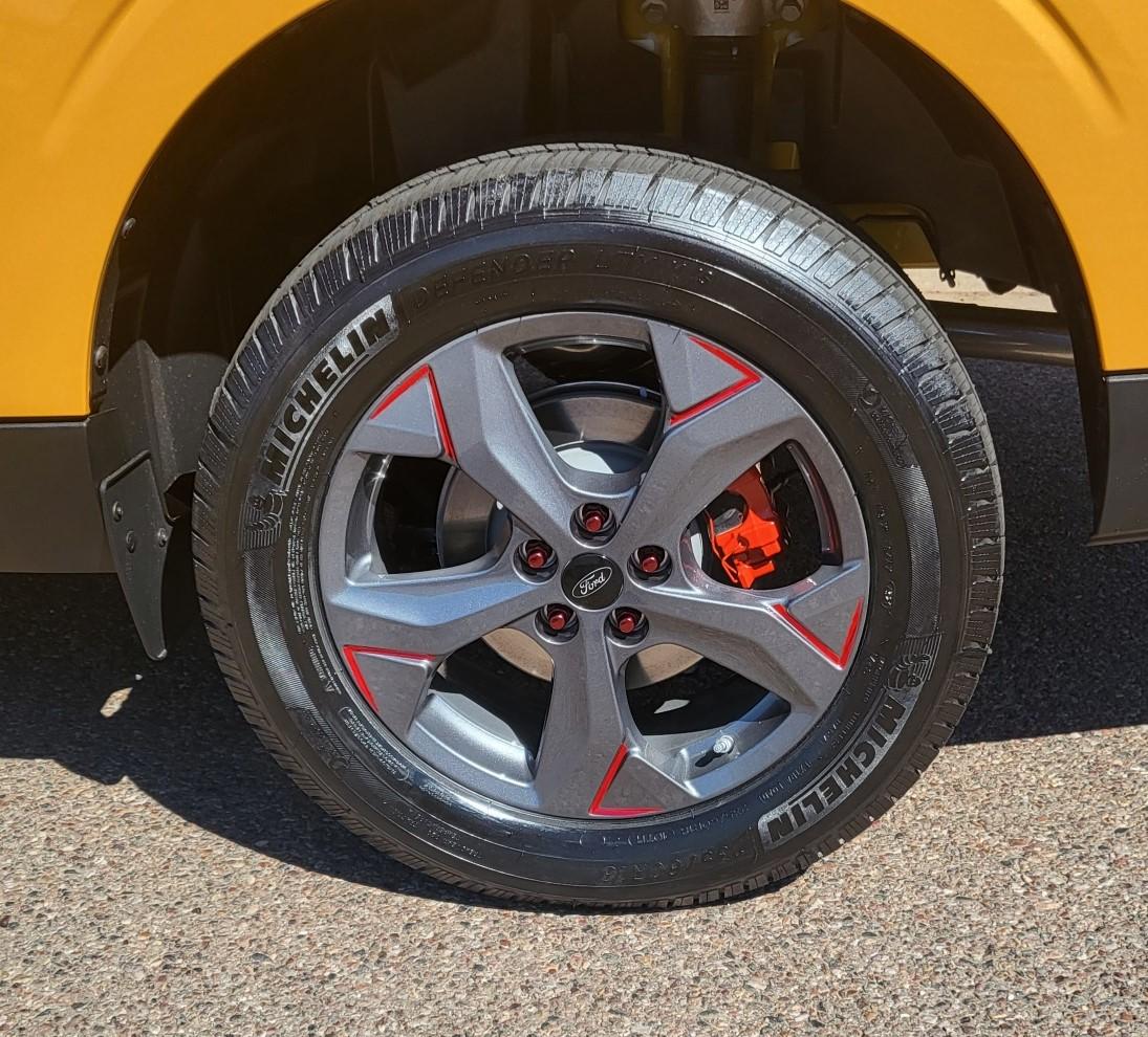

I am not running that set up, but there are several on this forum that have Focus wheels that are 52et.
I have 18" Mustang Mach-E wheels that are 47.5 et and they work great.

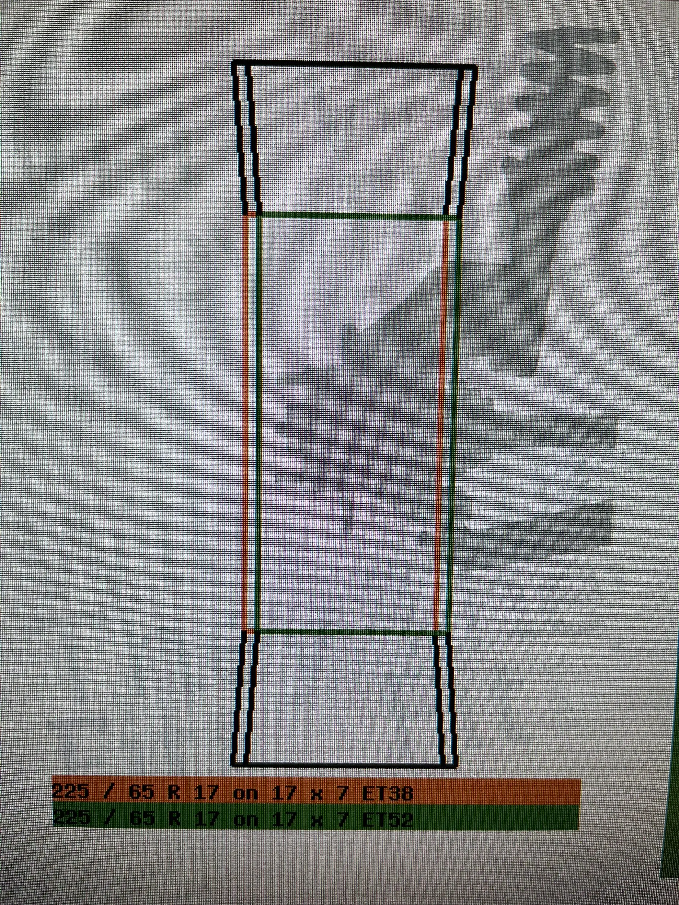

If your new wheels are the same diameter and width as the factory wheels and the only difference is the offset then the new wheels will sit 14mm farther in

Here’s a visualization of what that looks like. The green outline is the new wheel with the 52 offset, again assuming all else equal
