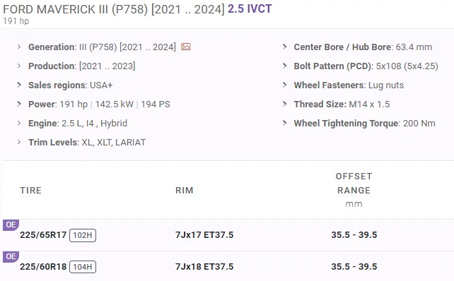

Hey guys, does anyone know what the ‘offset’ is on the ‘23 Maverick ‘steel’ wheels? I know, I know…I could pull a wheel and measure ‘distance from center’, but I’m hoping that somebody already knows…and saves this old man 👴 from having to crawl on the floor…

37.5

Can you translate? Is that in mm, so ~1-1/2” positive offset?
Yes that is mm.
So, 37.5 millimeters = 37.5 × 0.039370078740267 = 1.47637795276 inches.
Approximate values for 37.5 millimeters in inches
  • 1 1/2 inches (5% greater)

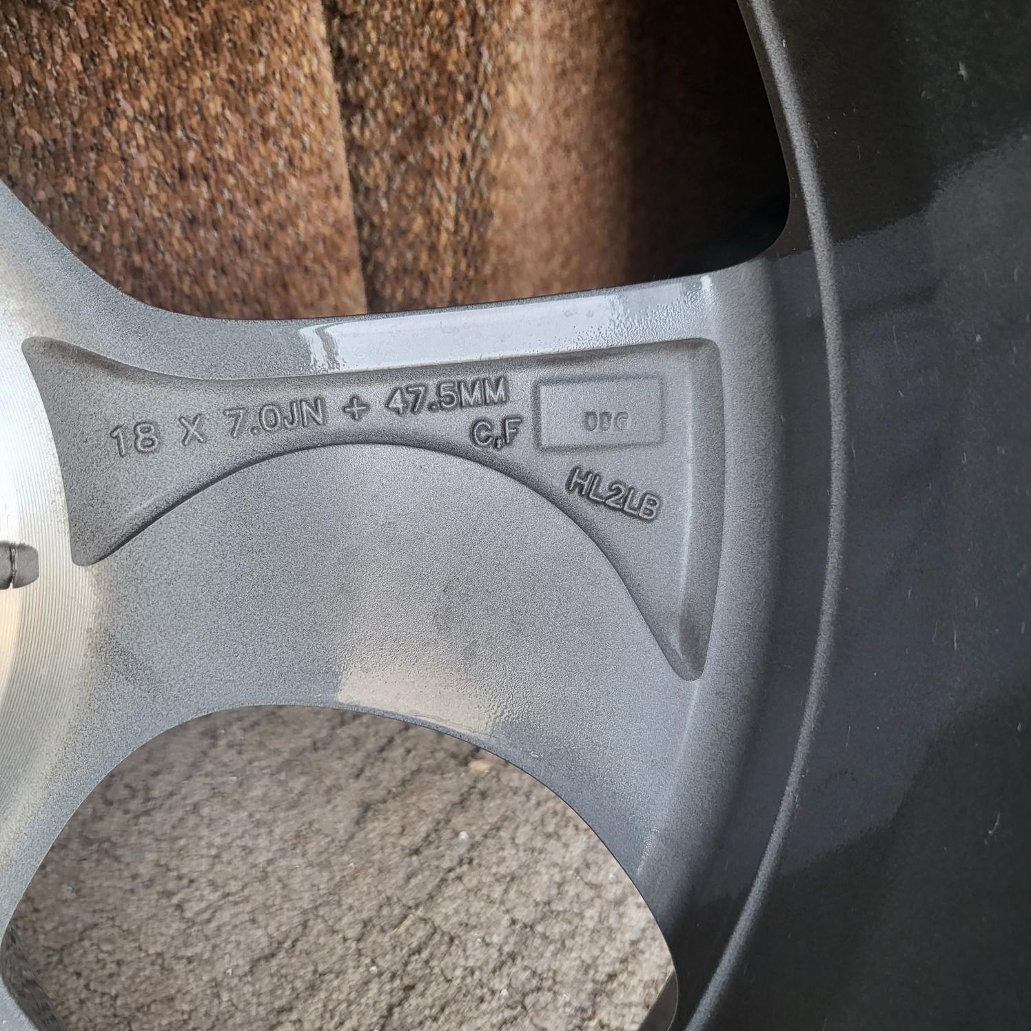

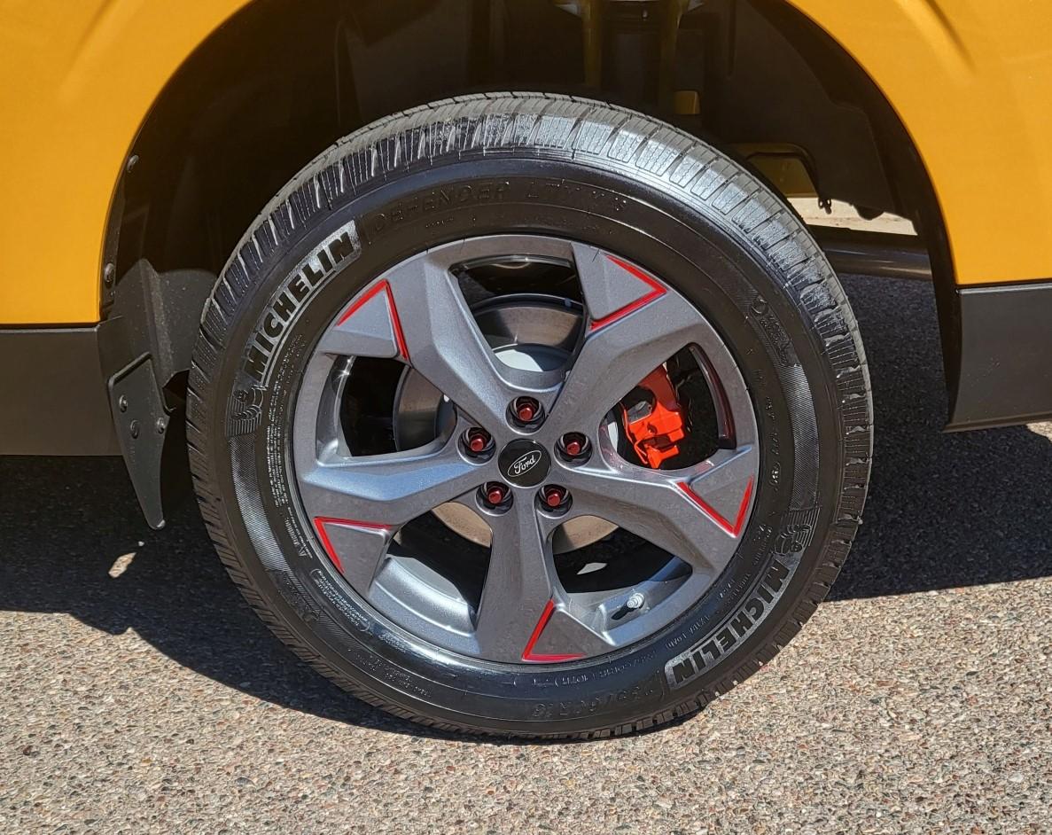

Phil,
the wheels on the Cyber Orange (in my Photo) are from a Mustang Mach-E. They Have a 47.5 offset and they work great (also they are 18" wheels) here is a photo of the back. The difference from stock is 10MM, or it sits slightly inward. closer to the center of truck by about .4 of an inch.
