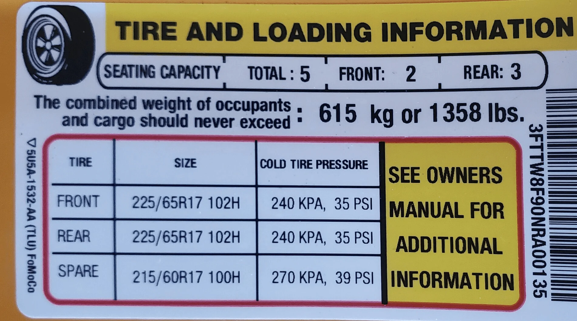

Of course, but that doesn't change the payload disproportionately. If you use your door sticker as a reference, you'll notice your max axle weights, when combined, are greater than the max allowable GVWR by 250#'s. This allows some variation of load balance, FR to RR. So, with just you sitting in the front, your front GVWR will likely be under (assuming you are not a "large" person...), allowing you to max your RR GVWR, and still be under total GVWR.
Which comes out to ~1300lbs, its the post you dismissed as overthinking it by doing actual math, lol! They wouldn't give you two stickers and warn you to abide by them if you were just supposed to pass gas in the direction of the second sticker and ignore it.

No that is not how bed load capacity is calculated.
The sticker in the driver door frame is the max bed load capacity WITHOUT anyone in the vehicle. You must subtract the driver's weight and the weight of anyone or anything else in the Cab.
San-Gen-Shugi my friend. Until you weigh your truck, it's hypothetical. I'll maintain that, based on actual weight, the payload sticker will be within RR GVWR.
Cool, I learned what the "3 realities principle" is. "There is no substitute for direct observation". Very zen-like....
You're right, gotta weigh the truck first to know what actual front GAW load and rear GAW load is before other "payload" is applied. Then with xxxx lbs in the bed (assuming xxxx lbs = doorjamb payload rating), re-weigh the truck, what is new front GAW load and rear GAW load, and are they less than or greater than front and rear GAWR's from federal safety cert. label.
But I'm not as confident as you are that if you did that (put sticker value payload in the bed) you'd still observe on the scales a rear GAW that's less than the finite rear GAWR value.
An extreme and totally unrealistic example: First weigh your truck with just you in it. Get your measured GVW, front GAW and rear GAW numbers. Assume your payload sticker is exactly 1500 lbs. Now place a 12" W x 12" L x 25.5" H block of lead (~1500 lbs) in the bed directly over the rear "axle" of an AWD Maverick. Put it back on the scales and see what new measured front GAW and rear GAW values are. A dollar to donuts the "new" measured front GAW is less than what it was with the truck empty (duh). And the "new" rear GAW may be greater than the rear GAWR from the door sticker.
Remove lead from bed. Now, seal off all edges and corners of the bed, and fill the bed with ~180 gallons of fresh water (~1500 lbs). Weigh the truck again. Dollar to donuts the "new" measured front GAW is again less than it was when the truck was empty (but not as much less as it was with the lead). And the "new" measured rear GAW may again be greater than the sticker rear GAWR (but it will be less than what was measured with lead in the bed).

For sure. Where the load is centered plays a significant role in the FR/RR split.
Regardless, if I ever get a Mav, I will abide by the yellow payload sticker when determining how much I can carry in the back, minus myself & other stuff, of course,just like every other truck I've owned.

So upon further research, I think the first video was actually quite overloaded. Looks like you have to pick the weakest link when loading, as they list maximums for the front and rear as well, so ideally some of that load would be tossed in the passenger footwell and fold the seats up and put in the back as well to balance it out more, and not all in the back.
Exactly, you must not exceed any of the weight ratings including Front GAWR, Rear GAWR, GVWR, and GCWR.
