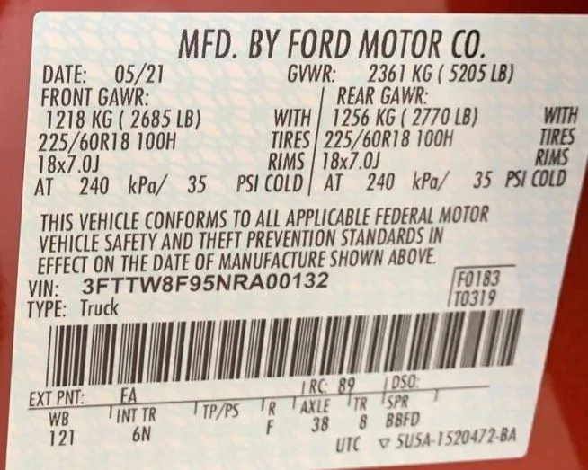

Not according to door sticker though, and also warned again on owner's manual to heed both the total vehicle payload but also axle payload:
When adding accessories, equipment, passengers and luggage to your vehicle, do not exceed the total weight capacity of the vehicle or of the front or rear axle (GVWR or GAWR as indicated on the Safety Compliance Certification label).
Ford Maverick Maverick payload capacity maxed out w/ 1500lbs in bed - test by owner Captur
Anything in the bed should abide by "REAR GAWR" limits as well. Above is from a Lariat trim.

JASmith's Lariat door sticker: note that if you add the front GAWR and rear GAWR, it isn't the exact number as the GVWR. Which makes sense. It's a design thing.

So that's like 60/40ish, the Maverick being another unibody truck may be the same. So if vehicle is 3700lbs, 40% of that is around 1500lbs. Rear GAWR is 2770lbs - 1500lbs = 1300lbs you can put in the bed.
At least, I think that's how you math it, which would have put him at 200lbs overloaded in the rear, and with his own weight also maybe 200lbs overloaded all together, so either way he technically should have stopped at 1300lbs of gravel.

Of course, but that doesn't change the payload disproportionately. If you use your door sticker as a reference, you'll notice your max axle weights, when combined, are greater than the max allowable GVWR by 250#'s. This allows some variation of load balance, FR to RR. So, with just you sitting in the front, your front GVWR will likely be under (assuming you are not a "large" person...), allowing you to max your RR GVWR, and still be under total GVWR.
