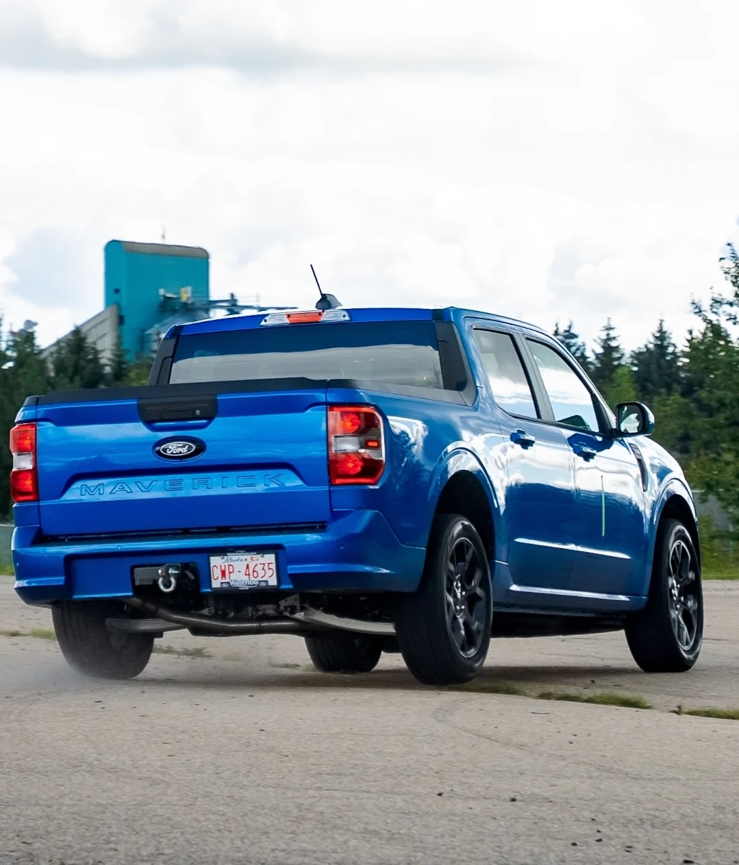

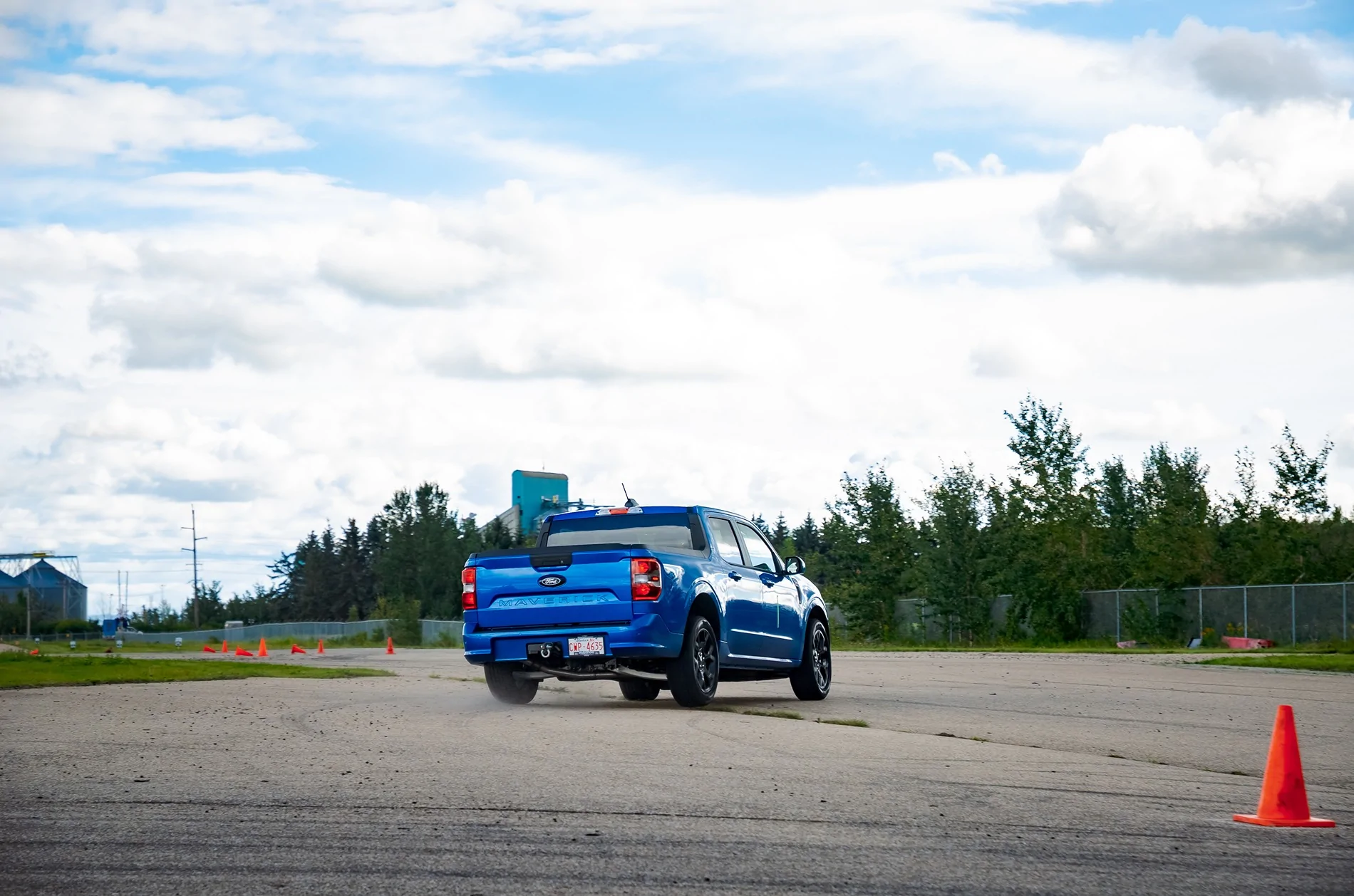

Winter’s in full swing, so here’s a throwback from when the truck was completely stock.
Didn’t think it would ever tripod… turns out it definitely does.
Pretty sure this explains why the ESC likes to kill power on corner exit.
Great picture.
I don't really know everything that Lobo mode changes, but are you turning off traction control too (short press on the ESC button), or are you shutting down AdvanceTrac completely (hold the ESC button until the message changes to AdvanceTrac OFF)?
I'm surprised it would still cut power with AdvanceTrac off

Great picture.
Even with AdvanceTrac off, it’ll still cut power. In tight, low-speed parking lot AutoX it almost never happens, but on bigger, faster courses it shows up.
I’m guessing it’s some sort of rollover logic that only kicks in above a certain speed and steering angle — and maybe once it senses a tire lifting.
Feels very similar to a Mazdaspeed 3 I had that would cut boost based on steering angle.
