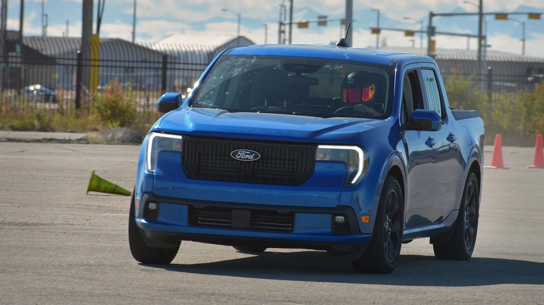

Ford Maverick Maverick Lobo Autocross Testing & Handling Upgrades 1000014723
Update
Track season has officially wrapped up in my area, and what a season it’s been! Since picking up the truck in early August, I managed to hit 13 events — and made steady progress at every single one.
Early on, just going from stock to a few basic mods made a huge difference. After that, it was all about learning how to drive the truck properly and finding its rhythm. Each event I crept further up the results list — from near the bottom early on, to mid-pack after the mods, and finally cracking the top 10 overall at the last event of the year.
The truck definitely turned heads everywhere it went. It quickly became the “one not to get beat by” for a lot of drivers. Every event, people were taking pictures and videos, amazed at how quick it moved through the course. Let’s just say… a few egos were bruised along the way.

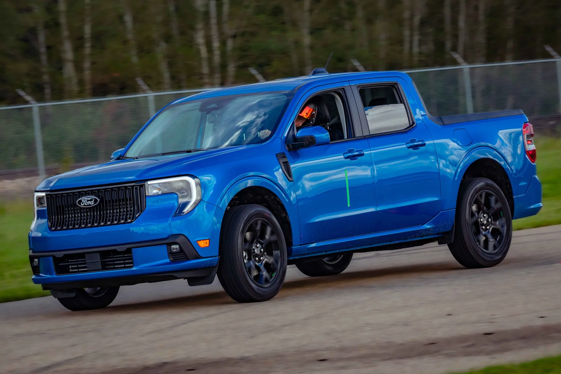

Ford Maverick Maverick Lobo Autocross Testing & Handling Upgrades 1000014970
Driving Notes / What I’ve Learned
A big chunk of my improvement came from just figuring out how to drive this thing effectively. It has a few quirks that require adapting your driving style:
  • Left-foot braking is key. You need to keep a bit of throttle applied at all times. If you come completely off, there’s a noticeable hesitation before power comes back in on corner exit. It’s not too bad on sweepers, but in tight autocross turns it really shows.
  • Leave it in automatic mode. I tried running in manual mode vs. full auto, and the truck consistently put down faster times in auto.
  • Launch around 2,500 RPM. That seemed to be the sweet spot — strong off the line without beating on the drivetrain.
  • Drive it aggressively. To really take advantage of the torque vectoring, you’ve got to stay in it. The extra camber and larger rear sway bar made a noticeable difference in stability and corner exit grip.
  • Go easy on the brakes. The electronic brake boost is pretty sensitive — I was braking with about 40% less pressure than I would in other cars. Anything more would start to lock up the tires.

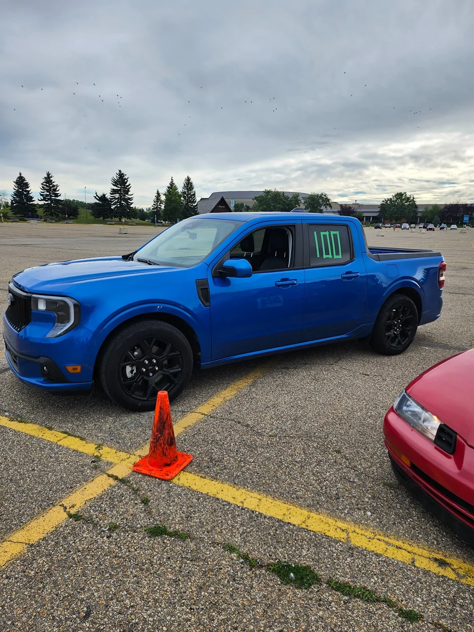

AutoX Testing:
In stock form, I took it to one of my own events—StratoCross—which is an AutoX held on an oversized go-kart track called Stratotech Raceway.
With the truck having only 200 miles on it, I kept the acceleration tame. I just wanted to do a few runs to see how it behaves at the limit and where it needs improvement.

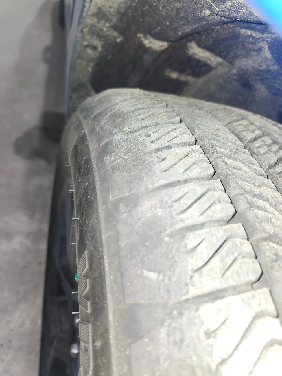

  • The stock tires are awful. Just light braking into the first corner caused them to lock up instantly, with ABS going crazy.

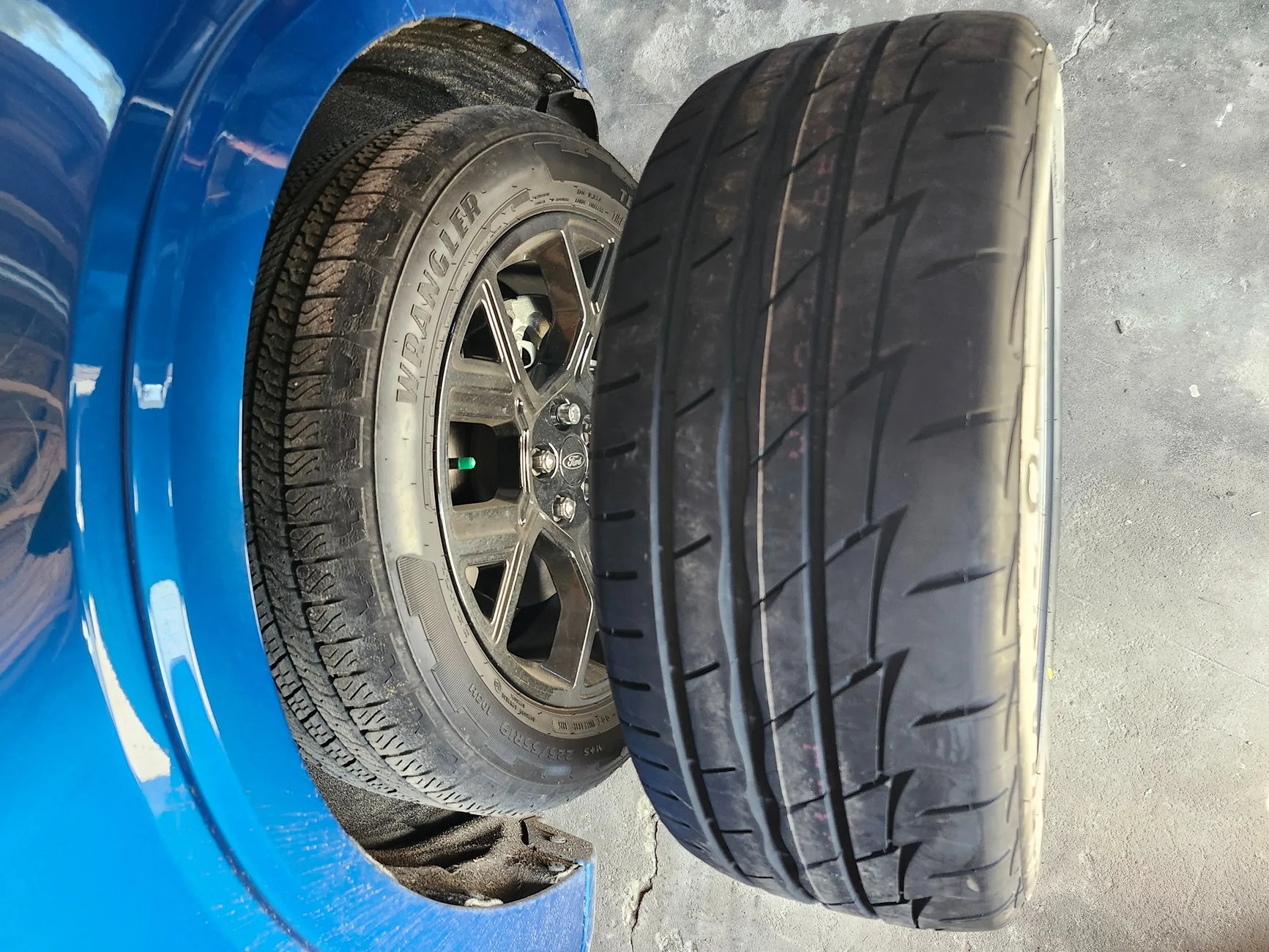

Better Tires:
This is the biggest factor—80% of the performance gains will come from better tires.
Since I’m sticking with the stock 19x7.5" rims for the rest of this season, my options are limited. To maintain stock diameter, the best tires I found were a few UHP-rated summer tires, but none are ideal AutoX tires.
I went with Firestone Indy 500s in 245/50/19. They're far from great, but good enough to help me close that 4-second gap—and they’re cheap.
Next season, I’ll upgrade to lightweight 20” wheels and proper 200TW tires, once sizes are back in stock. That alone should knock off another 1.5–2 seconds.

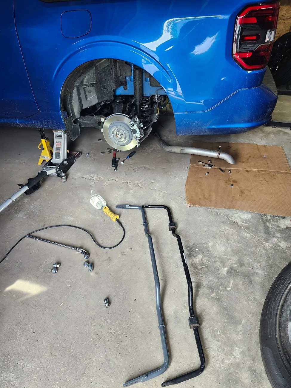

Rear Sway Bar:
Most OEM setups are tuned to understeer for safety, and the Maverick is no exception. For AWD vehicles, it’s common to run the stiffest rear sway bar available to improve rotation.
I went with the Goodwin Racing rear bar

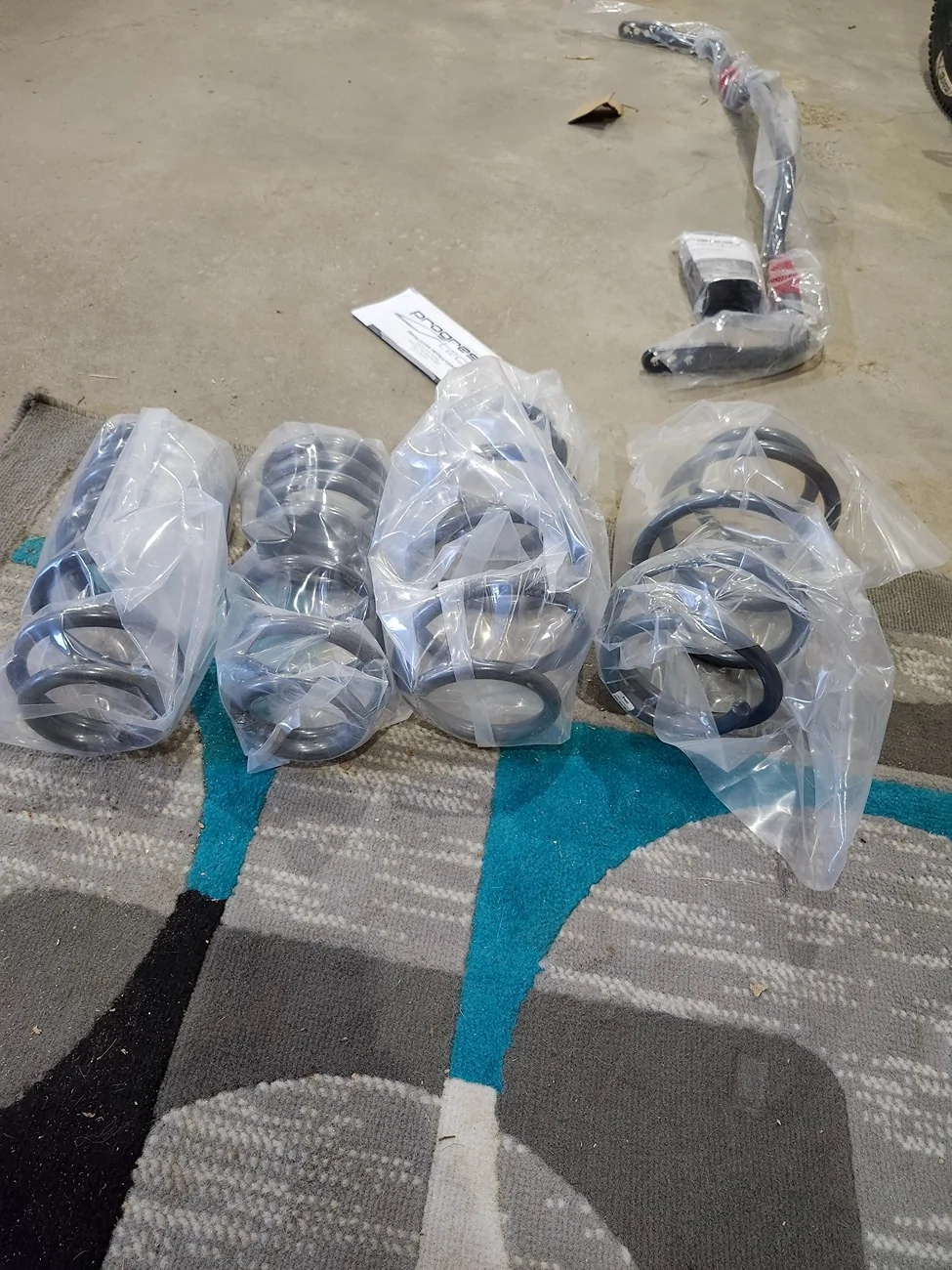

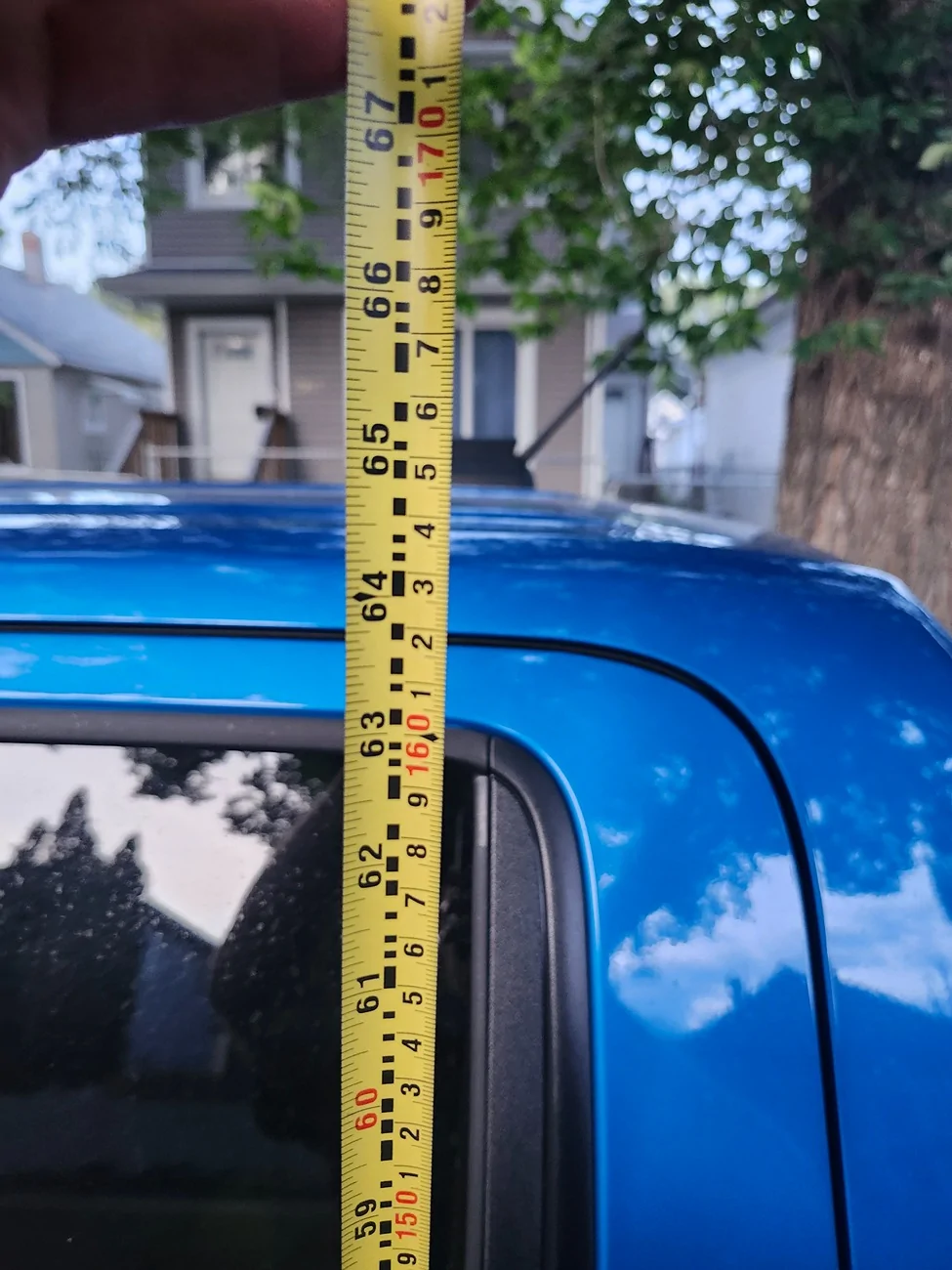

Springs:
One issue with the Maverick is its height-to-track-width ratio. Some AutoX events require a 1:1 ratio. The truck sits at ~65" tall with a ~63.5" track width—about 1.5" off the requirement.
As a daily driver, I still want a comfortable ride. Lowering springs are a simple fix that also improve handling.
I bought a Goodwin Racing spring + sway bar package. The spring rates are only slightly stiffer than stock, so they still work well with the OEM shocks.
Note: Even with these springs, I’m still ~½” too tall for the 1:1 rule. However, most organizations should still allow it. If needed, H&R Super Sports might get you within spec.
(In my region, they go by overall width, not track width—so it's allowed in stock form.)
Alignment:
Lowering gave me about:
  • -1.0° front camber
  • -1.3° rear camber
But the front still needs more camber to reduce understeer & the toe needs to be zeroed out to help it turn in better.
I installed Eibach camber bolts to get the front camber close to -2.5°—the usual max for a daily without excessive tire wear.
I'll be setting:
  • Front toe: 0° (from factory toe-in)
  • Rear toe: 0° (from factory toe-in)
  • Front Camber -2.5°
  • Rear Camber -1.3°
Upcoming Testing:
I have a few more AutoX events lined up. We’ll see how close I can get to knocking off that 4-second gap with these basic mods!
*Update- The Changes listed knocked off more than 4 seconds!
Autocross Classing Issue:
If your local club uses SCCA classing, the Maverick technically doesn't meet the height-to-track-width requirement and won't be classed.
However, I entered it into G Street Touring without issue.
