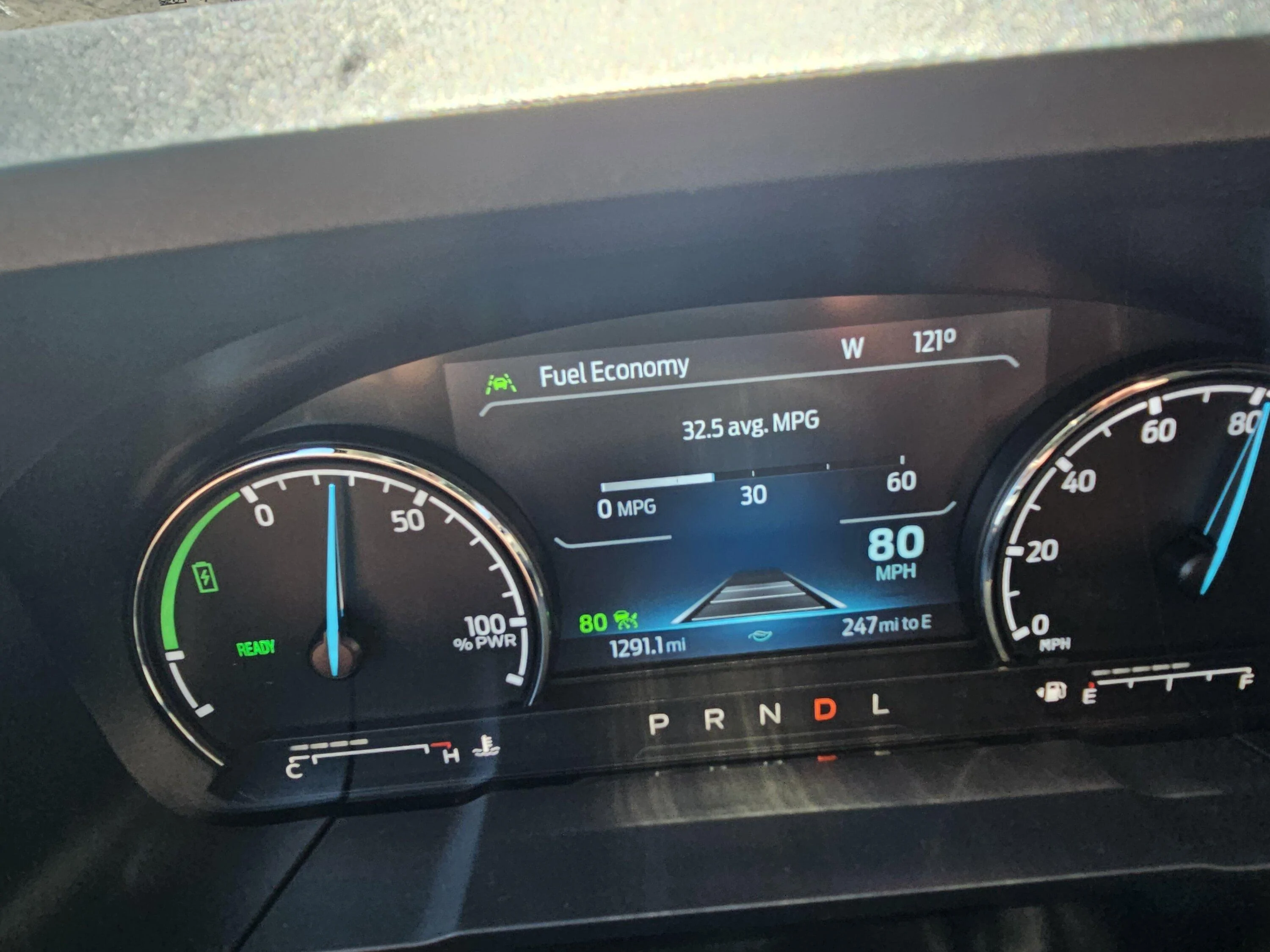

Driving home in the new Maverick from Long McArthur Kansas to California. Passing through Baker, CA 121 degrees. Stayed nice and cool inside 😊
121 degrees!!? 😳 Should have taken a picture with Baker's World's Tallest Thermometer 😆
