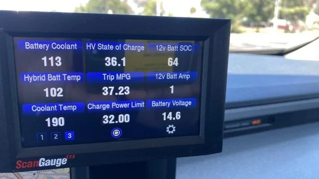

Mmmm. No. Not quite. The upper limit is still not documented. But it's higher than that. See mine yesterday:
Ford Maverick Maverick in hot temperature 9EF29702-26B8-46A3-BC71-94371E9E1C3F
118°F and no reduction in battery power. Charge limit (kW) is always 32.0 maximum and tapers with high charge; low and high temperature. No taper witnessed at 118°F.

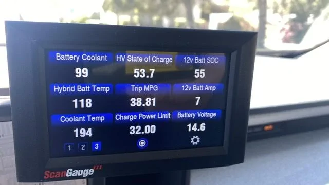

I presume the 99 battery coolant temp shown in your picture is the output temperature reading and not the input?
Unknown. I have yet to track down where the sensor is located.

Okay. Regarding the HV Battery:
At less than 50°F the system is supposed to add heat from the exhaust.
At above 95°F the system is supposed to add chilling from the air-conditiong.
Presumably in the middle it is just circulating through the radiator.
The battery is allowed 122°F before reduction in use.
This photo makes sense to me:
Ford Maverick Maverick in hot temperature 11CC8C3C-257A-4407-9BCD-EB161BA376A3
This photo is confusing to me:
Ford Maverick Maverick in hot temperature 545C889D-11B2-4AC7-9E67-DF0DCFB4352A
About 80°F outdoors.
