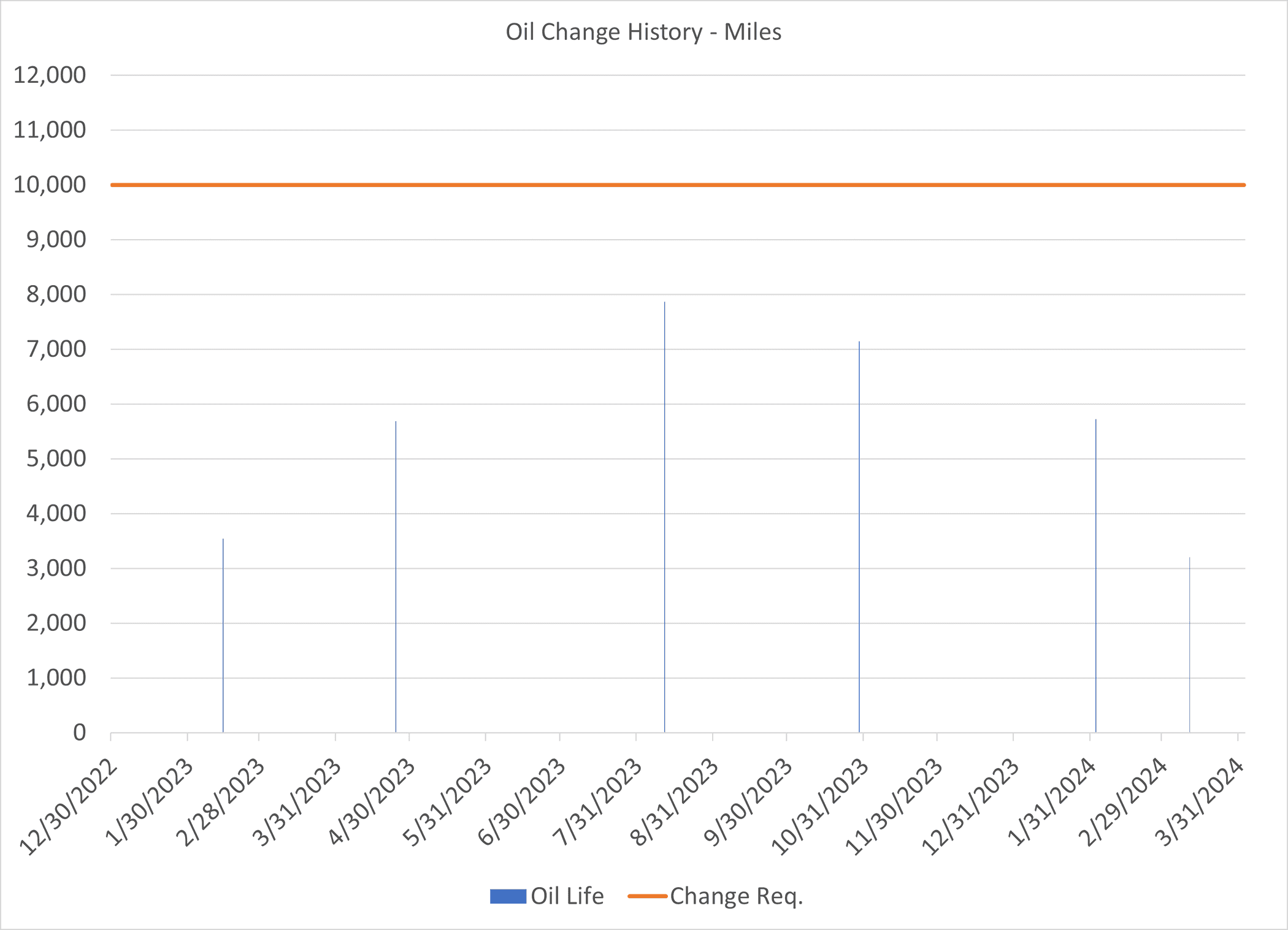

I am not saying what I did is right, but I haven't had any issues. I got my first oil change 45 days and 3,500 miles after taking delivery. I have continued to try and stay below the 10,000 mile recommended oil change interval and I utilized synthetic oil. I currently have 35,000 and have changed my oil 6 times.
Ford Maverick Maverick Hybrid Oil Change IMG_0348
