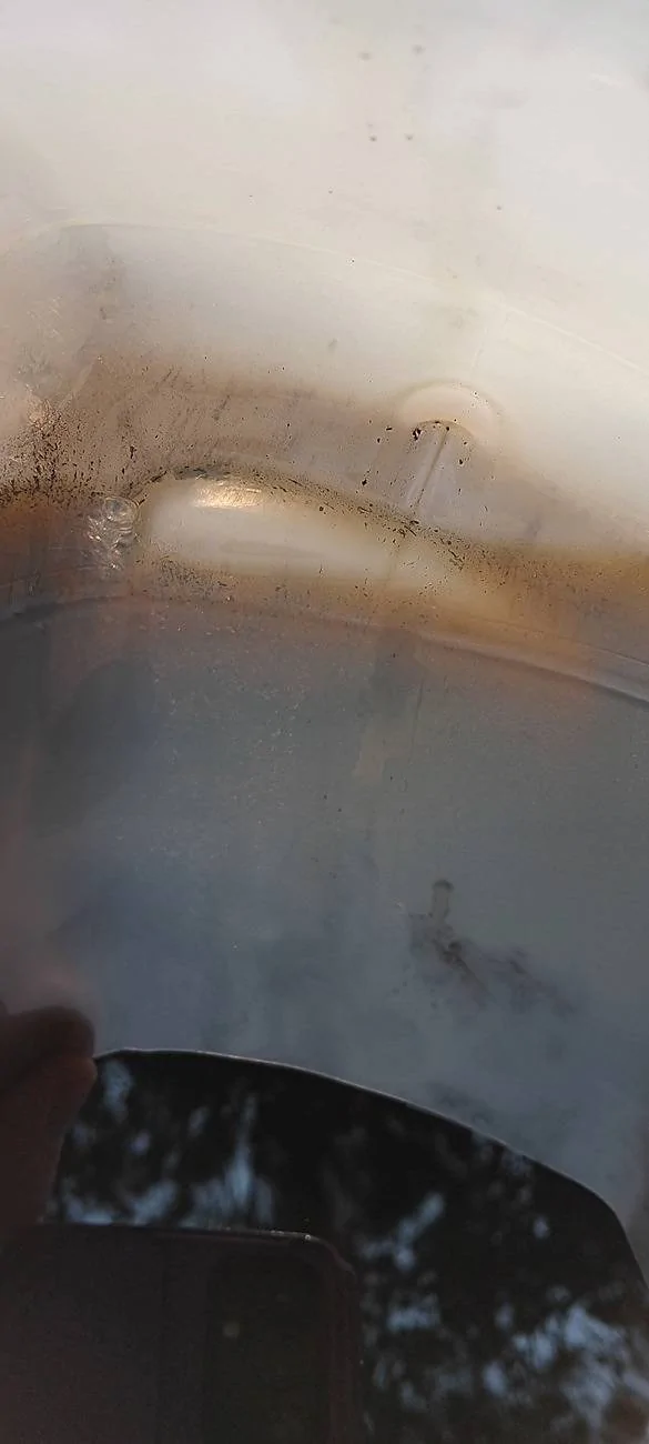

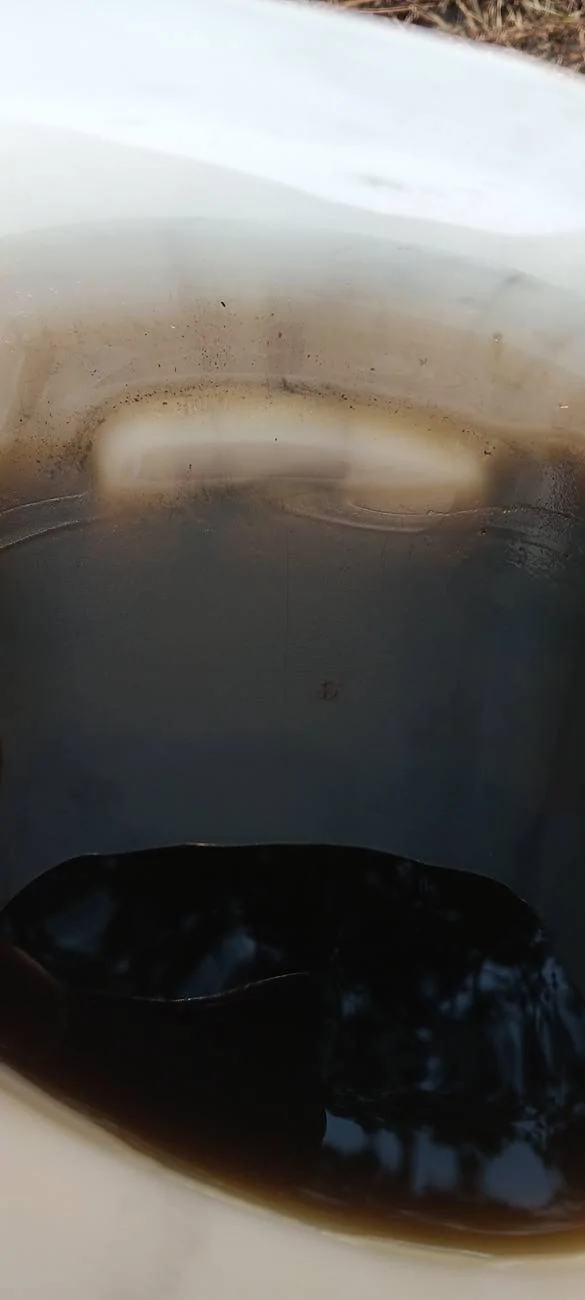

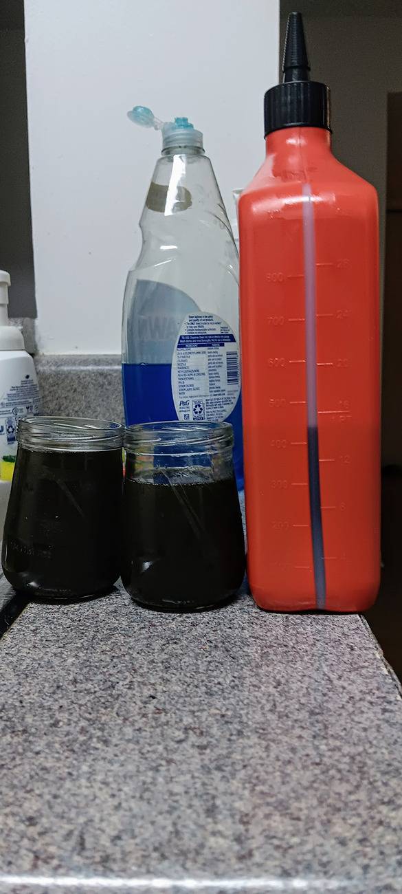

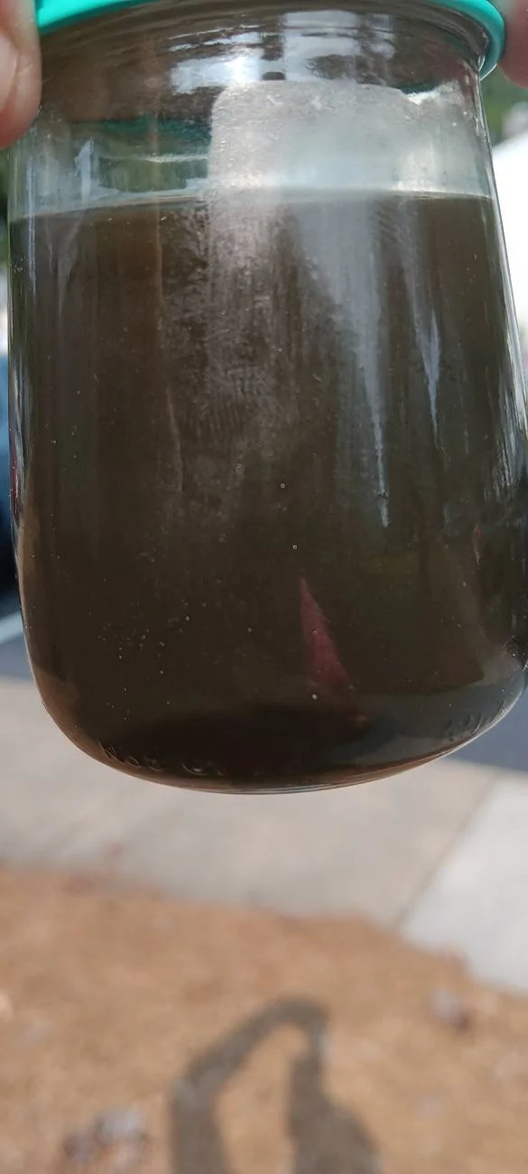

I've read that the factory underfilled the PTU and that the oil is full of particulate. Well, both were true for me. Got 8-10 oz out, PTU held 16. As you can see, the oil has 0 translucense and tiny, shiny specs of something in the sunlight. People should probably change and fill early.
I just had mine changed both the front and rear at 26,000 miles yesterday. I have read on this forum to change it early because of possibility of being underfilled and the front PTU might have burnt fluid with debris on the magnet because of location. What I found was that both units had coffee black fluid in them and magnets were completely loaded with debris. My mechanic was questioning why I was requesting this service so early but after seeing what was in them told me I made a wise decision. I am going to have the transmission done at 30K miles because I heard the filter is not able to be replaced easily. Got to keep the fluids clean.

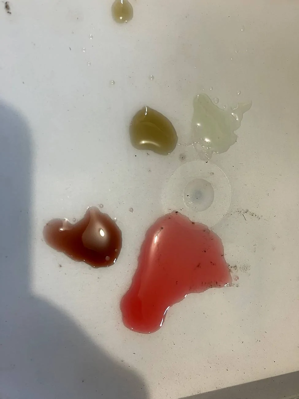

I’ve posted this on another thread in the past but seems fitting here too. I tow/haul more than the average Maverick owner I’d say. Changed PTU and trans at 28k. Took almost half a quart of 75W85 for the PTU and almost 5 quarts of trans fluid. Comparison picture of the new and old fluids. Top is PTU. Bottom is trans.
Ford Maverick PTU oil change at 5800 miles img_5696-jpeg
