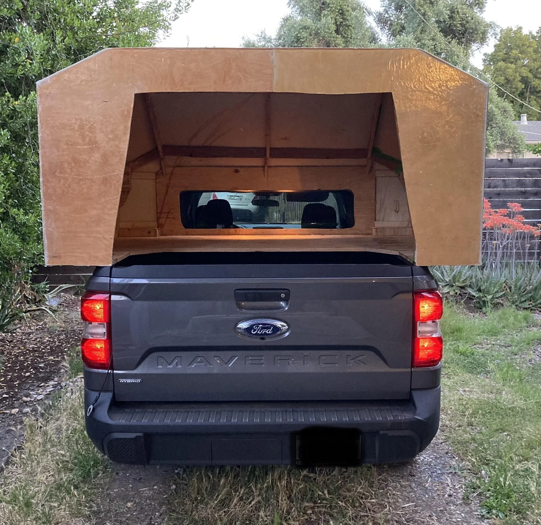

Yep its 75" wide, I'm 5' 10" and used the interior dimensions of my old ranger as a guide. As part of the structure I have a 35" sleeping platform which can extend to 54." On my little 30 mi test drive I drove above 65mph and also did some solid elevation on curvy roads and received 40mpg. I estimate I lose 1-4mpg with the camper but haven't fully tested. While its obviously not super aerodynamic it doesn't alter the slipstream much and weighs about as much as a passanger. Ill take some interior photos once I finish it out a bit.

Perfect! Thanks for the pics. That is how I would have set it up. With foamie methods, the use of wood except for some interior tie-downs could be eliminated. And a few pounds less weight. Could you take a low pic of bed supports if any used ( I think I will not need one) and how you solved the rain blocking flow issue with the triangle like plastic trim attachment from cab/back window/ and top of side rails. That causes me most headache’s in design.
I didn't really solve the the rain channel between the rear of the cab and the front window, I did contemplate constructing a prow or widows peak out of the XPS foam and decided against it to keep the design simple. It will be sealed and I did read that those that bought the leer camper didn't have water issues. I did create a 2 inch step to go over the plastic side rails so the camper is angled from the cab and the base of the camper is a right angle. I can take a photo of that. The bottom is treated with bedliner. There is no bed supports because I integrated the bed platform into the design for strength so its 3/4 ply and accounts for a majority of the weight. The frame is 3/4 ply skeleton and skinned in 1/4 birch. You can see the front tie downs - truck clamp and a tie down strap. I looked to the nomadica moonlander for geometry and Jay Nelson for inspiration.

Yep, I figure 3/4 just laid across as you did would work. I did have the same or similar design idea that you used for the same reasons on the back against the rear window, but I decided to just box around the triangle and make it appear to have about 3 inches of more internal space. And using foams ez cutting to overlap with minimal gap across the top and sides of truckcab then fill that gap with a handlebar like mustache shape seal. There by keeping the rain from falling between window and truckbed. Reduced the problem that way. Gave away my foam during Covid-19 when asked by a friend since they don’t stock pink foam anymore in this region ( special order doesn’t even work )

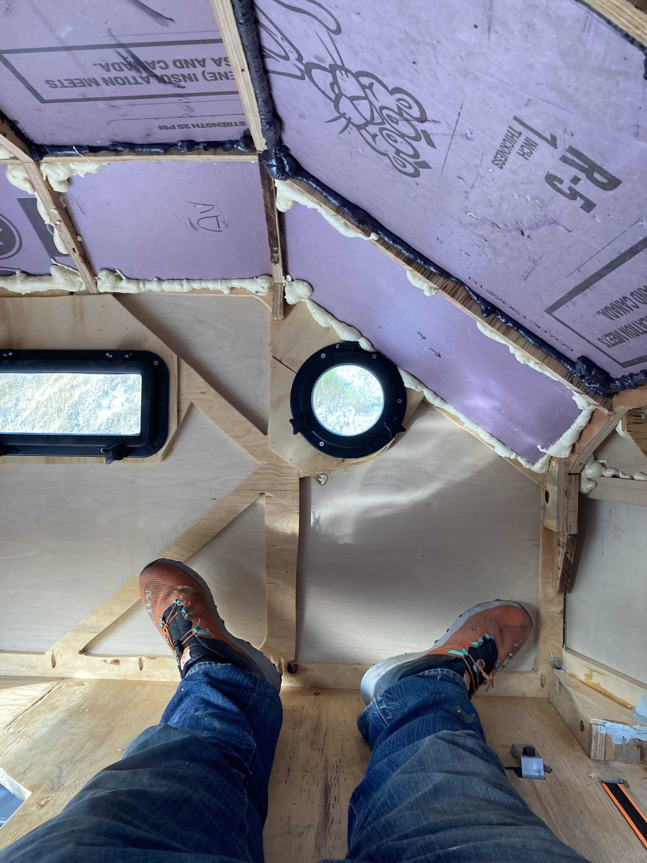

Here are some photos where you can clearly see the overhang and the very unfinished interior.
Wow that's really awesome!!! I cant wait to see how you deck out the inside. I work with a lot of lightweight composite stuff in the aircraft industry. We have a floorboard composite called Gill Floor. Its balsa wood, with fiberglass laminated on both sides. About 1/2" thick it would make perfect exterior wall and roof panels for a light weight removable camper. It comes in 4x8 sheets like plywood, and can be cut, sanded fiberglassed and glued. Being it's a structural panel it can be used as the frame and the skin, and you would need only minimum framework to support it. I think if it was made longer like a slide in so with the tailgate down you had a back door on the camper, it might be a little more roomy, add about 2' to the length. The execution is great so far. I love the window placement too. Are those boat windows?
