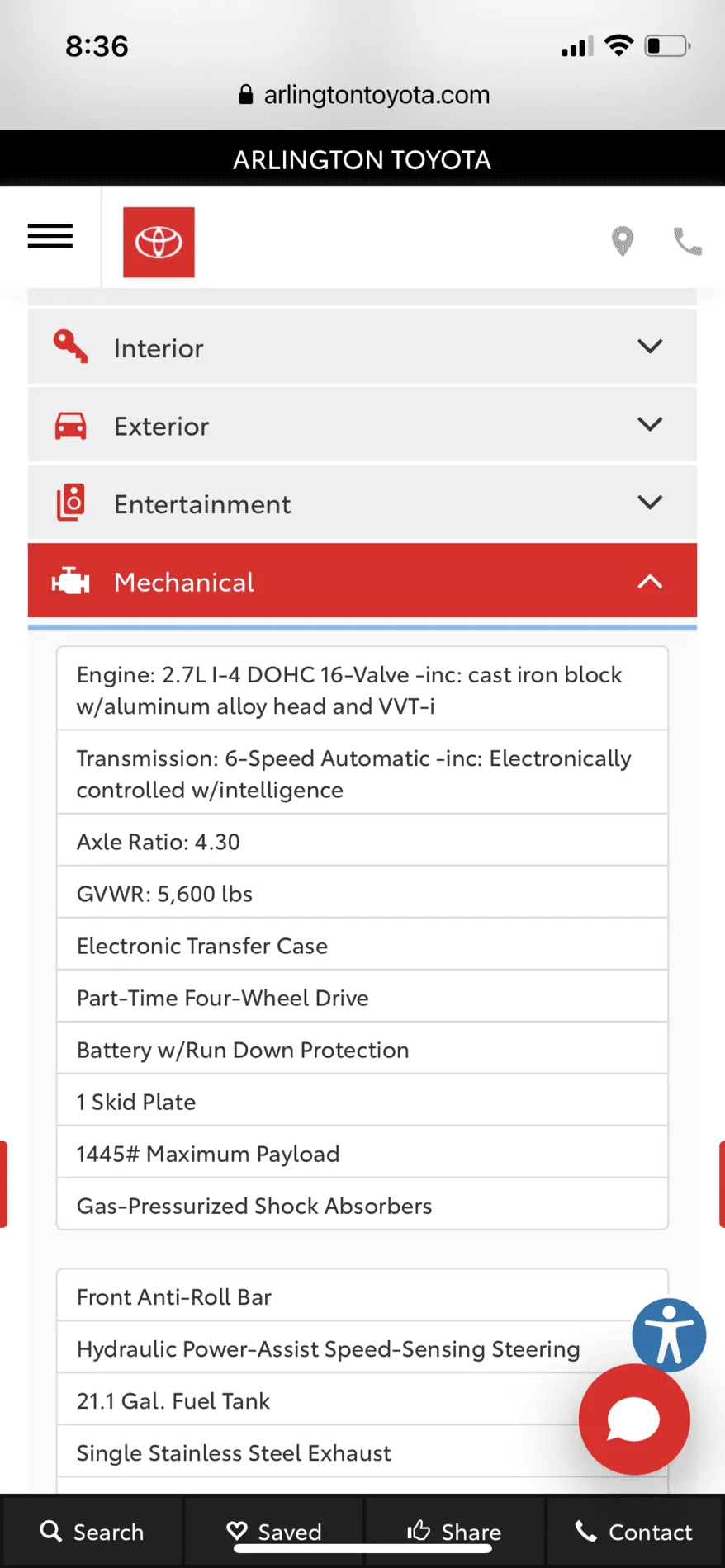

“That's not usually how people refer to them. A 4WD vehicle may require you to shift the transfer case, but nobody calls that part time.”
Um…. Toyota
