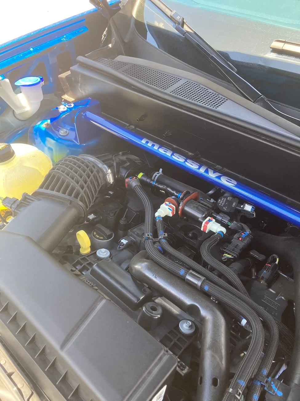

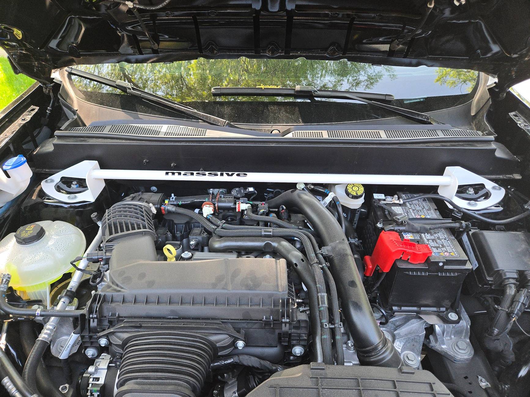

Just got it on so not much feedback yet. I'm putting a couple hundred miles on it next week. I'll report back then.
The install was super easy. Maybe took 10 minutes. Purchased through Panda Motorsports. I think it looks good!

Installed mine yesterday & took a spin up the local canyon road. Maverick felt like it was on rails:)

Those front strut braces don't really do anything, handling-wise. They're for looks
It depends on the vehicle. In years past the strut towers used to be between the firewall and wheel well and would flex like crazy so a front strut bar provided a noticeable difference.
With most modern cars the manufacturers have tucked the strut towers right against the firewall and side of the truck providing excellent triangulation from the factory. I agree with you on the Maverick the rear bar would most likely provide a bigger difference.

I feel less understeer. Granted, I don’t have enough miles (before & after) to completely rule out a placebo effect.
My placebo sense also indicates a CAD/CAM simulation of flex on the Maverick’s Unibody before & after strut brace would show less flex.
