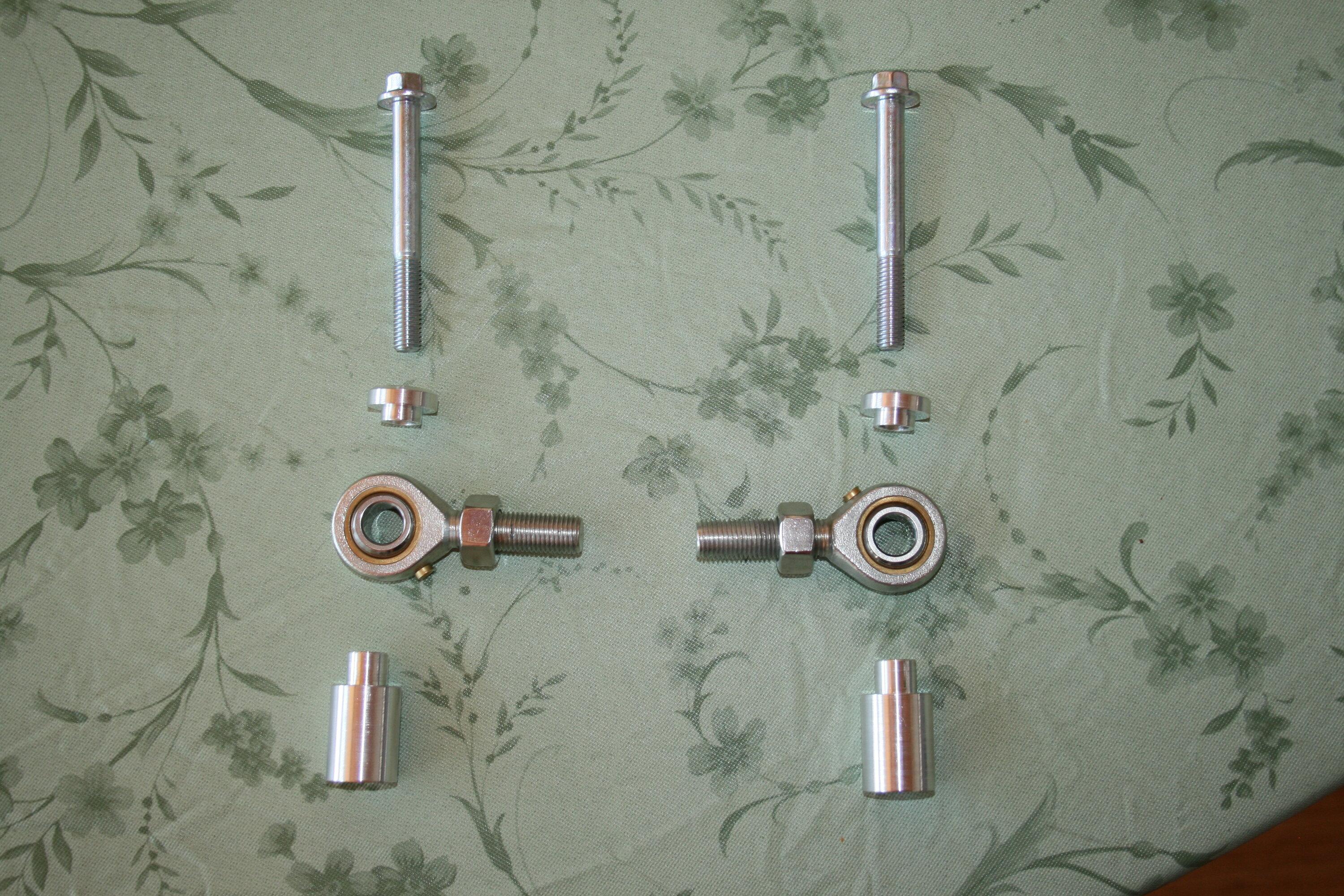

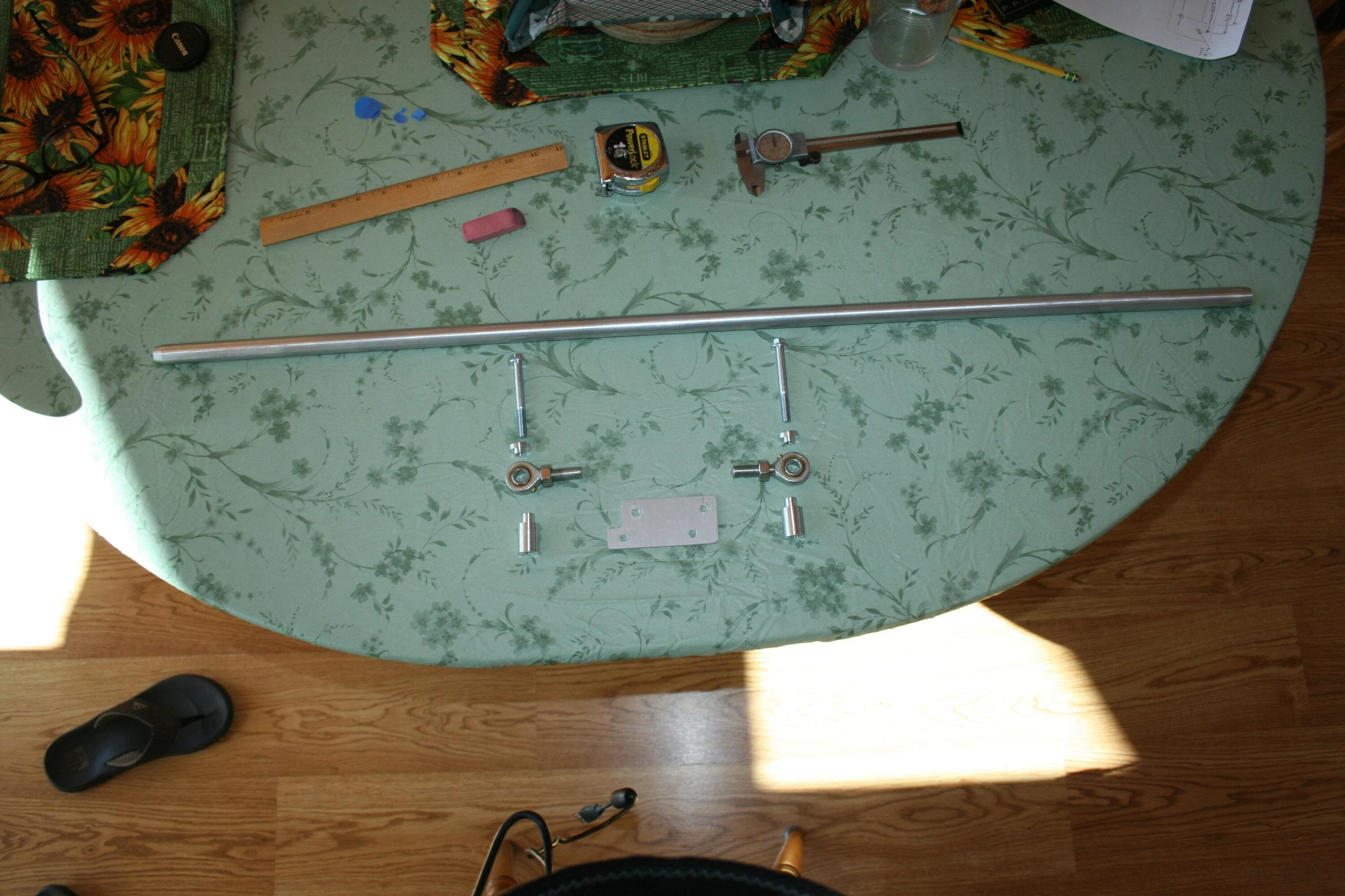

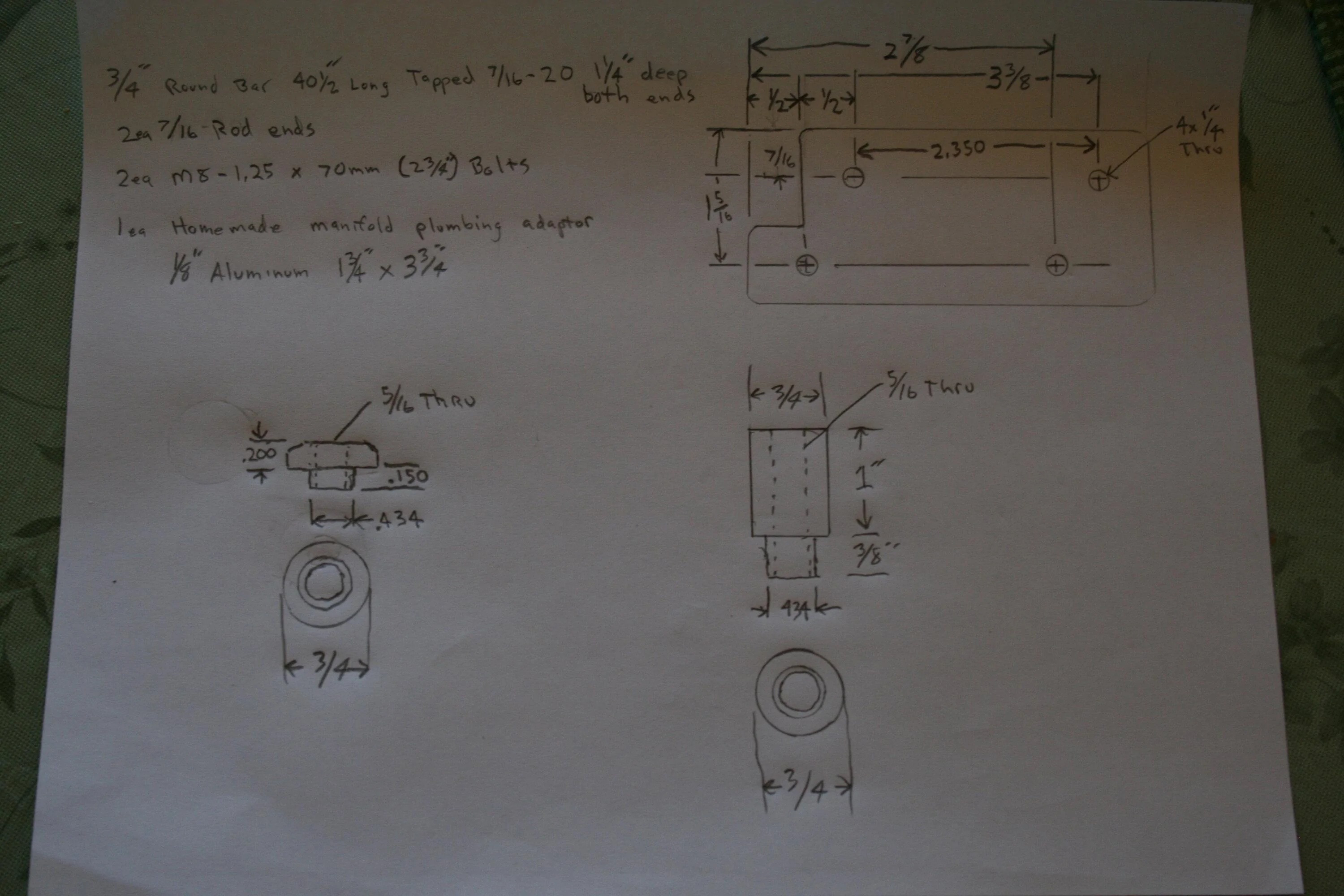

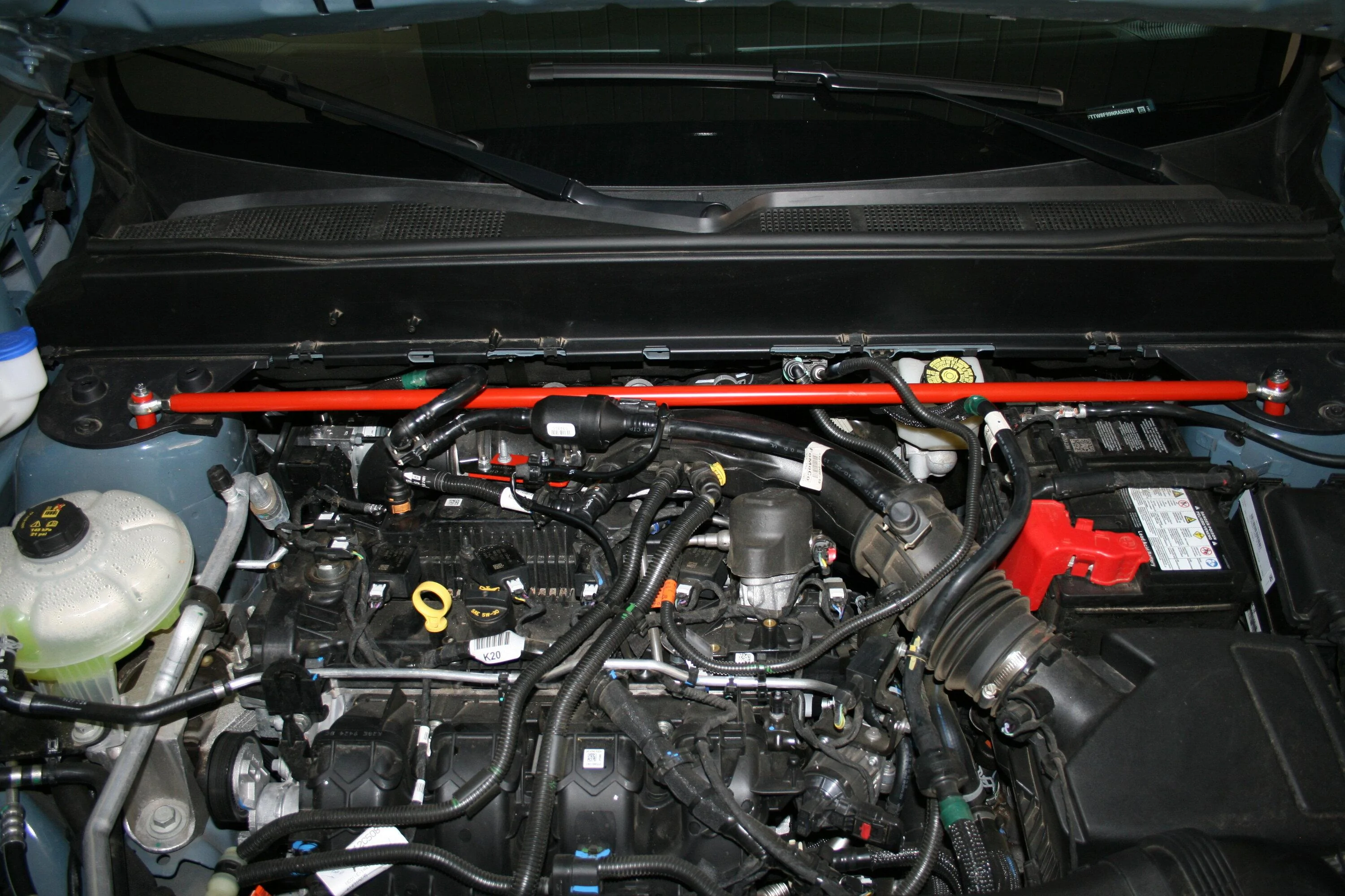

Nothing sucks more than going to a meet opening your hook, and having the same crap everyone else has. And although technically, Steeda makes a strut tower brace for the 2022 Ford Maverick, I opted to build my own! I say technically because the Steeda part was not designed for the Maverick but rather the Escape just so happens that it also fits the Brocon Sport and the Maverick. Several people have complained about it pressing hard on the return fuel line at the firewall! I made corrections for that, and at the end of the day, no regret, well may be one! I should have outsourced a can of Ford Oxford white paint instead of Krylon…
