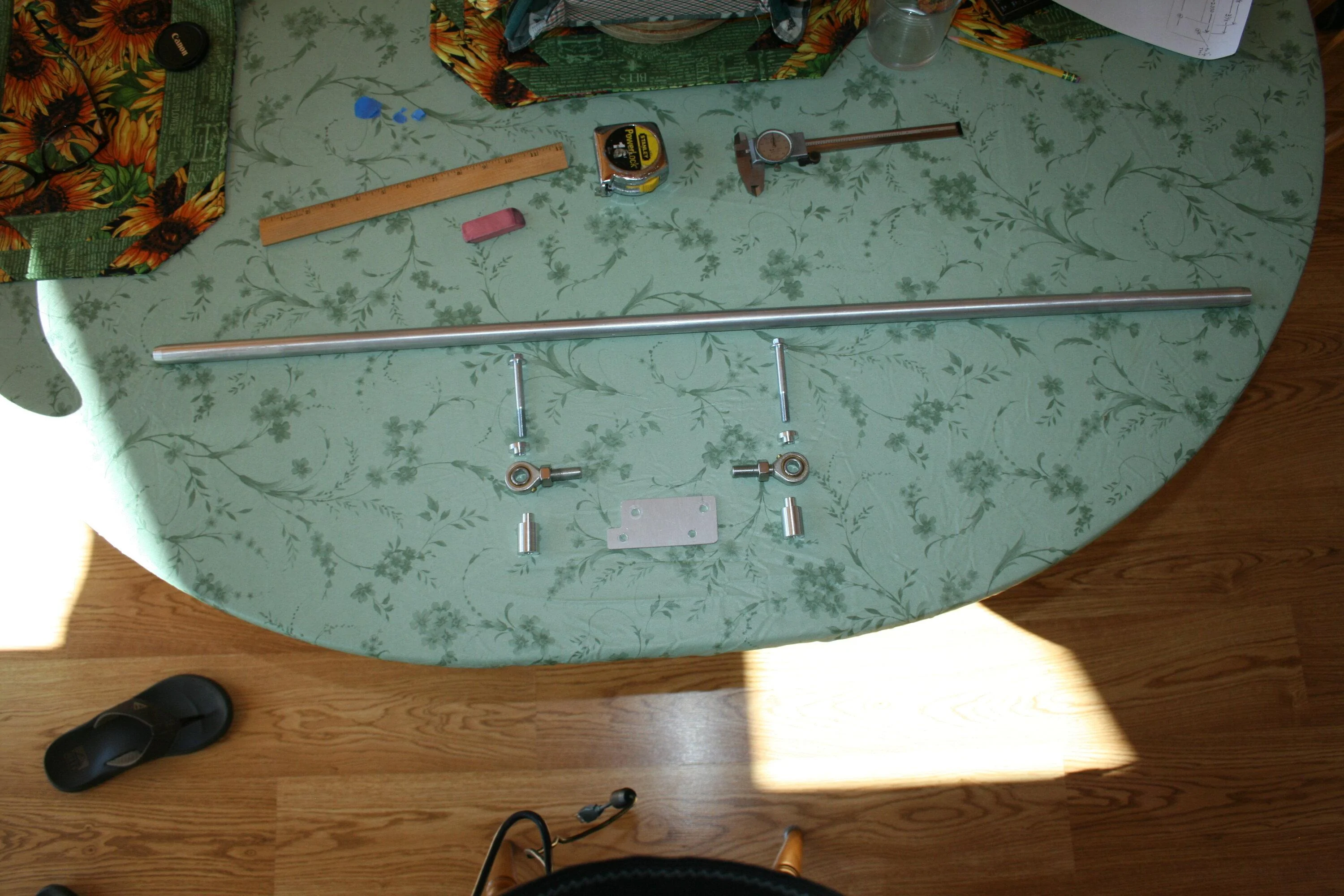

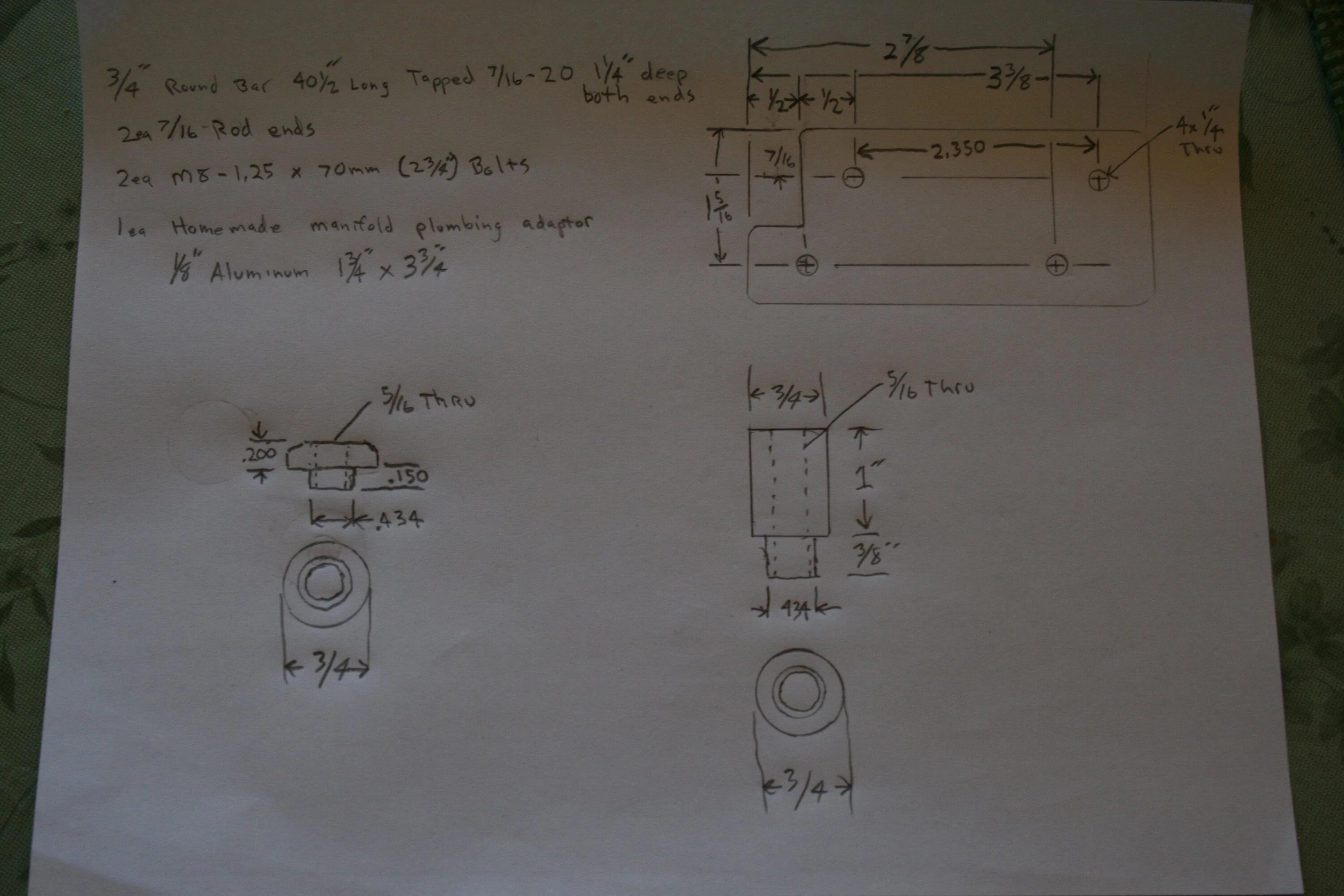

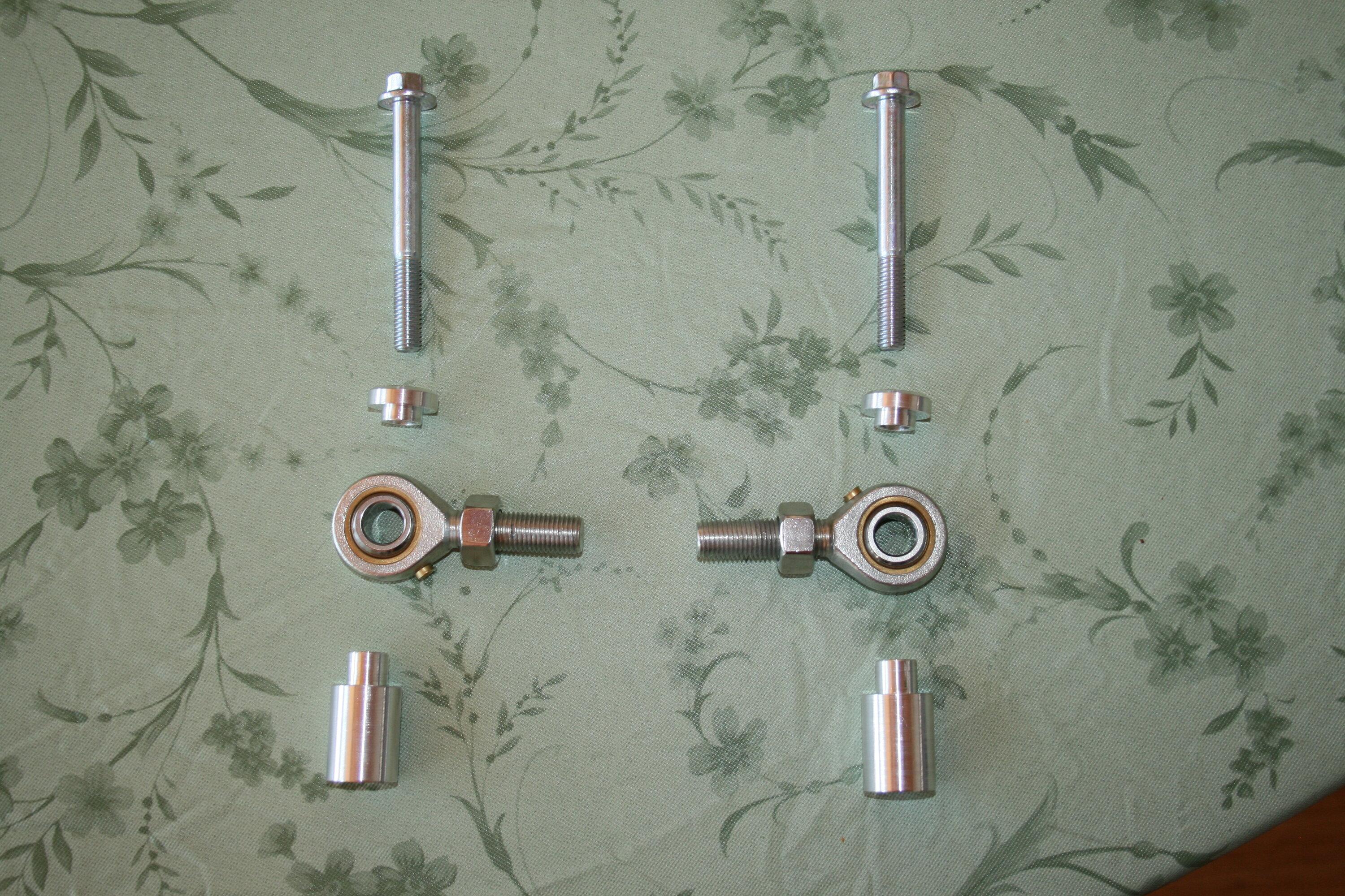

Hi, The Mercury 2.0 engine cover.
Ford Maverick Engine cover & DIY strut tower brace 2022 Maverick 2.0 engine cover.JPG
3/4" aluminum. I hope these pictures help. You have to make a bracket also
Ford Maverick Engine cover & DIY strut tower brace img_3058-
Ford Maverick Engine cover & DIY strut tower brace img_3060-
Ford Maverick Engine cover & DIY strut tower brace img_3061-

What did you make the strut bar with? Would love to make one!

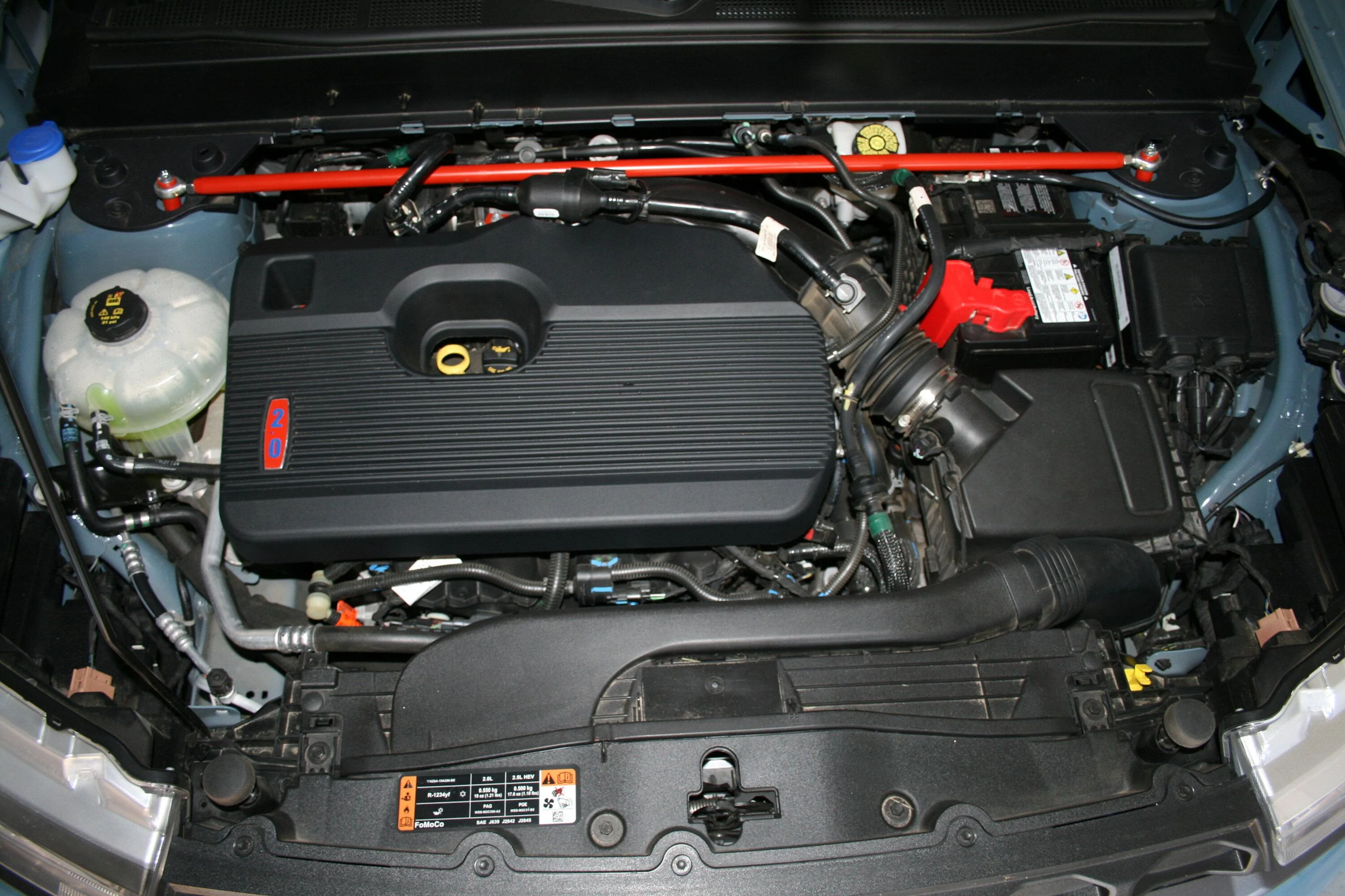

Just curious, how did you measure chassis torsional stiffness on a Mav? Thanks.
Me B
Me B
Jul 14, 2022
64
home
2022 Maverick, 2006 Fusion, 2001 Ranger, Ford F53
I didn't. What I do know is that pulling or pushing the rod front to back 1/4" causes the strut tower near the top to move inboard .0015. I don't know if thats per side as I can't set up 2 dial indicators at once. I don't have anyway to move the tower without the rod attached.

If you dont mind. How much did the materials cost to build the strut bar? The Steeda is only $125. Do you feel it was worth diy?
Me B
Me B
Jul 14, 2022
64
home
The materials were $77. I made the bar for fun but I also have a lathe. Yes it was worth it. The strut bar, Steeda rear sway bar, and Timbren rear springs with a 1/4" preload. The Mav really corners. 35mph corners @ 70, yahoo!

Mercury 2.0. I made the badge from 1/8 aluminum. The screw to hold it down was from leftover TV wall mount screws with a spacer I made to put under it.. The 2 ball mounts that were on the engine fit perfect. Thats all ya need tp hold it on. I got my cover on ebay from a Ford dealership

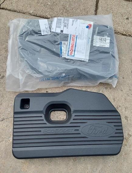

K2GZ-6A949-A for the Ford logo cover
K2GZ-6A949-B for the Lincoln logo cover
As far as I know, the Ford Ecoboost cover is no longer available. (It was also sold for the Ford Escape 2019 2020 2021.) That’s the one you’d want to put on the Maverick to be “original.”

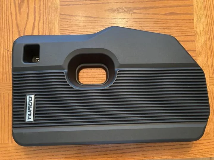

We put a Lincoln one on, but replaced the Lincoln logo badge with a “Turbo” badge I found on Amazon that is exactly the right size.
https://www.amazon.com/gp/product/B00PGJDZCU/ref=ppx_yo_dt_b_search_asin_title?ie=UTF8&psc=1
I’d still like to find an EcoBoost cover …
Ford Maverick Engine cover & DIY strut tower brace IMG_2645
K2GZ-6A949-B. The Lincoln cover, with Lincoln logo badge removed and replaced by a Turbo badge found on Amazon.

K2GZ-6A949-A — With the Ford logo and EcoBoost embossed.

Looks like its available here!
2019-2023 Ford Engine Cover K2GZ-6A949-A | TascaParts.com
