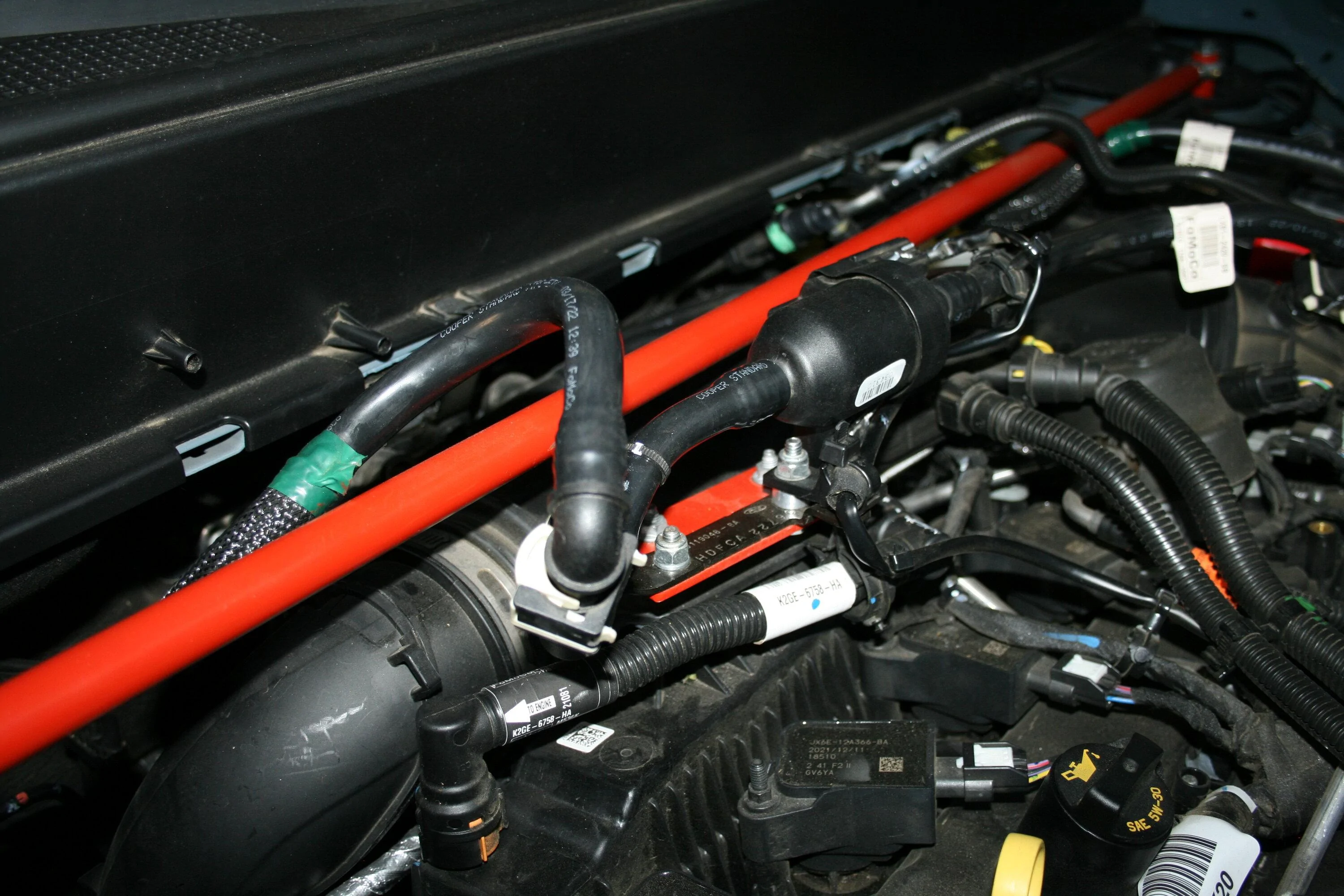

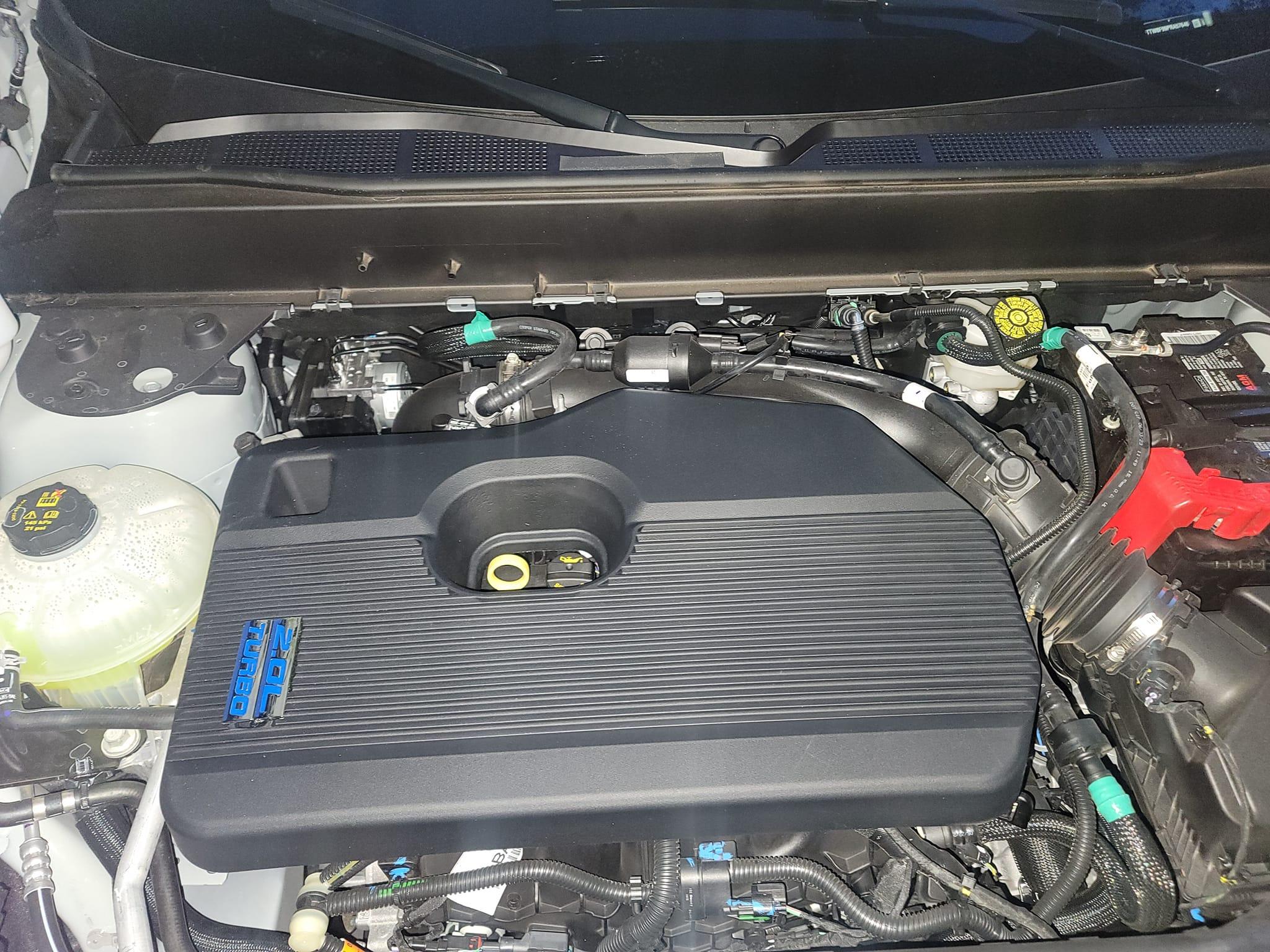

I enjoy creating and fabricating.
.065 SS Brushed SS tubing
LH and RH lathed ends 316SS
55MM M8 Bolts
LH & RH Aluminum Hiems
1" Diameter Aluminum Spacers (1" spacer tall between bottom of Hiem overall 1 3/8 with step)
Mike and I must have similar visions.
Some pictures of my Mavi
I also purchased a non-hitch filler plate from Ford and modified to fit, much cleaner.
H&R super sport springs and Steeda Sway, Handles great.

Nice work, where are you using the flat plate that you laid out and made.
I don't appear to have any clearance issues.

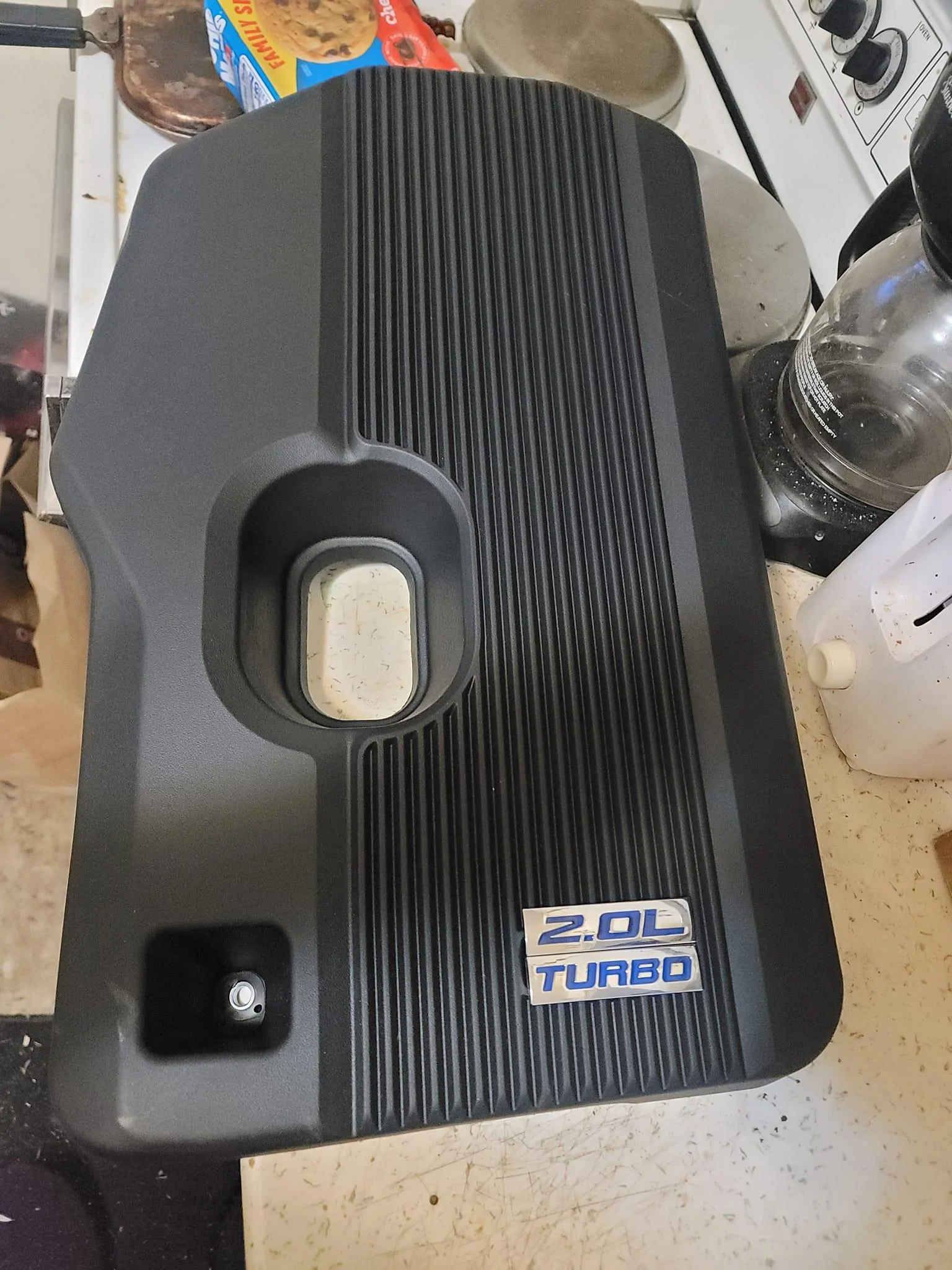

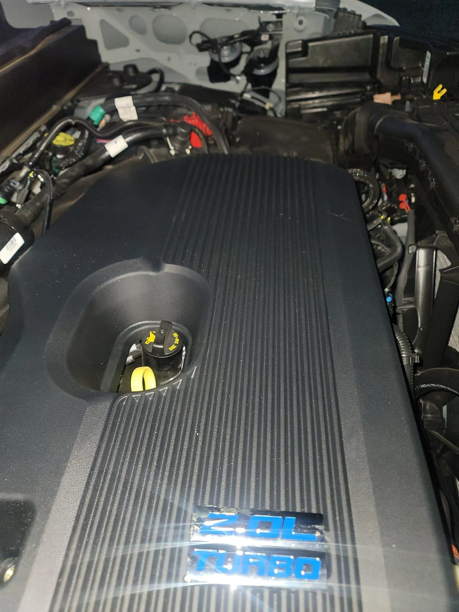

Tried something different used 2 emblems. I had to build up the cavity with 3 pieces of 3M tape that got the emblems level I added some trim adhesive just for good measure.

Hi Max, With the strut bar installed the round black thingy and the flex hose would rattle against the strut bar pulling my 19' Lance travel trailer. I had to also trim the engine cover around the black thingy. Your 2.0 badge is nice!
