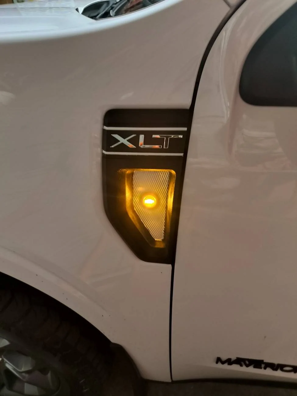

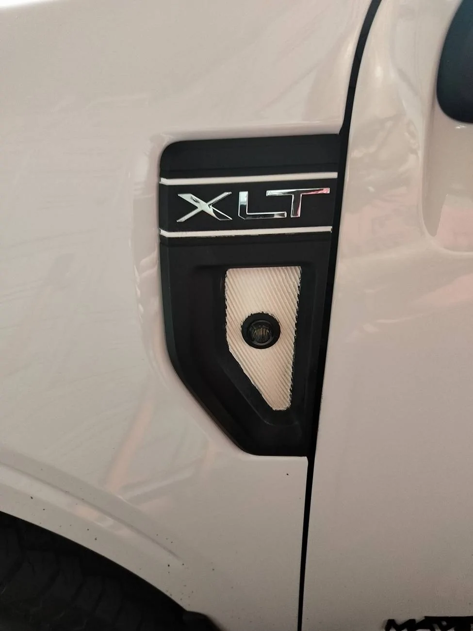

Hi - I attached some photos. I did a complete write up in the thread related to side marker lights. Key points:
-No need to remove the emblem to drill the 3/4" hole. Use a sharp paddle bit.
-Test the LED's using a 9v. batter as you go to detect any wiring/connection issues.
-The lens is made by gadcad3D. He is an etsy seller.
-Wait to drill the hole until you have the lens because you must make a templete to locate the hole using the indent in the back side of the lens.
-I used 3M 1/4" auto grade emblem tape to secure the lenses. I cut the tape at my workbench using a sharp razor and made corners abut. So far, no moisture issues.
-Use auto grade fabric electrical tape, NOT the shiney stuff.
-It takes about 15' total of 3 wire 24 guage stranded wire cable to do both sides. No need for heavy wire.

Did mine the same way, but did drill a small hole in bottom of the amber cover “just in case“ it did get water in it.

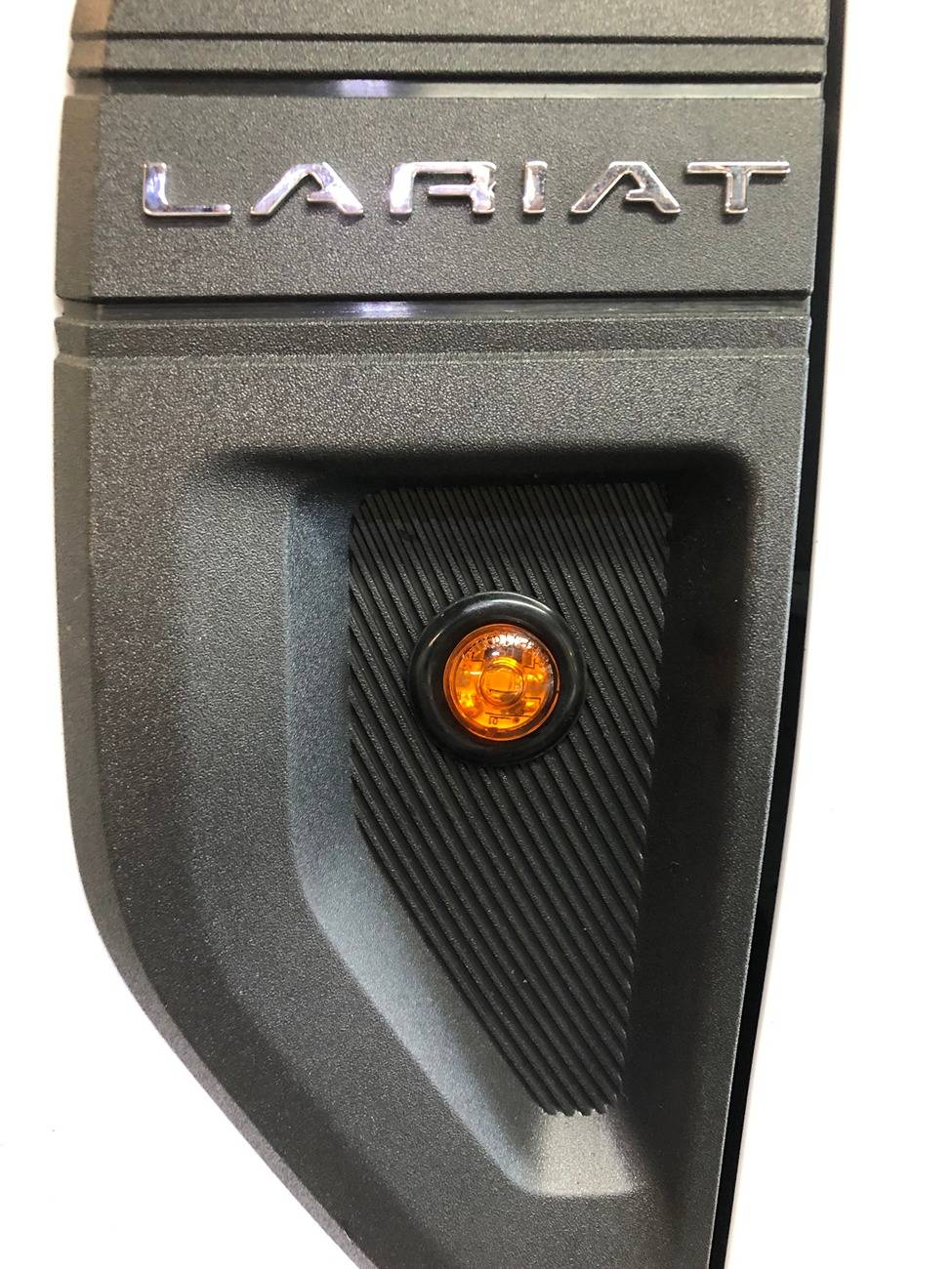

Hello, If you like them and want to make your own I have some of those round amber lights left and would ship you a set free to install. It's very easy. Just a hot and ground. Just give me your address and I will send them to you.

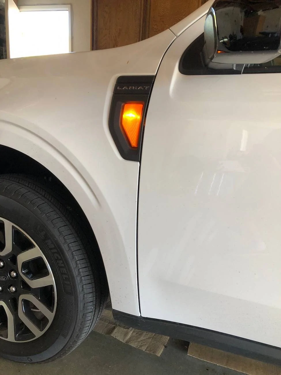

Here you go. I bought some Amber lights from Amazon and tied them into the turn signal so they will flash .
Did you drill a hole in the clear 3d lens also? Thanks
