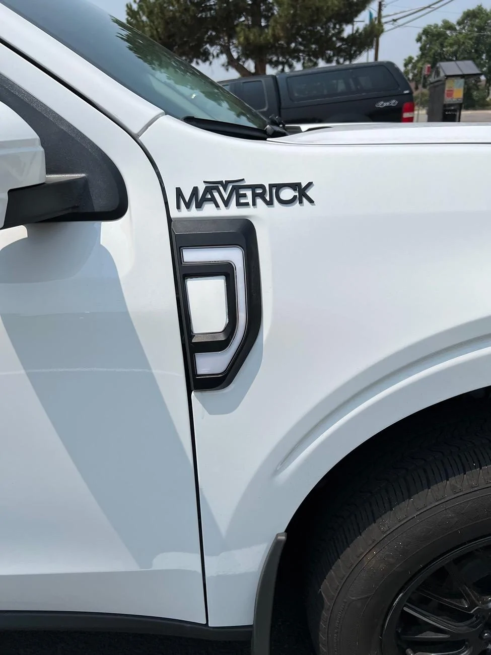

I gave it a shot and attached the yellow wire to the small blue wire. I now have lights on the passenger side.
since I have some white paint, blue painters tape and some newspaper, I took care of those black stripes.

Looks great, especially with the old style Maverick badge. I've still got the original metal one from my dad's '73 Maverick but I'm too worried about it getting snatched if I put it on my Mav.. I'll have to look up the replicas online.. Or just get the Longhorns cut out in vinyl and do something with it across the tailgate.
Mabett sides are getting installed as soon as I silicon the edges and screw holes for the other trim pieces on the backsides.

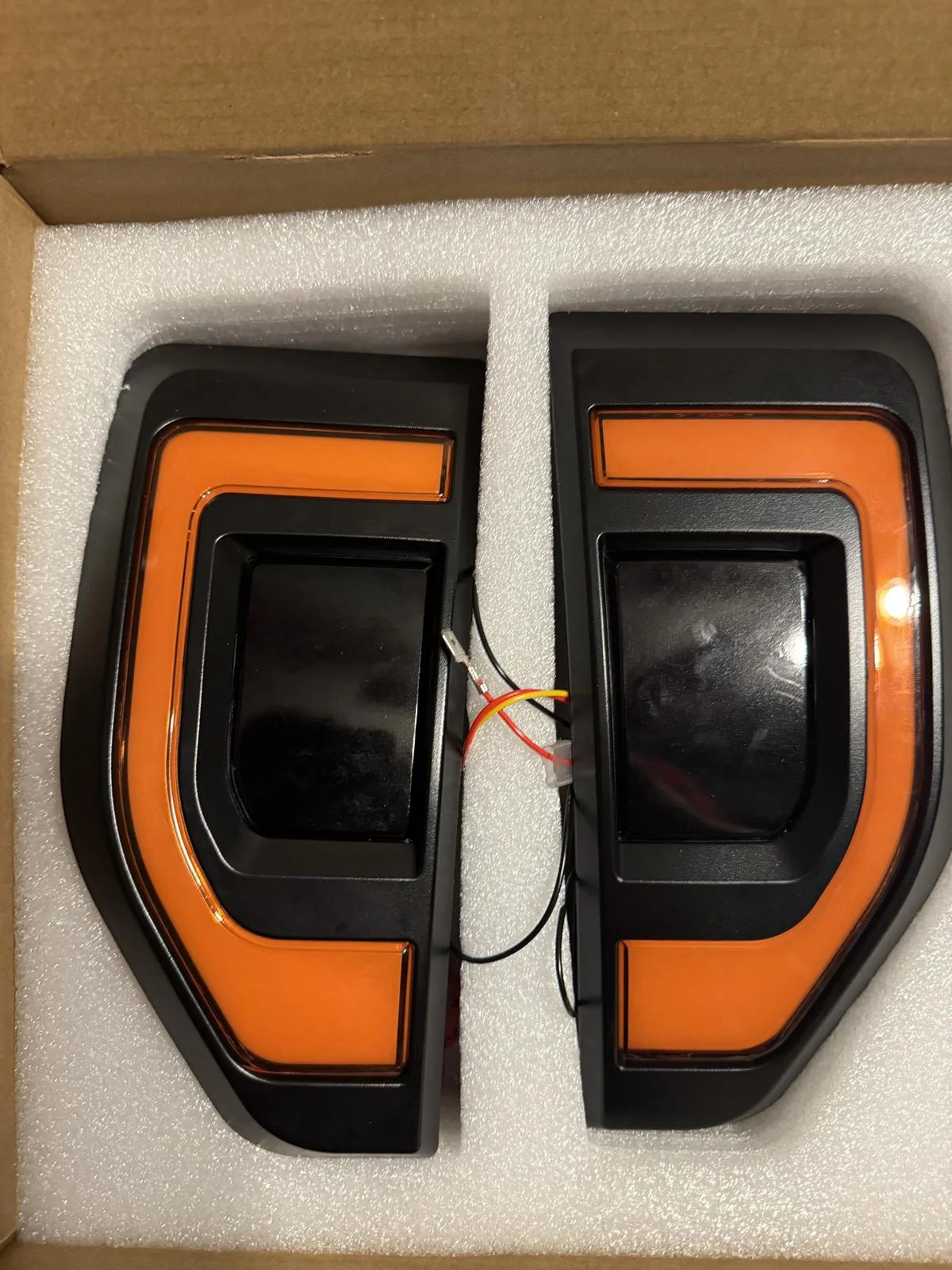

Got mine in and decided to make them match my marker lights a bit better. Did not like how yellow they were.
Hey yeah that looks a lot better with it matching. That is the thing that turned me off on these was the yellow. I may consider doing this now.

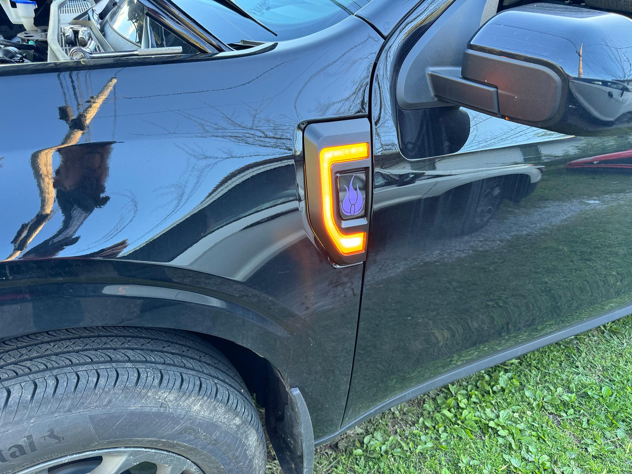

I grabbed some orange transparent vinyl off of amazon and covered them.
Also got some practice laying vinyl by using black vinyl on the center section, good practice for laying around complex curves.
