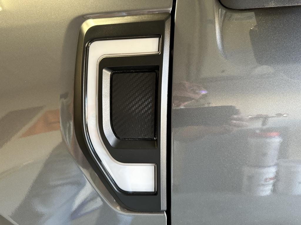

Got mine in and decided to make them match my marker lights a bit better. Did not like how yellow they were.
I like this look. Did you just put the tint film over the lights on the outside? Did you wire the lights to be on at all times while driving, or only for the turn signals?

I took the black plastic cover off and wrapped the outside, and they are wired to be on when driving. If I remember right there are 2 power wires and a ground, it can be wired so they only come on with the blinkers.

Then as for the Carbon Fiber insert, did you just add it to the outside?

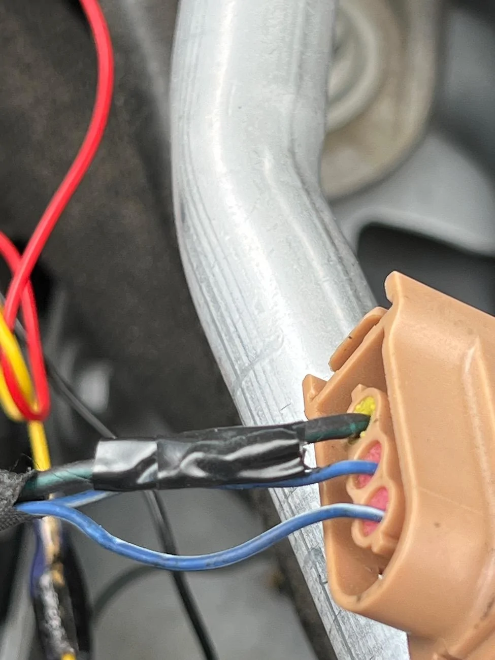

Tie the yellow wires to the smallest wire on your turn signal (each side). Then just tape off the red wire. That is the way I did my 24 hybrid lariat.
I want to try this. But there are two (2) small wires looks like one top , one bottom which do you recommend ? Looks like they are both blue with white strip.
The wiring is different it appears on the Eco vs Lariat. Sorry but I can’t help. Maybe someone who has an Eco can help. Good luck.

Well thanks, hoping somebody will read this and chime in.

I wired mine up so they are always on when the truck is running and blink with the turn signal. I hate the Zebra center and ordered black carbon fiber to cover it it.

How did you wire your driver and driver harnesses to obtain this please?
