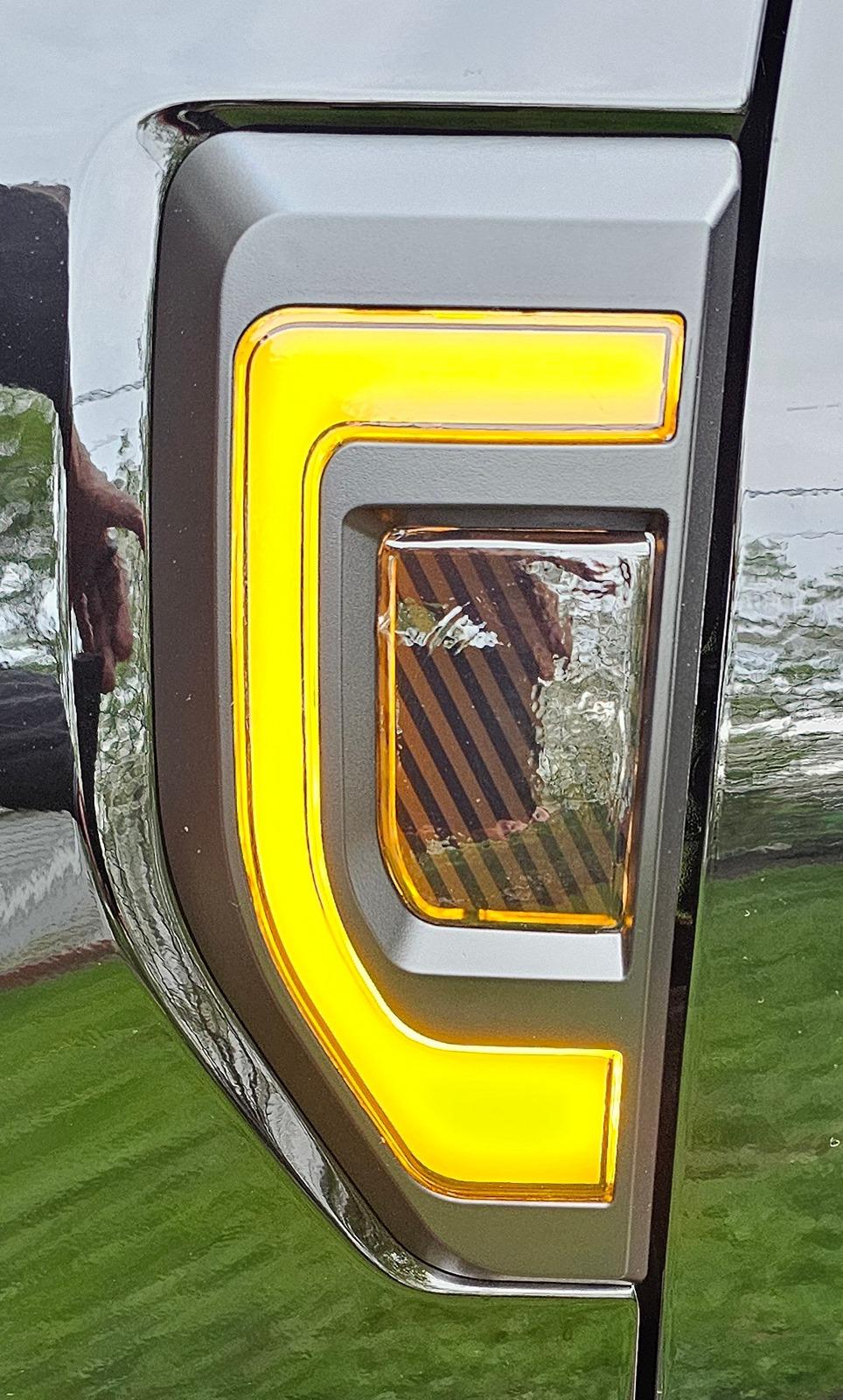

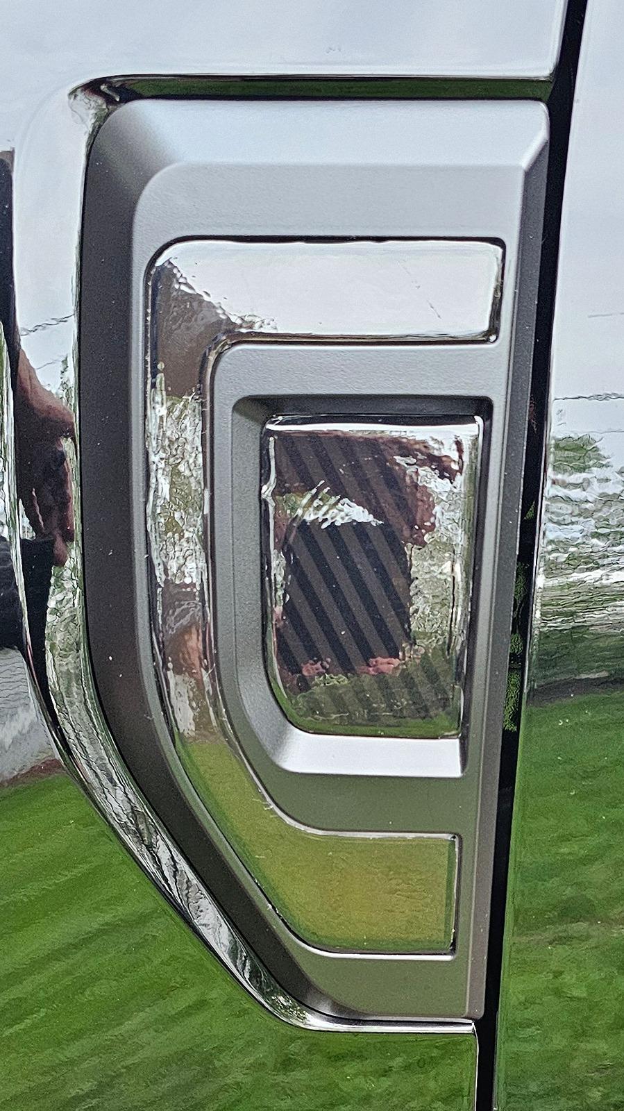

I had the same problem. Once I cut the passenger side Red wire to the Headlight, it no longer stayed on with the car off.
It functions correctly as does the driver's side.
I tinted mine dark grey to keep the BAP intact. The LEDs shine through it easily.

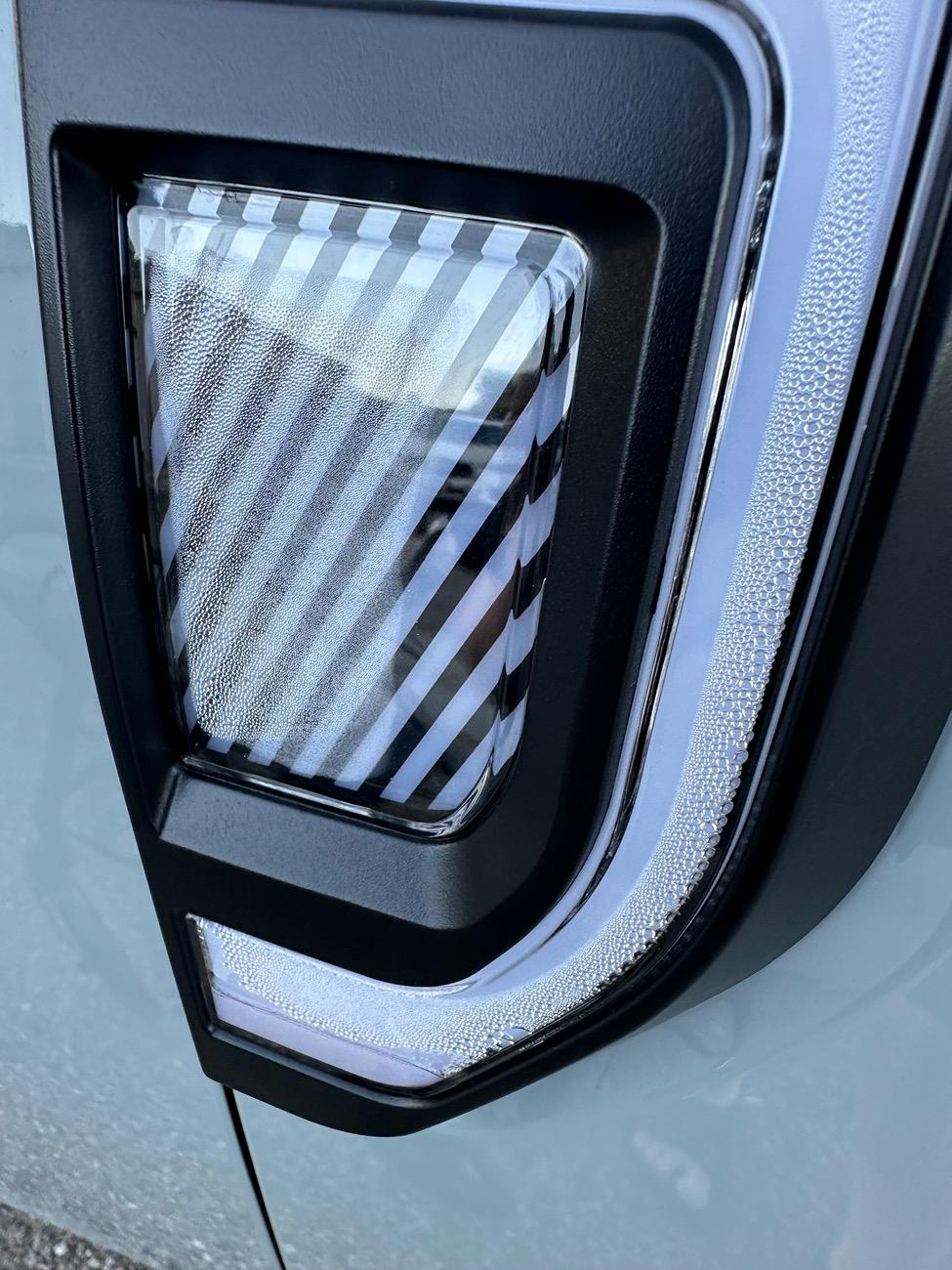

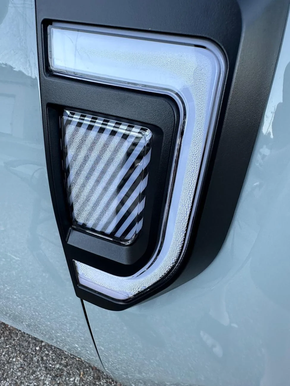

Hello, after I hand washed my 2024 Maverick Hybrid I was drying it when I noticed condensation in the passenger side light. Any fixes out there. Thanks in advance. Dee
Members have been adding fish. Makes good use of the water and looks waaaay cool.
