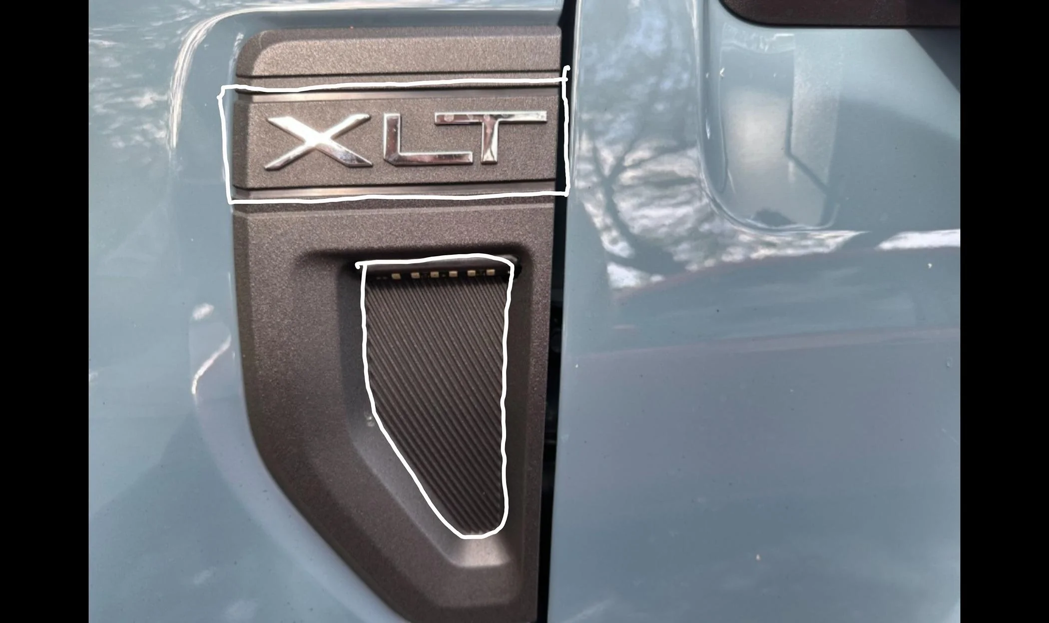

I plan to leave the center indentation black, as well as the XLT strip area. Then ptm the rest.
