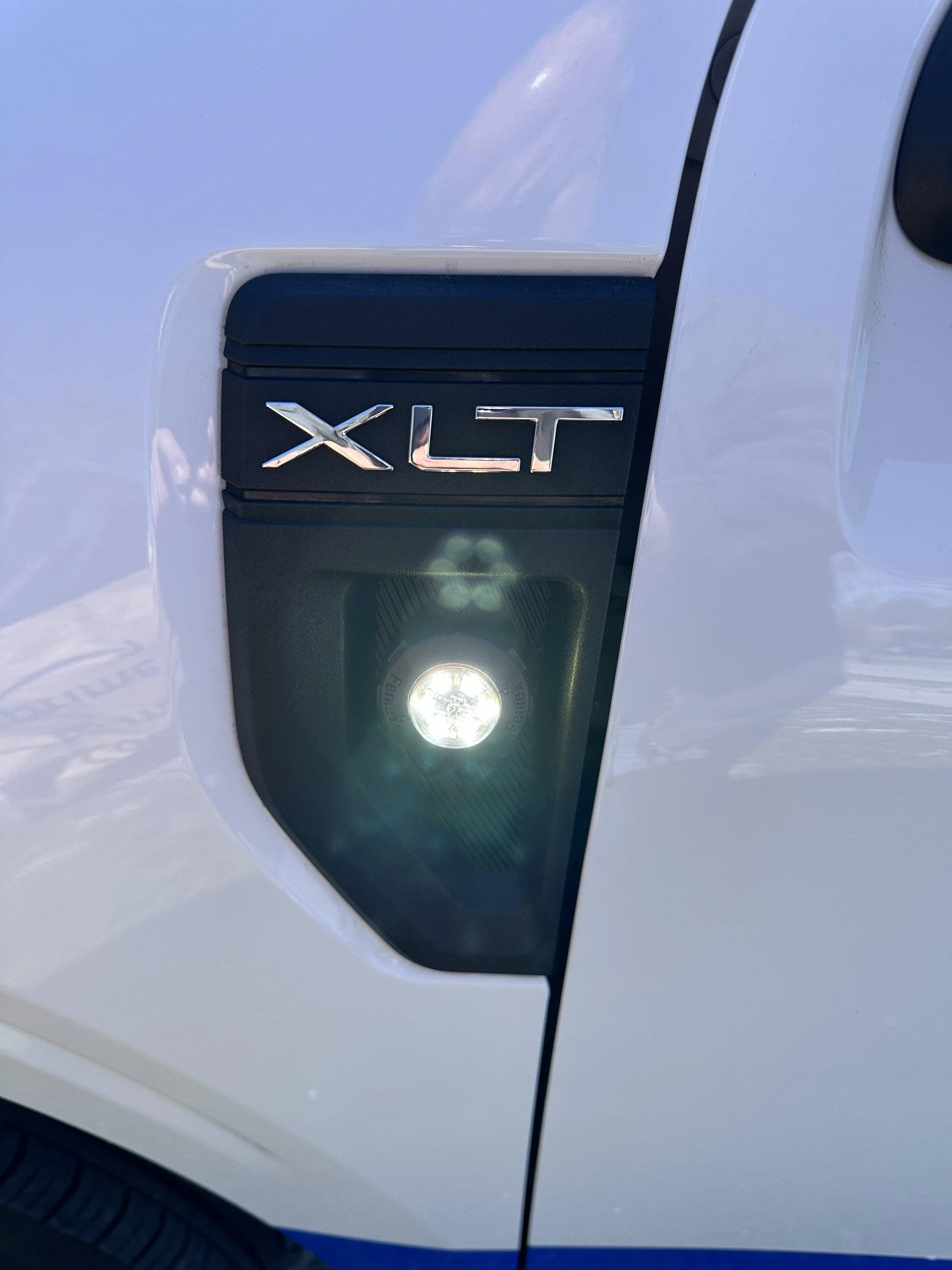

Made my own using feniex quad cannon. They are wired for turn, strobe, white area light
Ford Maverick Mabett side marker lights turn signals IMG_6227
