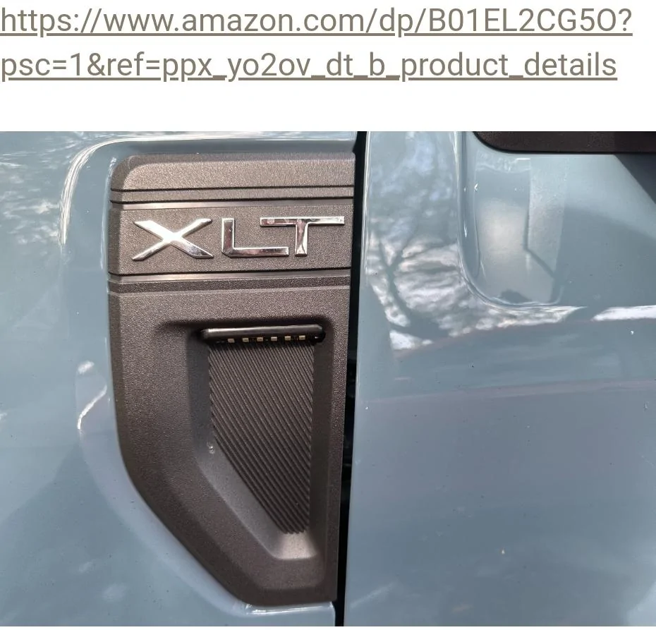

Even though I like the animated lights. I feel that Mabett does not have their act together yet. Cheap pricing poor quality won't cut it for me.
I feel, having either fender or mirror mounted signal markers, is a nice safety feature. I've them as oem on a few of my vehicles. More than likely I will go with the ones pictured below. I have seen video's of these.
They will do the job as intended.
I wish they made them as switchbacks. 👍
Ford Maverick Mabett side marker lights turn signals Screenshot_2024-06-07-08-29-44-65_40deb401b9ffe8e1df2f1cc5ba480b12
Not as fancy. Stay safe.
