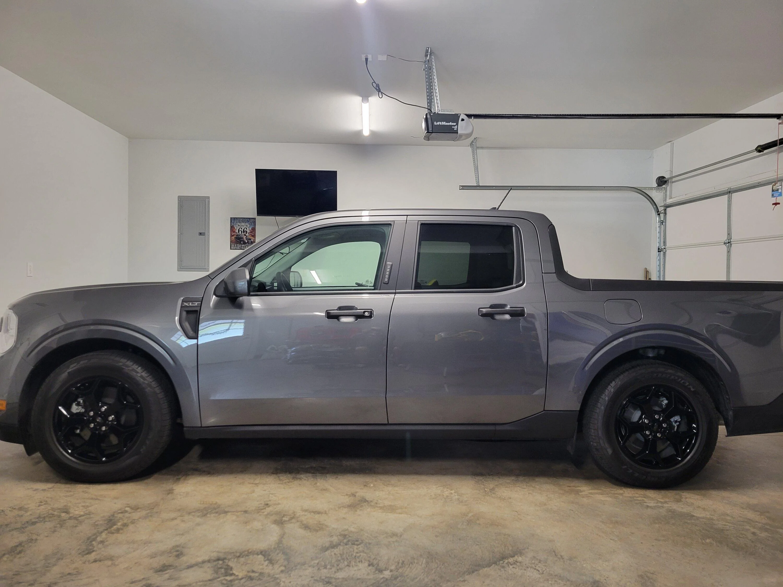

lowered with H&R coil springs

From the picture, it looks like the back wheel is closer to the front wheel arch??
ya had me worried ... went out and checked, its centered.... just the way i took the pic, slight angle

part# 51620-77.... got them through Panda Motor Works.... $399 with free shiping....took my time and spent the weekend.....theres a couple install videos on youtube .... they both had lifts doing the work....i used floor jack and jack stands... kind of sucked but it got the job done. if you go my route , just remember to put those rubber pads on the jack and jack stands. otherwise you'll damage the pinch welds underneath the truck because its unibody and does not have frame rails for support..
Your truck looks great, tire rack now has the springs for $299 (normally $337)

after reading a lot of posts of what type of spring to go with , decided to go with the H&R super sport springs.... 2.2 in front and 3 in rear. took before and after measurements. after installing , lowered the front 2 inches and rear 2 1/4 inches.... have the eco boost with AWD..... double checked and made sure rear springs were settled in there rubber spring perches.... does anyone out there have this issue..... just seems the rear should be a little lower.... taking it in tomorrow for alignment.......
