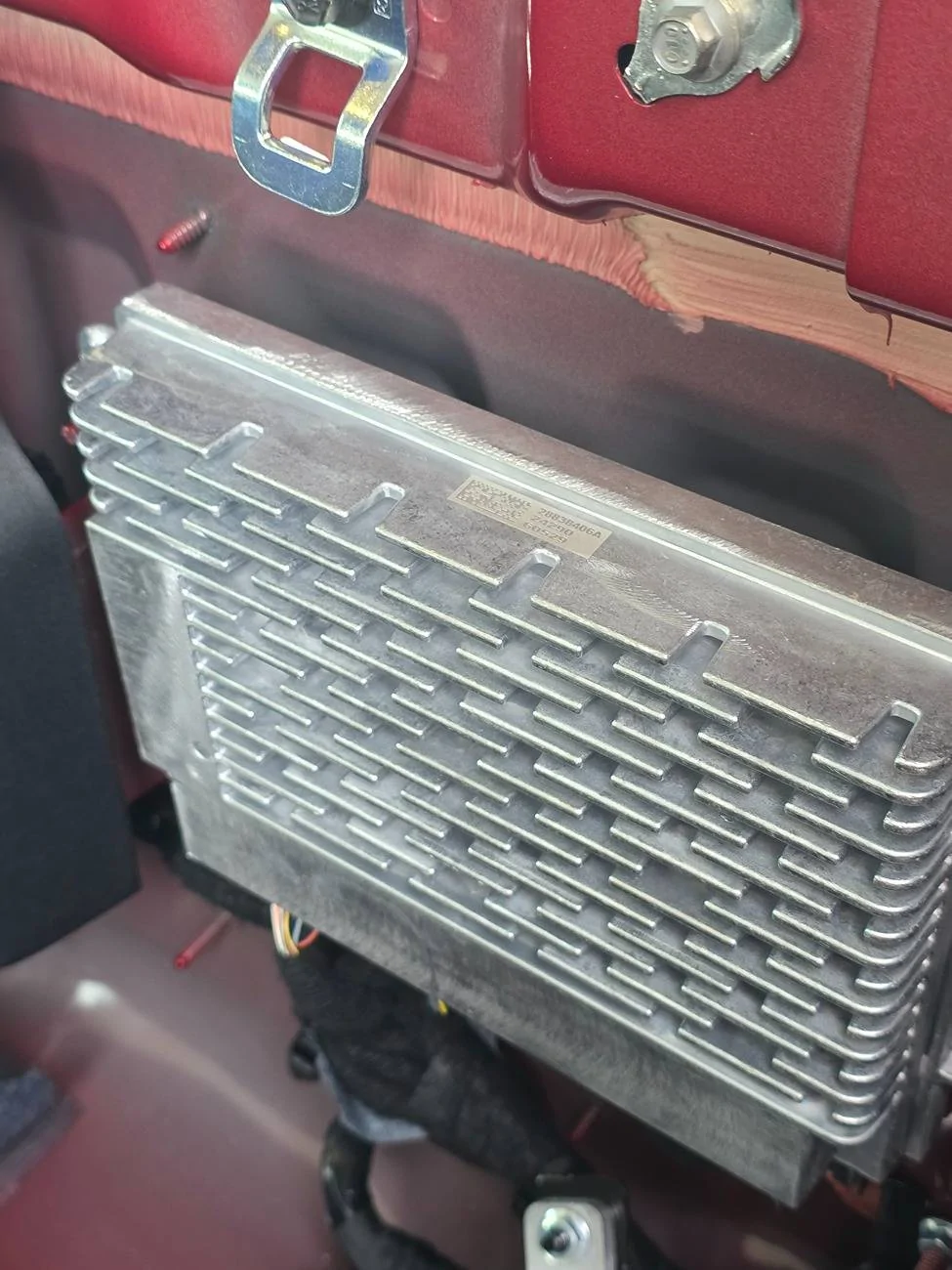

Hi, il have a 2025 maverick hybrid with base audio system, i had look on some thread and it seems that it have no stand alone power amplifier for the audio system. I have found this just behind the rear seat. Is this a sound amplifier ?? Thanks
Yes, if you have the Bose (not base as you typed), this is indeed, your amplifier.
There is no Bose system. The upper trims have "B&O" as in Bang & Olufsen. These systems have "B&O" symbols on the front door speaker grilles.
I dont have the b&o system for sure
That looks too beefy for a basic sound system amp, I get my Maverick later this week and since I'm curious about the sound system too, I'll let you know what I find.

This is the IPMA module for lane keep assist. On the new 2025 Maverick, the system is much larger and is no longer located behind the rearview mirror. It is now a separate module and the camera is fed via a coax line from the windshield.
