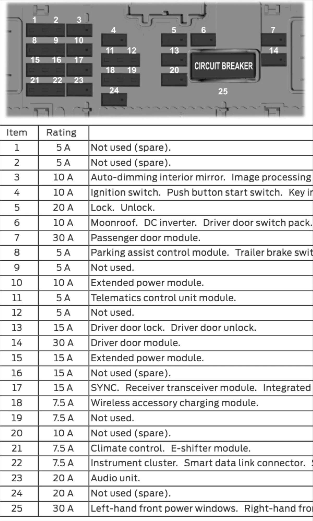

Updating this thread for anyone else who may be dealing with something similar. I bought a audio control lc6i. I installed the lc6i and replaced the junk RCA’s with crutchfield reference 4 channel RCA cables. I also got rid of the signal sense turn on and used a fuse tap on fuse 3 to turn on the amp and lc6i. Took it back to my new installer and he tuned the system and relocated the amp ground to a mounting bolt for the jack behind the back seat. Alt noise is gone and the system sounds great. Big difference from when I initially got it back from the shop. The amp also seems to run cooler than it did before. We’re talking about replacing the alpine type s component set with something better, but for now I’m very pleased with it. Thanks to everyone on this forum for your advice on this, it’s much appreciated!
congrats on the updates and I'm glad it sounds better! probably most the fix was the amp ground like I mentioned way back in my first reply, but everything else helps build a better system.
regarding swapping the alpine s series I would definitely audition replacements before experimenting. is there anything in particular you don't like? have silk dome tweeters so they shouldn't be harsh if your gain and tone controls are set properly. want more control it might actually be time for a dsp.
