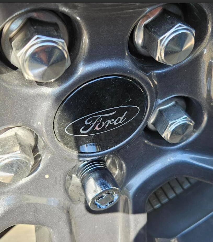

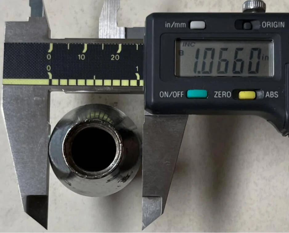

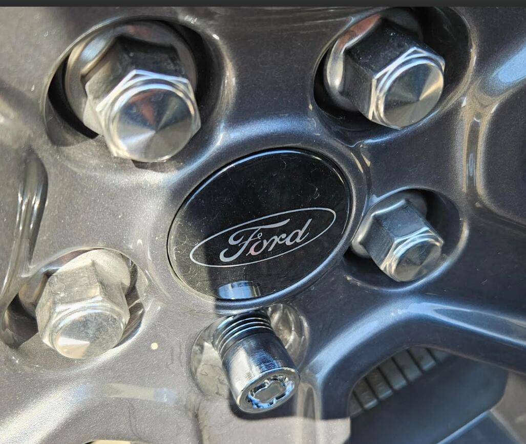

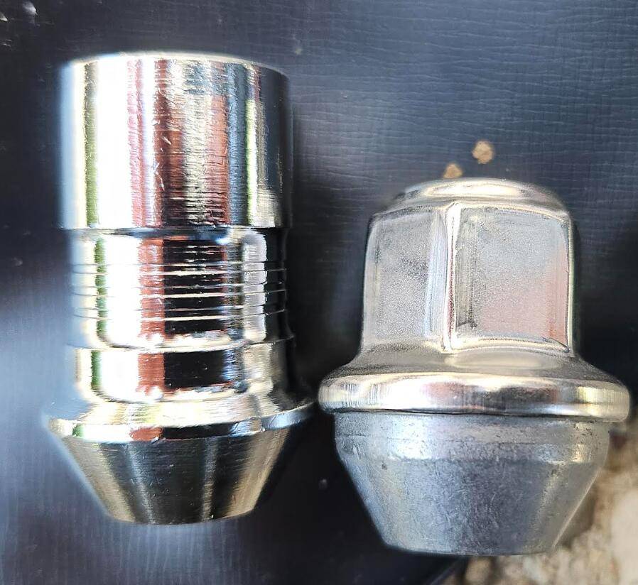

I am having issues finding the correct locking wheel lugs. Ford Genuine GR3Z-1A043-A Wheel Lock, 1 Pack
1: The locking lug (on the left) is much taller. Does that extra height make it easier to steal? (Pair of vise-grips)
2: Notice that the seating taper differs from the OE lug on the right.
3: With the extra size, does that comprise the wheel balance? (Getting steering wheel shake at 45 to 55MPH.)
Does this look correct to you?
Any product recommendations?

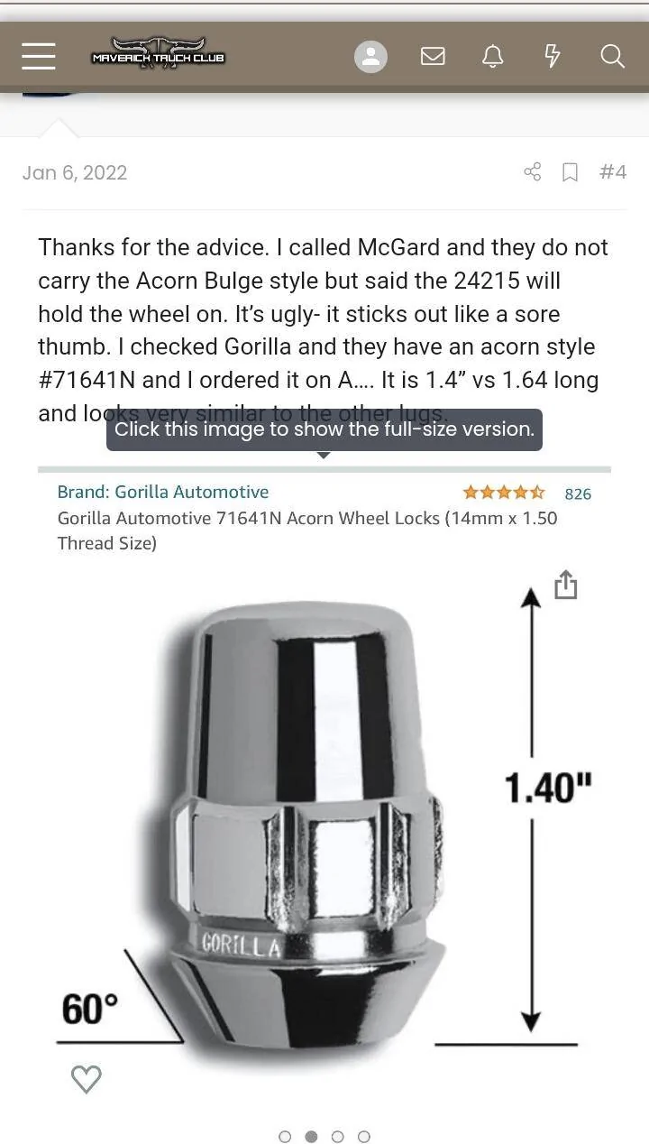

Check gorilla
Per this post...

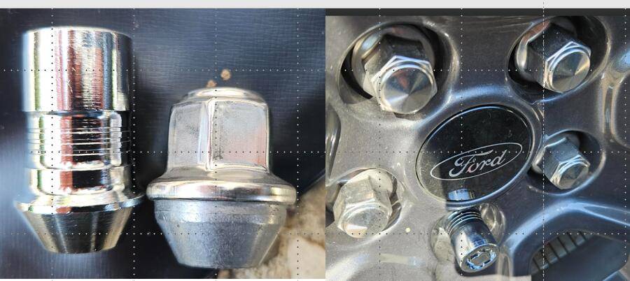

I have the Ford GR3Z-1A043-A, dealer had installed them.
1, 2 Don't know.
3 Haven't noticed any shake.

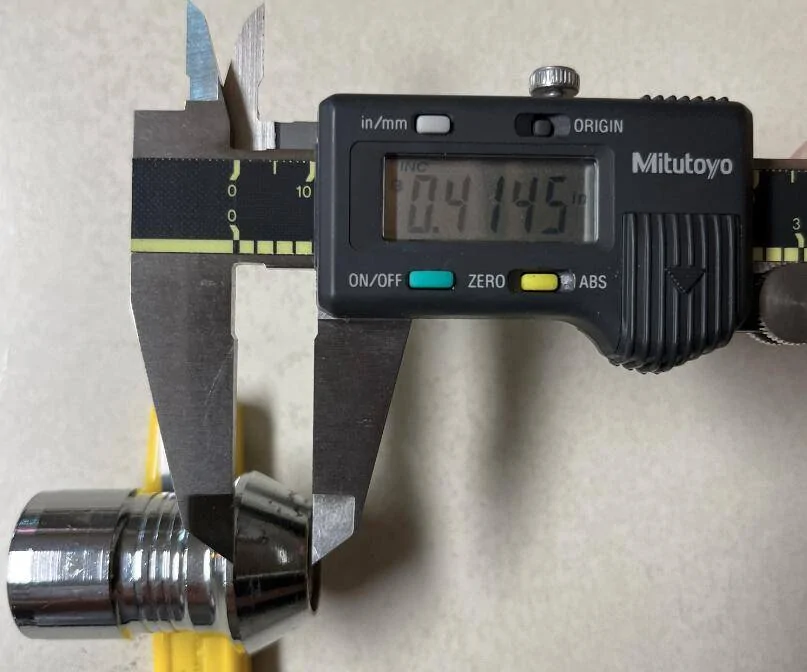

Ford OEM (ACPZ-1012-M) Lug Nut Cone
Ford Maverick Locking Lugs 2024 Ford Maverick XLT 1744669408011-ps Ford Maverick Locking Lugs 2024 Ford Maverick XLT 1744669924215-03
Ford/McGard (GR3Z-1A043-A) Locking Lug Nut Cone
Ford Maverick Locking Lugs 2024 Ford Maverick XLT 1744669482109-7 Ford Maverick Locking Lugs 2024 Ford Maverick XLT 1744669982797-7k
Edit: Gorilla has some factory style bulge locking: 96641DX
https://www.gorilla-auto.com/gorilla-automotive-96641dx
Ford Maverick Locking Lugs 2024 Ford Maverick XLT 1744672786425-8i
Amazon B00YJJ359Q, Gorilla-Automotive-96641DX-Chrome-Factory
"They do fit a Ford Maverick"

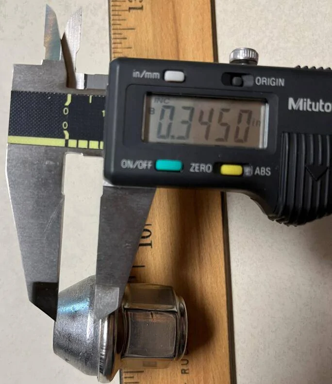

The chrome locking lug nuts in your photo are narrow for aftermarket wheels. I got these locking lug nuts that fit the ford OEM wheels,
Gorilla Automotive 96641BDX Black... https://www.amazon.com/dp/B00YJJ2BY6?ref=ppx_pop_mob_ap_share
And they are too fat for my aftermarket wheels. So now I need narrow black lug nuts and locking nuts for my new summer wheels. No matter what you do, 14mmx1.5.
You have the wrong locks, it's important to ha e the same larger taper or ot will destroy your wheel. I bought correct ones thru ford
