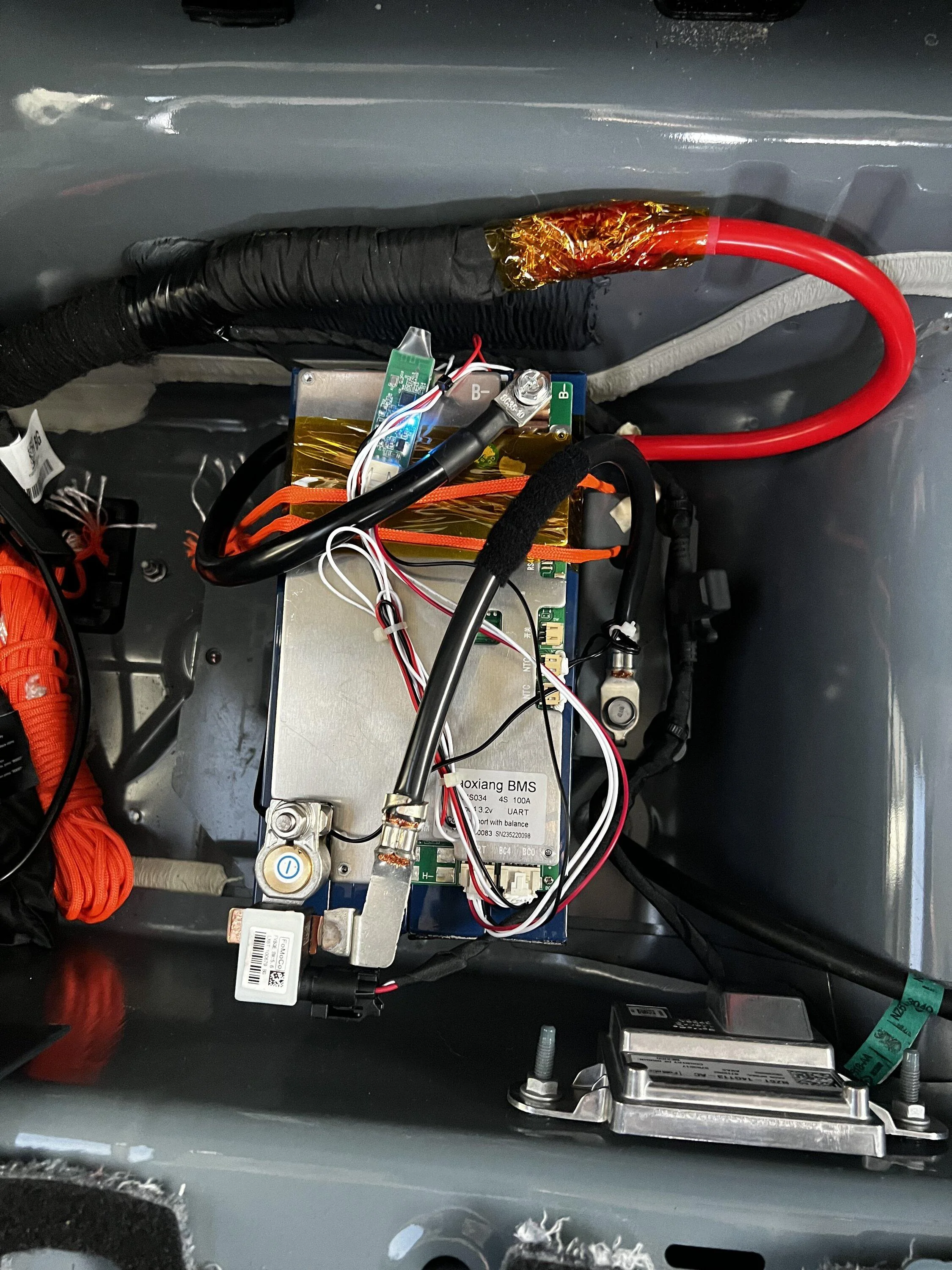

Well folks, I did it. I replaced my (edited) Lead acid battery with a LiFePo4 battery. I haven’t see any posts of anyone else doing it but if you know any, I would love to read them and see what they found. I’m not going to tell you how to do it because I’m not convinced it won’t break something yet but I can share what I’ve found so far. All of this is based on my 2023 Hybrid (edited) lariat with copilot 360.

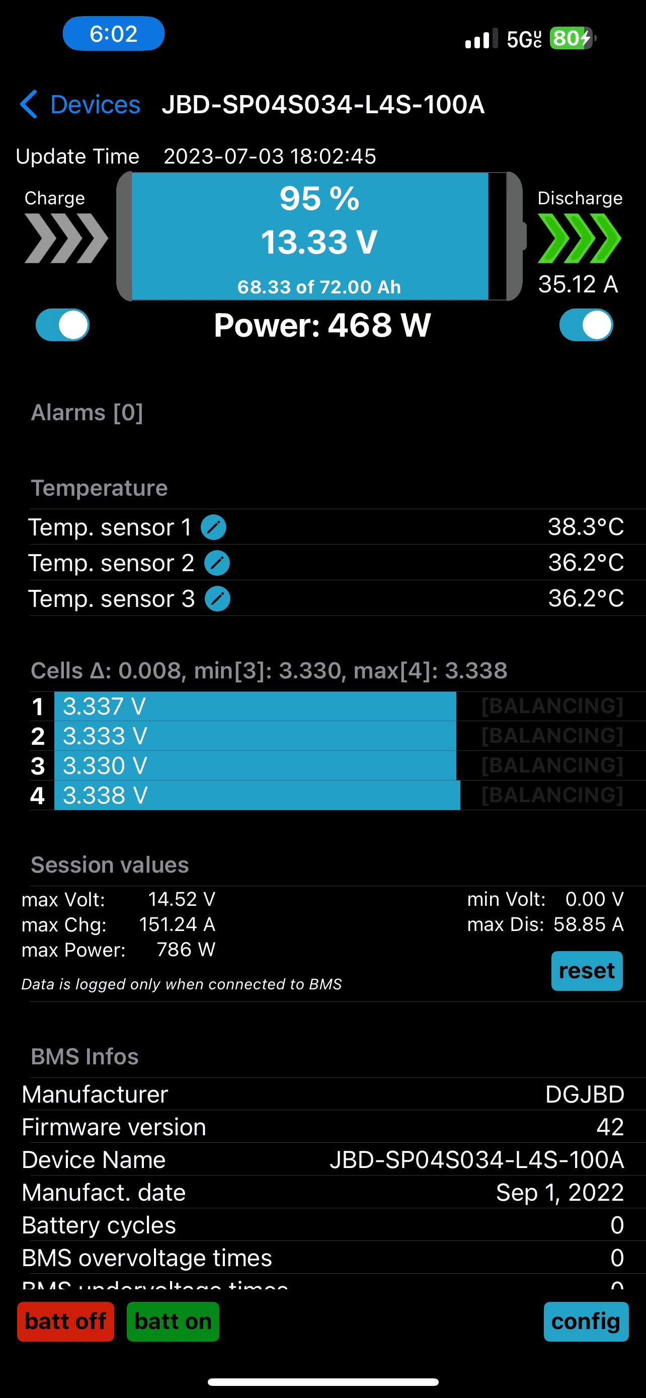

I built and put in a 72 AH battery. I have a Bluetooth BMS attached to it so I can see a lot of stats with the main ones being power draw and amperage for charging.
Good news is that the truck seems to mostly be plug and play with it. Started right up and charges it with no issues so far. Bad news is that I still have the stupid deep sleep issue even though when I woke up this morning, battery was at 50% I think around 13 volts.

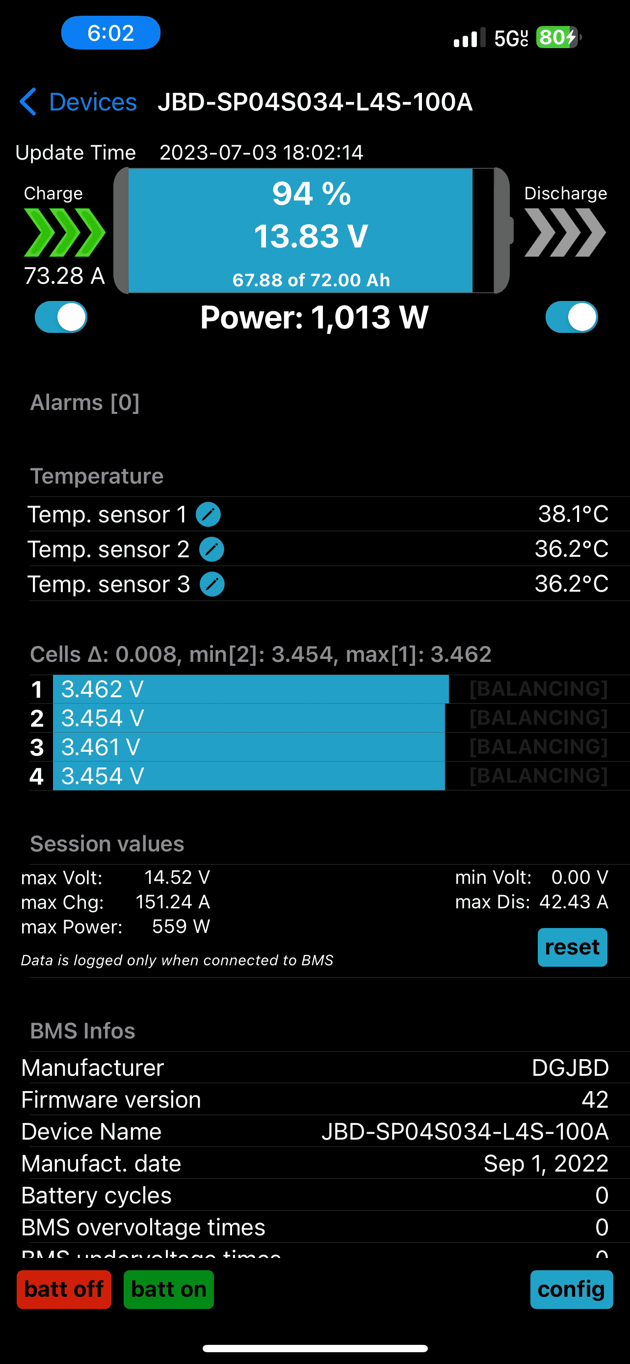

The dc-dc converter has dumped a max of 170 amps into the battery but it normally charges at a 120-130 amp level until it starts to fill up. So anyone who’s thinking of high amp draw accessories (winch or ac converter), unless you upgrade the battery, you should be good up to 120 amps continuous. Normal power draw while driving sits at about 20-40 amps dependent on what’s running for accessories.
Temperature seems to be a little bit of a concern, my batteries are good up to 45*C and we are getting up to the high 30’s low 40’s sometimes. I think using a bigger cell would help dissipate some of that heat.
Another thing is that it seems to like to charge the battery to between 50-55% until it randomly decides to charge full. I haven’t figured out if this is something with the batteries bms or the trucks yet
I’ll post a couple screenshots from my bms screen and if you have any questions or anything you would like me to check, let me know and I’ll try it out.

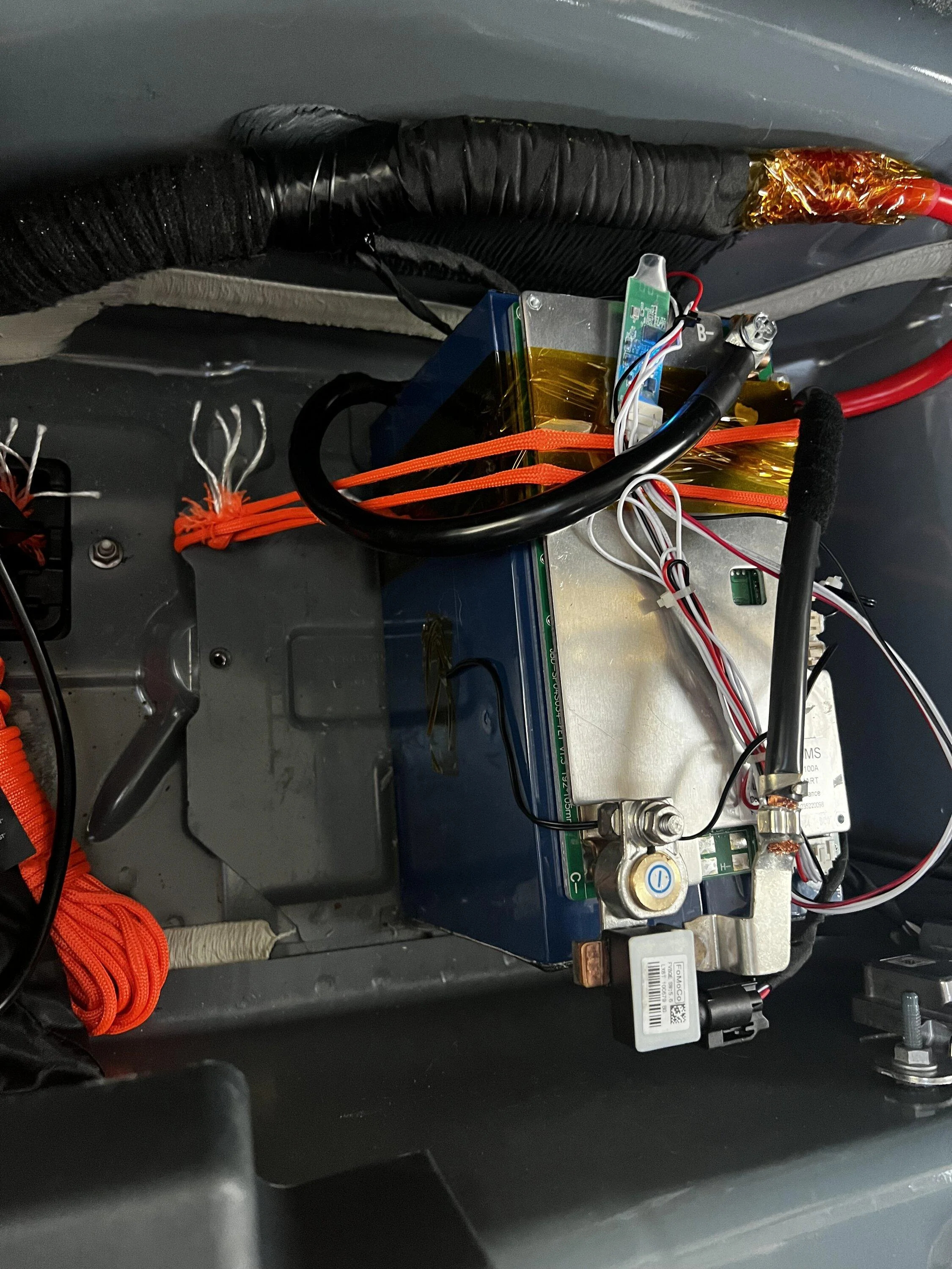

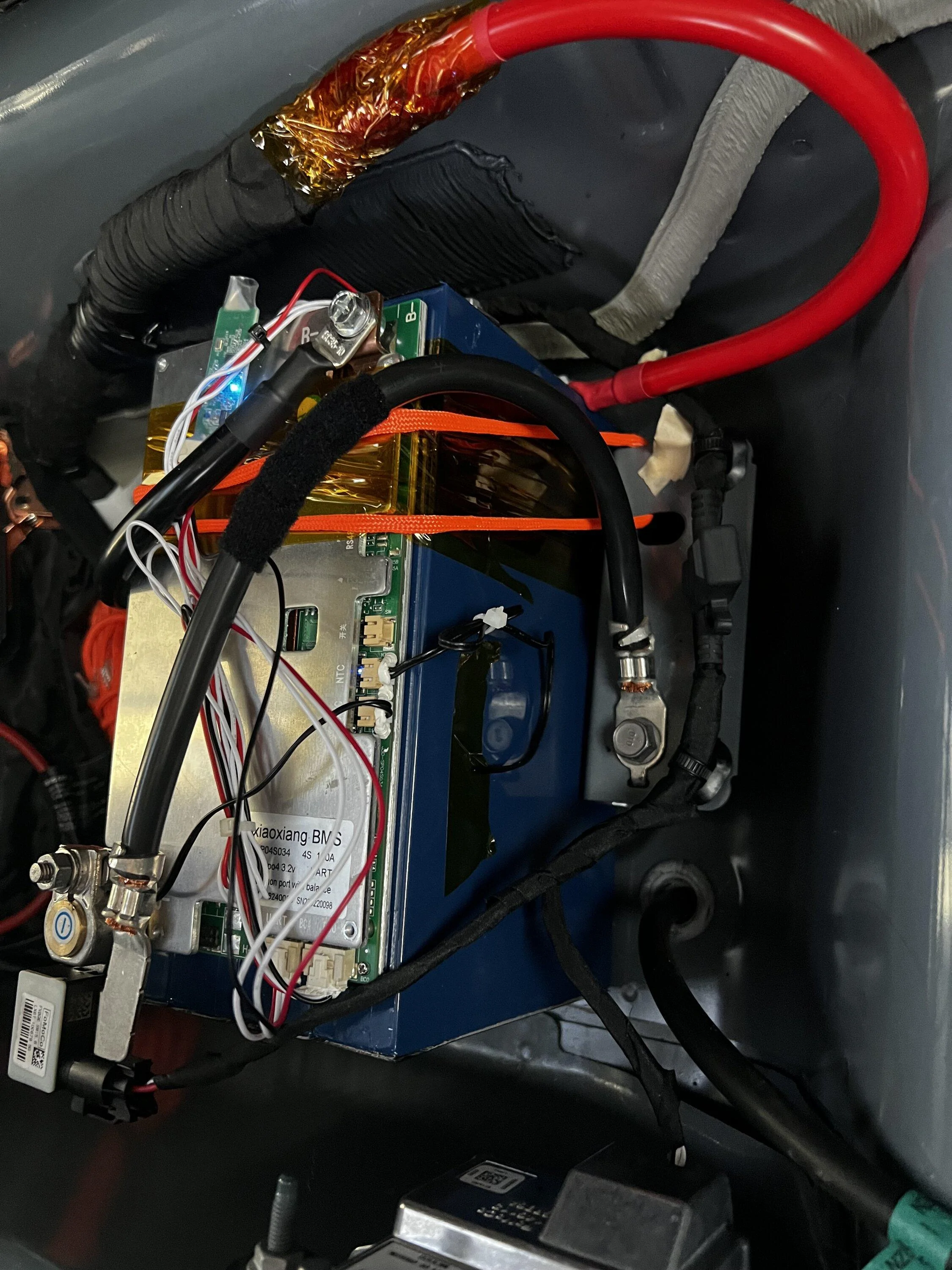

DONT DO THIS. USE A PROPER CASE USE HEAT SHRINK ON ALL CONNECTIONS AND GET A PROPER MOUNTING MECHANISM
