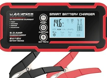

This isnât really a thread about battery charging but most chargers are functionally the same. I say if it has a decent number of reviews and itâs rated 4 star or higher, youâre probably good
- ăAll-IN-ONE CHARGERăSimple operation, all-in-one battery solution for charging battery, battery maintainer, trickle chargerïŒone stream battery, battery desulfurizer.This battery charger can automatically detect battery sulfation and acid stratification and use pulse repair function restore lost battery performance for stronger engine starts and extended battery life. Charges batteries as low as 1-volt. Repair mode restores stratified and deeply discharged batteries. bought this for when I replace my battery, would appreciate comments on if I fell for advertising or this could actually work
aware its not about chargers, but there seems to be excellent knowledge about batteries in these posts. I have always dealt with regular lead acid. Now with the deep sleep issue it would seem I will need to replace the current battery. desulfate is a new concept to me, I plan to buy a battery, charge it to capacity and install. This charger says it will do everything but get groceries, time will tellThis isnât really a thread about battery charging but most chargers are functionally the same. I say if it has a decent number of reviews and itâs rated 4 star or higher, youâre probably good
