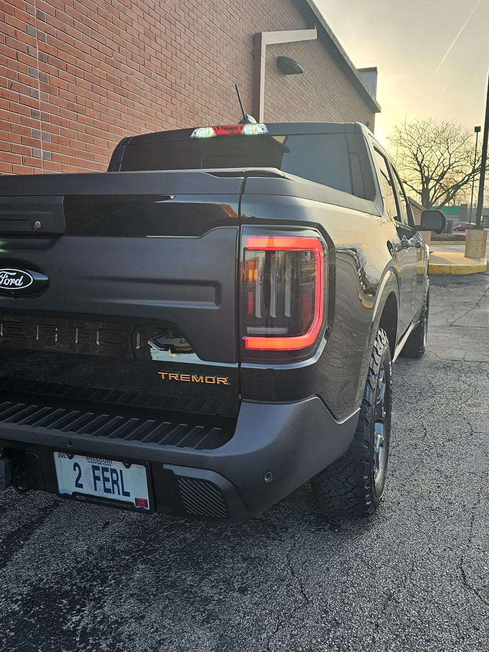

MINE AND ALOT OF THEM HAVE A RAKE TO THEM MY REAR SITS ABOUT AN INCH AND HALF TALLER . A LEVEL PUCK IN THE FRONT WILL MAKE IT MORE EVEN
I like the ‘rake’ look on a pick up truck or any hot rodded vehicle but I suppose level will handle better in the slalom section or any turn.

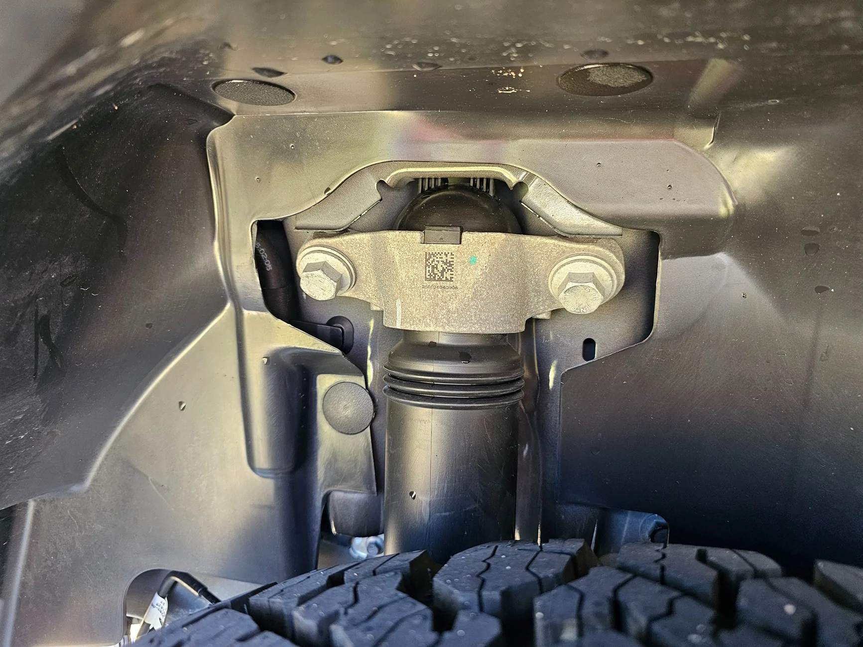

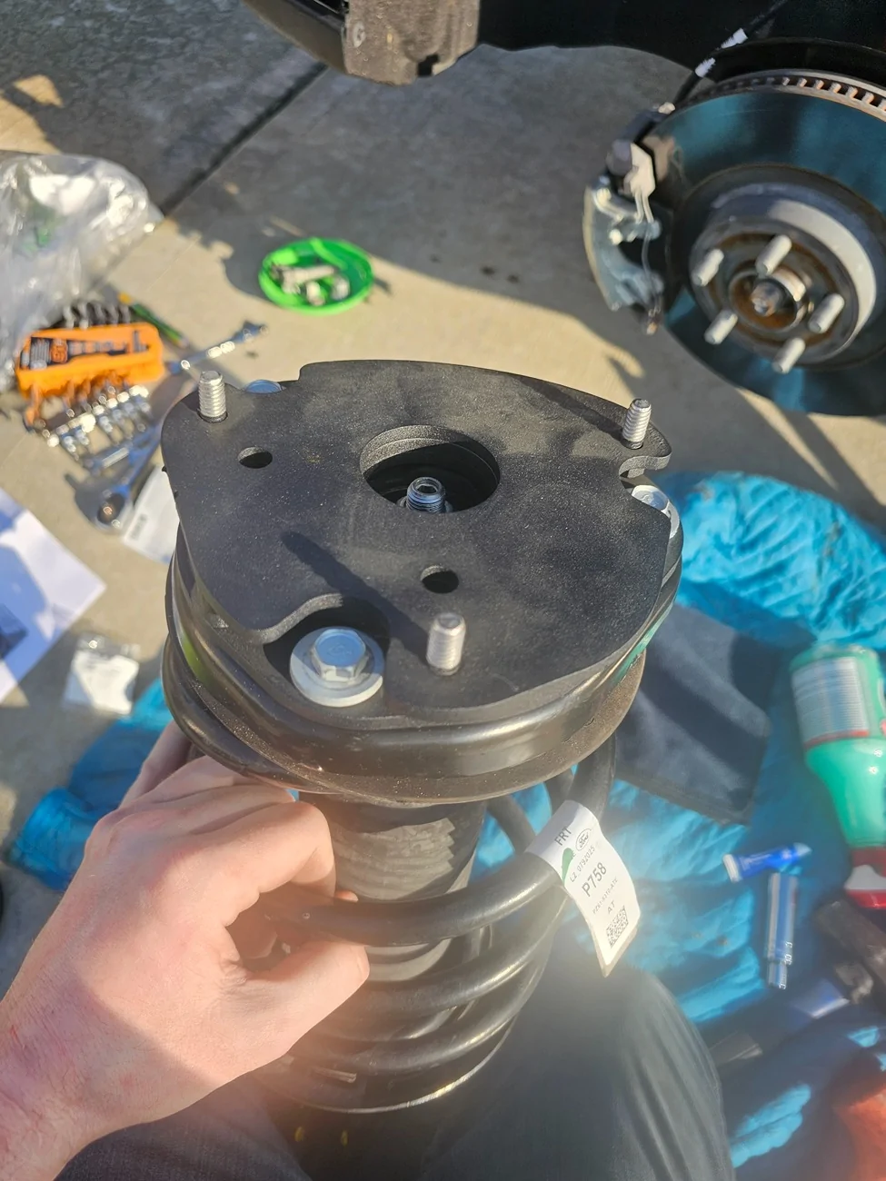

Ended up buying the zone level kit . It was all metal doesn't require any grinding of the strut just bolts ontop, Also can be aligned with the factory stuff and doesn't change the ride. I just haven't installed it yet

NONE OF THEM SAY OT DONT SAY IT WILL WORK , BUT ALL THE MAVERICKS USE THE SAME TOP MOUNTING PLATE ON THE STRUT. SO THEY ALL SHOULD WORK . I KNOW THE RTR , ROUGH COUNTRY , AND ZONE WORK . AS IVE SEEN ON OTHERS THAT HAVE USED THEM .

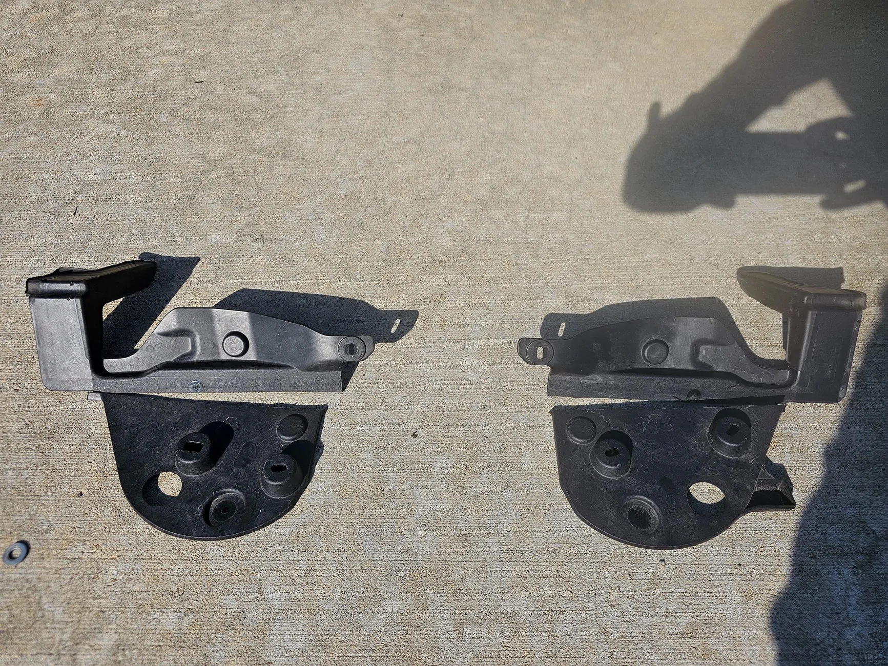

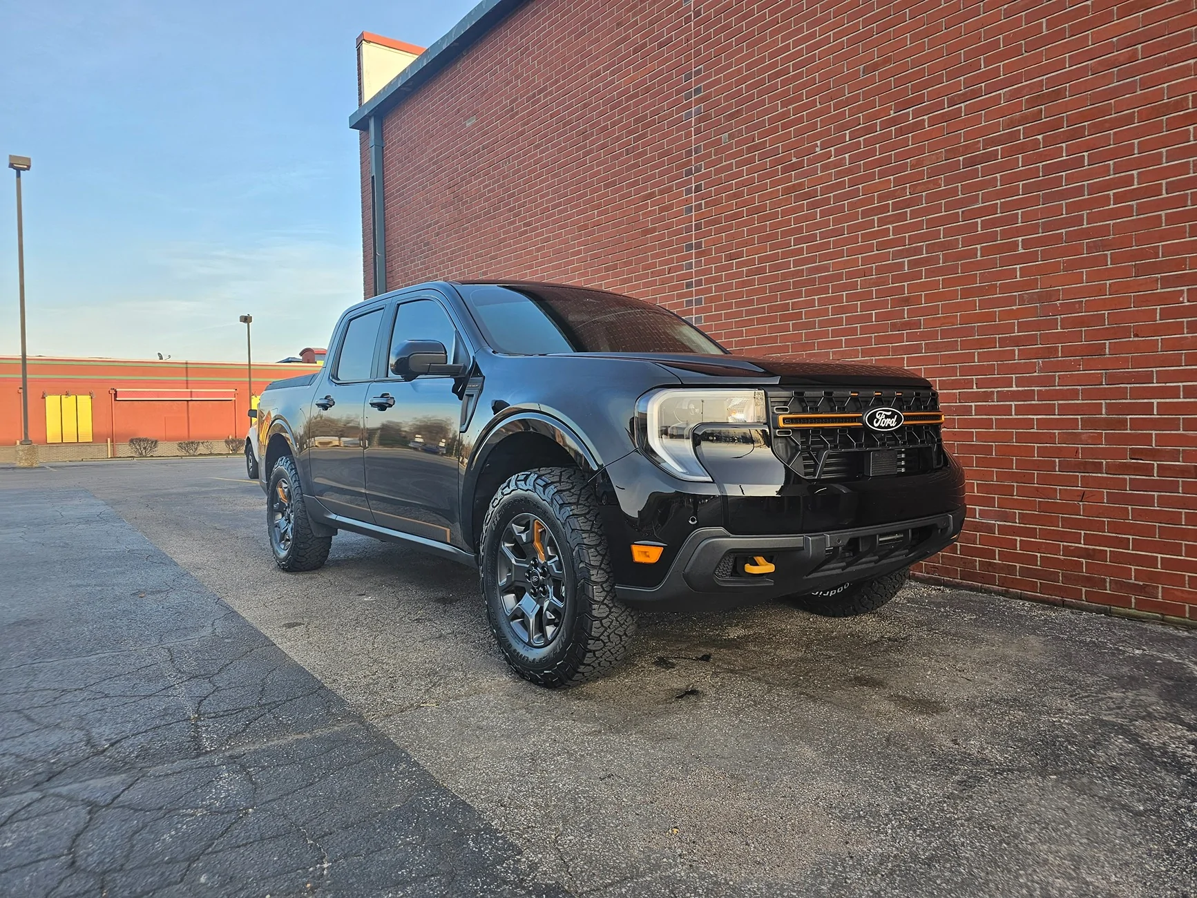

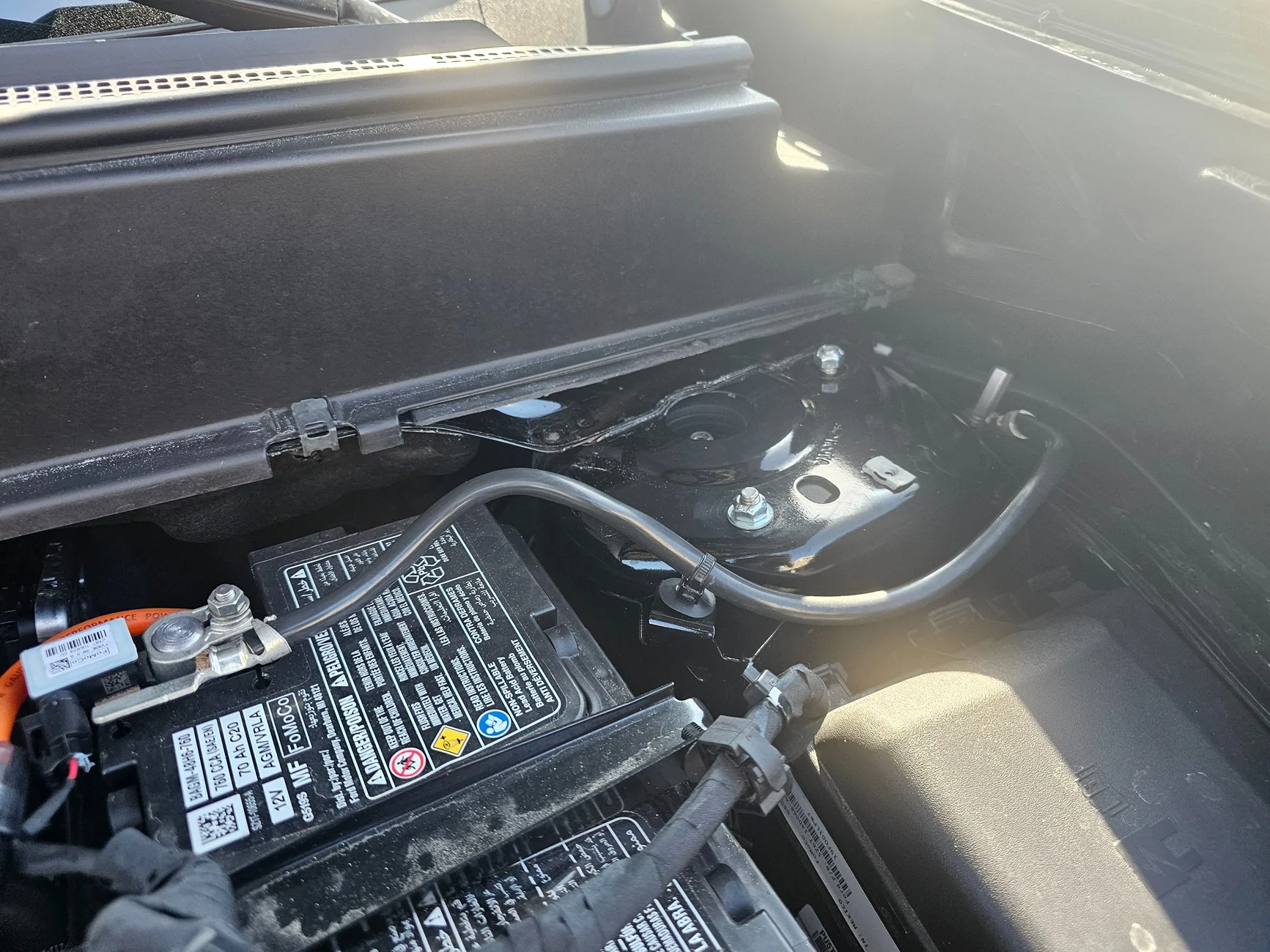

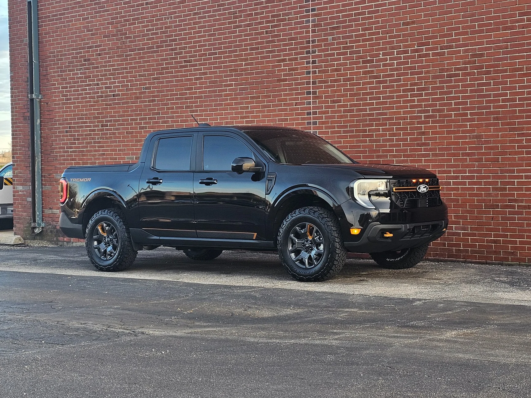

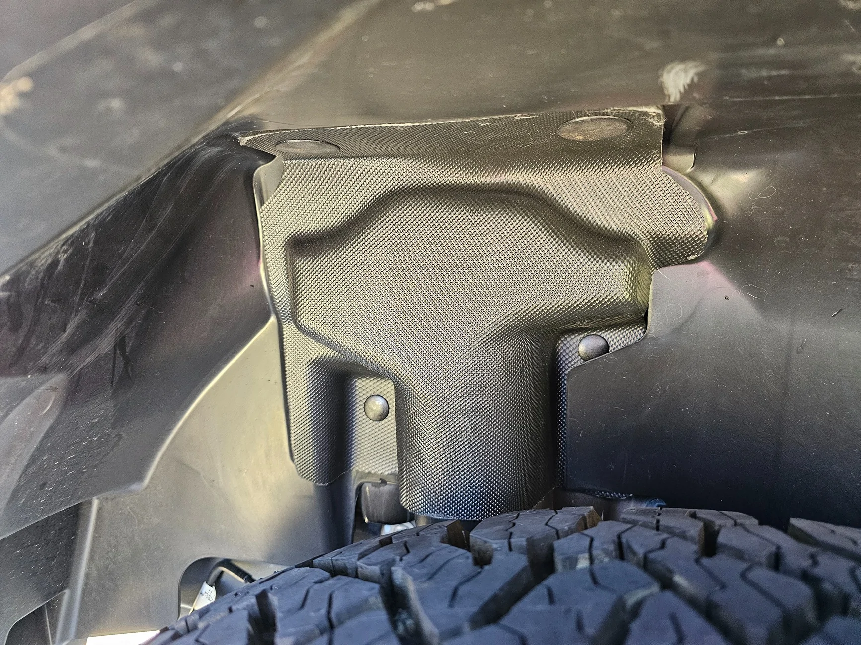

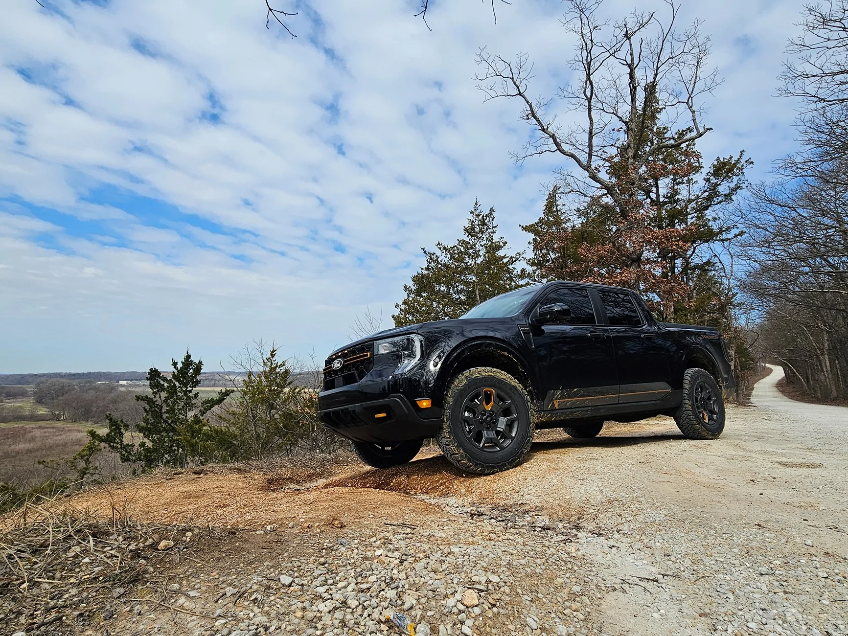

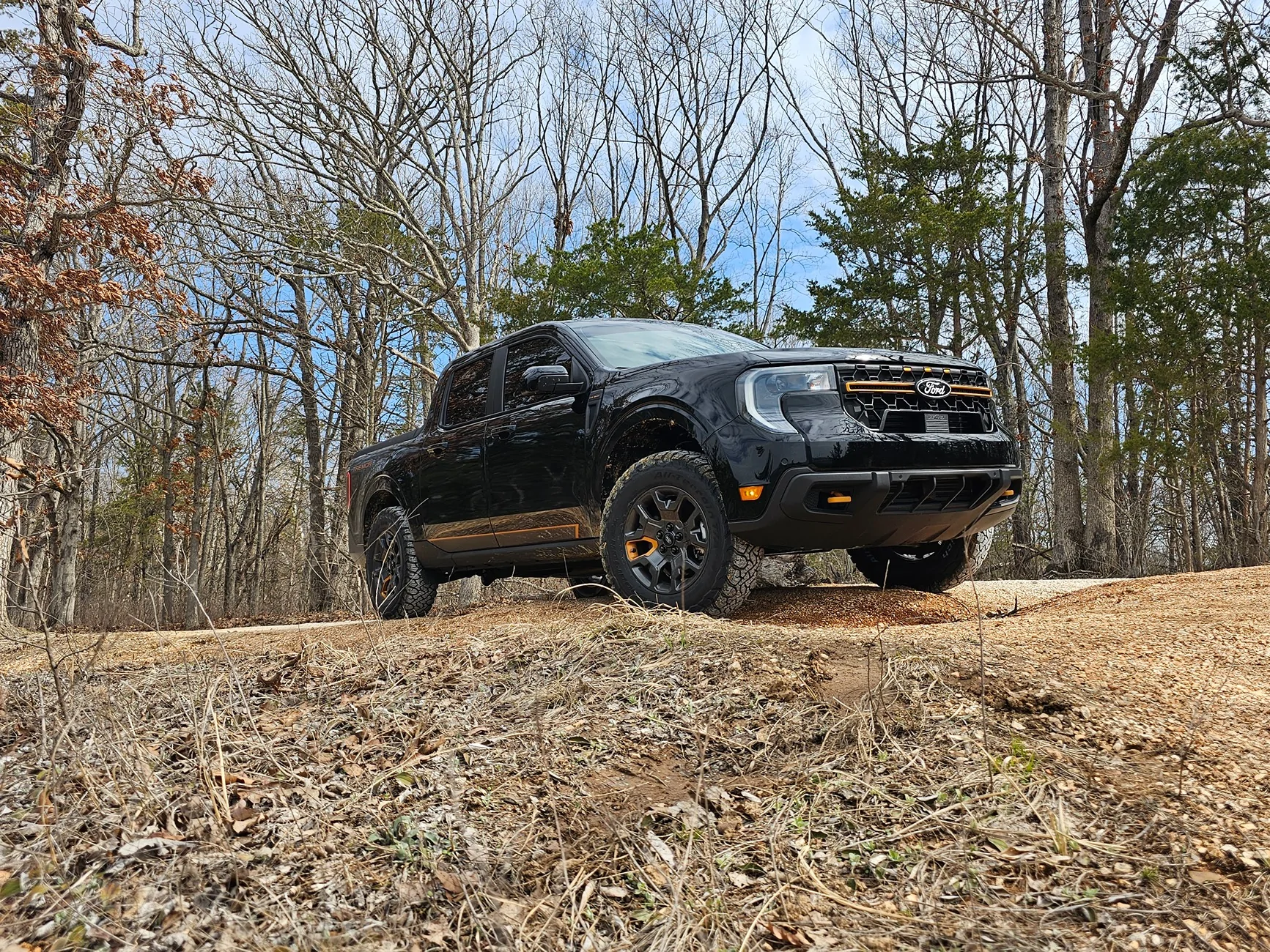

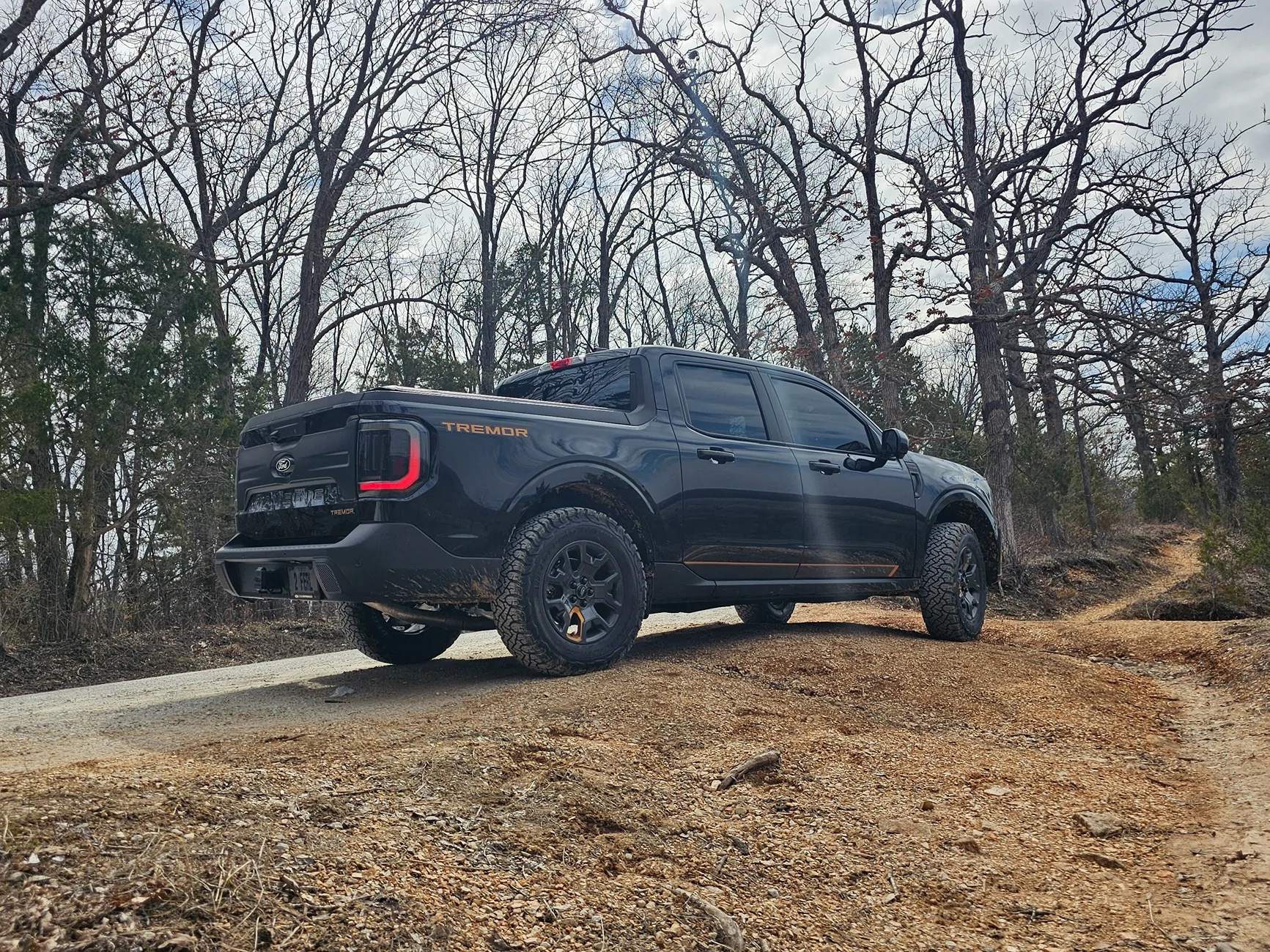

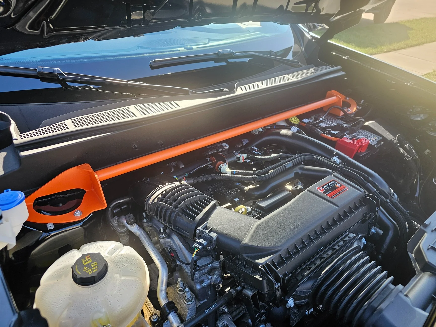

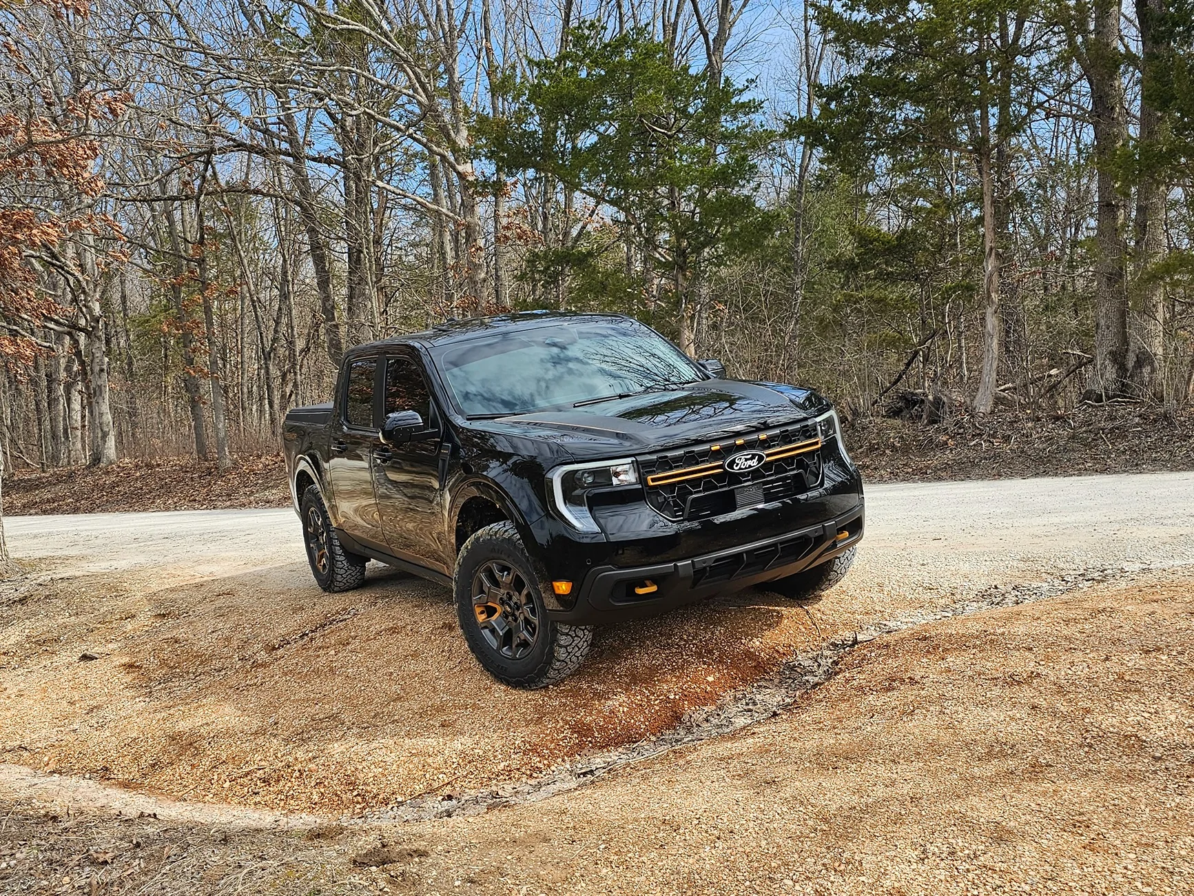

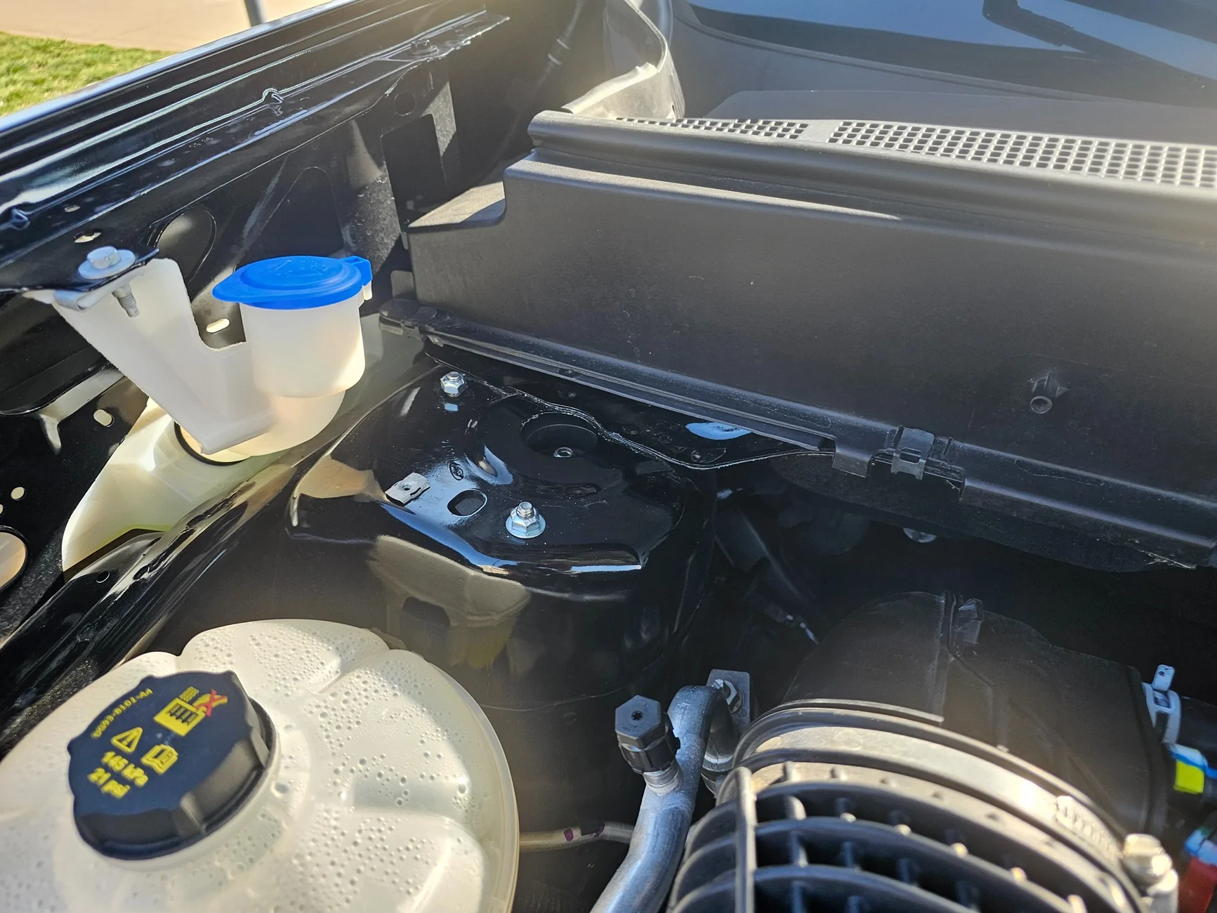

Here is the update . Installed and new tires went with 245/70-17 bfg ko3 . No rubbing even at full lock . Trimed the wiper cowl / strut cover to keep it sealed and installed a massive brace . Took 1.4 mpg drop due to the mass ,which I expected still getting 25.4 avg . No not mad
