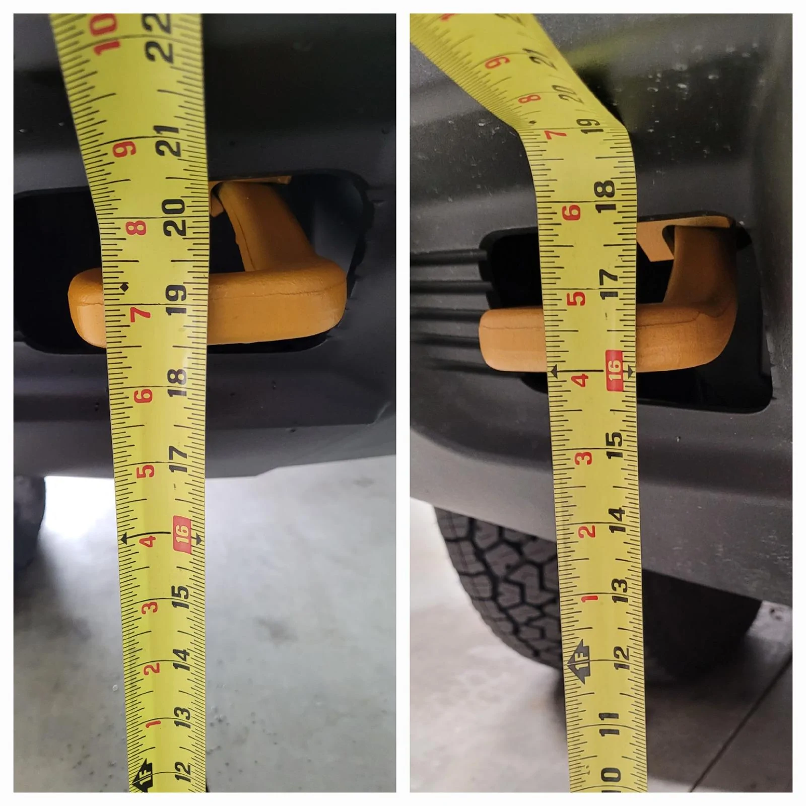

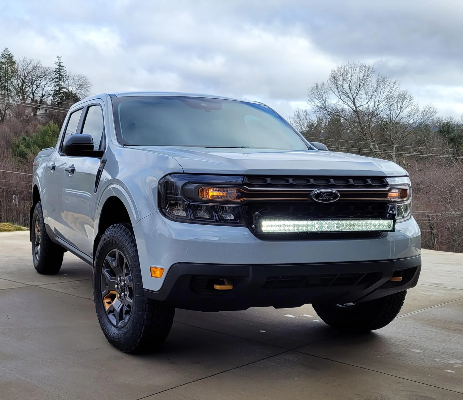

I went with the fordrangerlifts.com 1.75 lift kit made for the tremor. It does make the ride a bit stiffer. But I do really like the kit. I don't think I would go as tall on the tire size if I did it all over again. It rubs at full lock, but not very much. 235/75/17 Open Country tires.
The Tires look good at that size. Where do they rub, maybe a little trimming would fit it?
The Tremor has stronger CV's and lower gears than most Mavericks.
So far I have only seen posts about CV problems on Non-tremors.
There is one guy running 33" on his Tremor and he really is taking it off road too. So he will be the test case to let all of us know what the Tremor CV's can really handle or not.
More info on the build: https://www.mavericktruckclub.com/forum/threads/prerunner-style-maverick-tremor-build-w-33s.40538/
Other trucks are running 32" but I think this is the first to go 33.
Your Tremor looks really good the way you have it set up.
