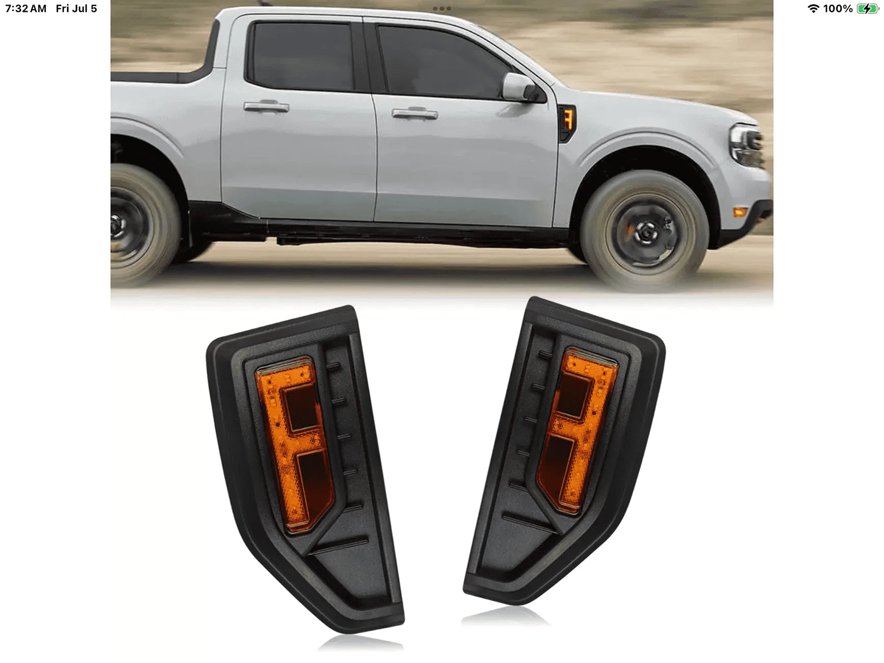

Hello all, I was wondering if anyone has purchased these.
Ford Maverick Letter F marker lights IMG_3331

I have to say the backward "F" looks bizarre.

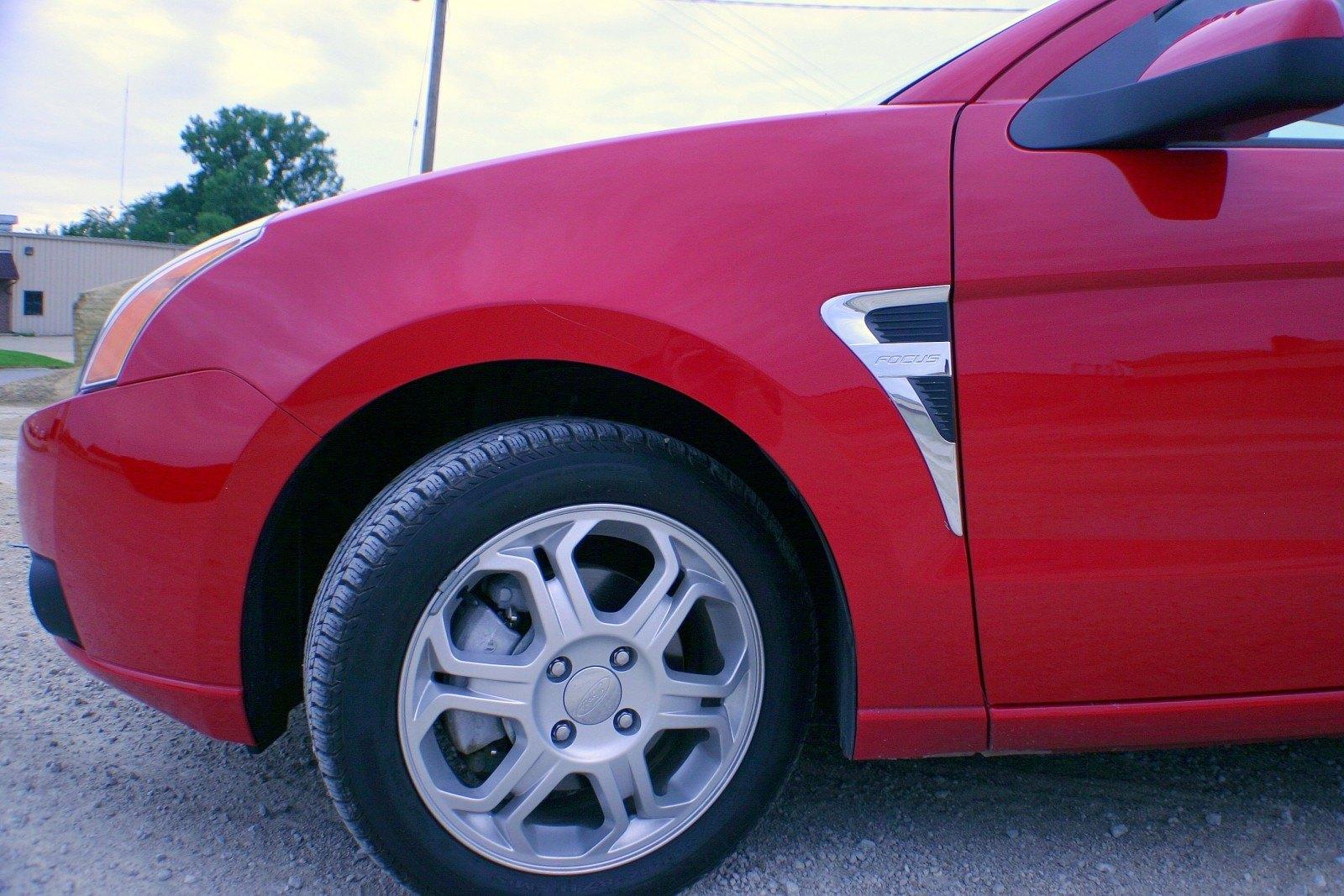

Reminds me of the 2008 Focus refresh. Wasn't really fond of them back then either.
Ford Maverick Letter F marker lights Ford-Focus-fender

I think it stands for FOOL.
