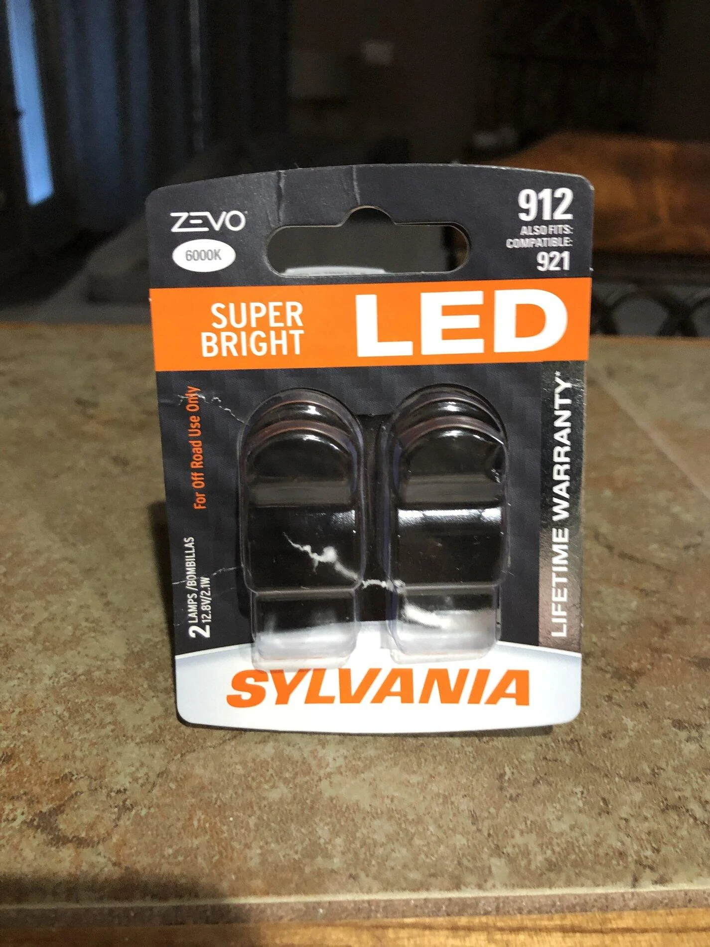

I ordered these on amazon and instslled them a week ago. Zero issues... No resistor necessary.
