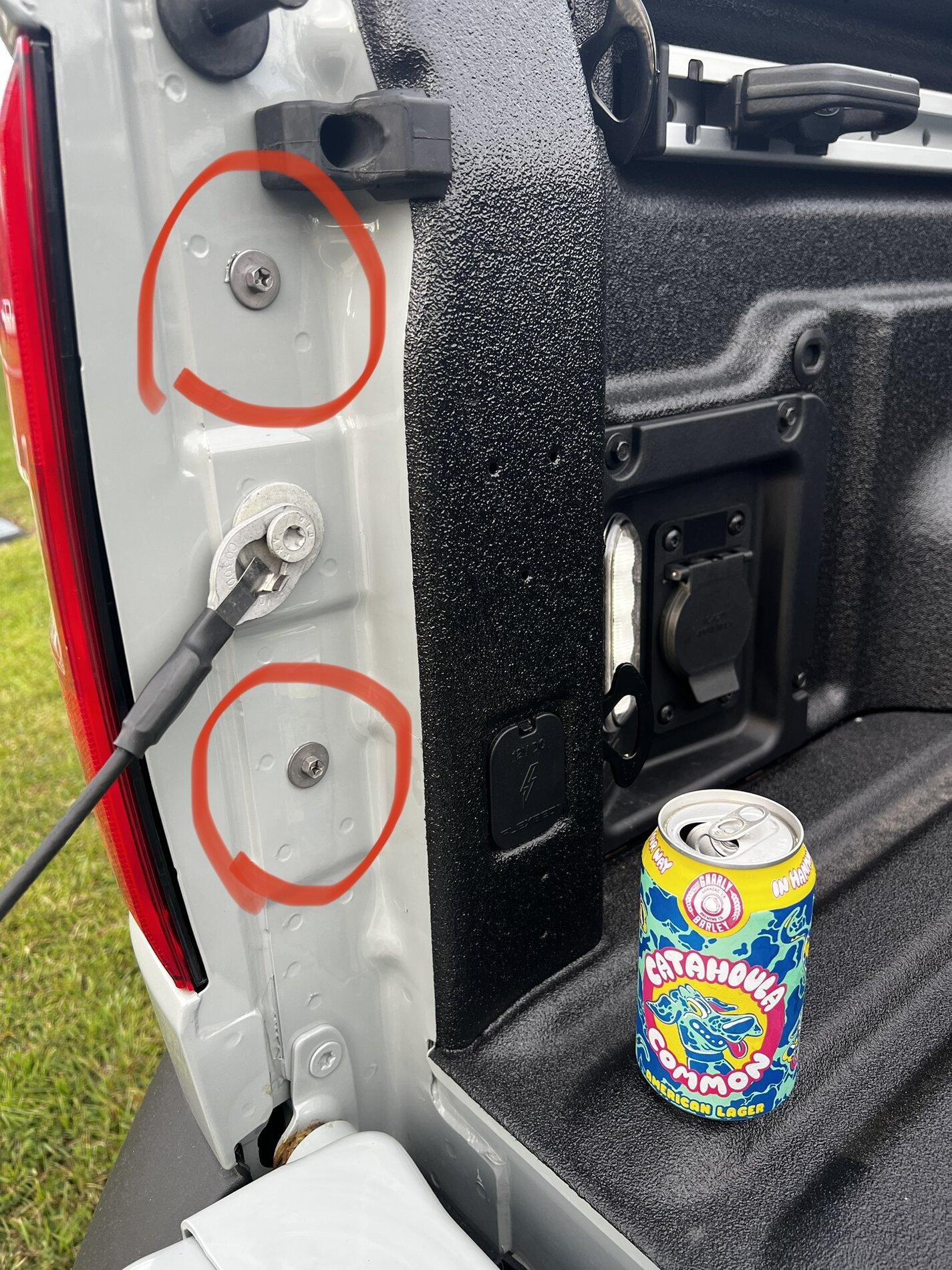

Two bolts on the inside near the tailgate then just pull the light straight out.

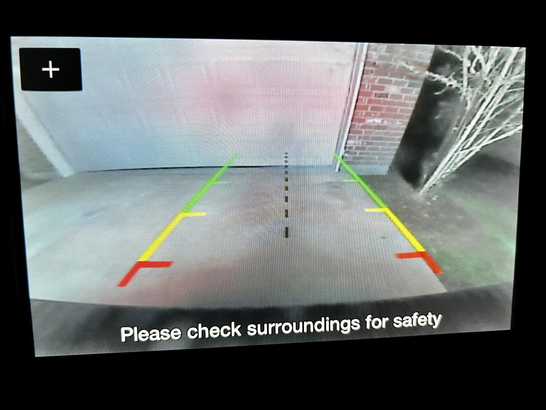

I know this is arguably the worst update ever but this is all I can do right now as I’m home alone. This is with the new bulbs. Trust me the before is far darker lol. I’ll try and update this later.
Nice!
Any chance you can show where those bolts are? I was looking at the back of my maverick and couldn’t find a spot for the light at all…
