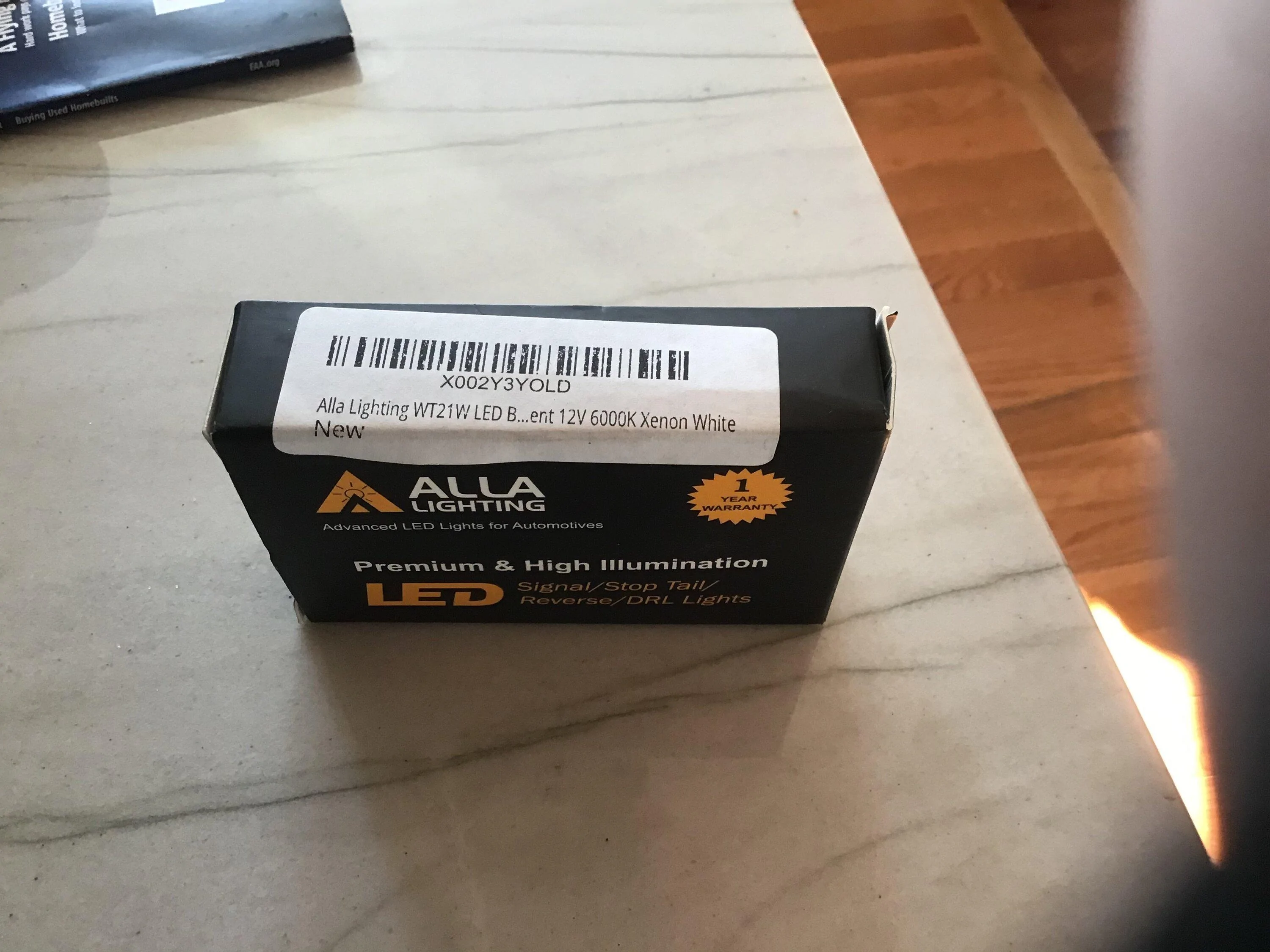

I also installed the Alla bulbs in my reverse and front blinker locations. Got them for $24.99 a pair on Amazon. The lights look great, but I do have fast turn signals now, although the actual flash rate on the bulbs doesn’t match the sound inside the truck, and bulbs actually flash slower than the speed of the turn signal sound. My wife hates the “nervous blinker” sound so I have some work to do still, haha

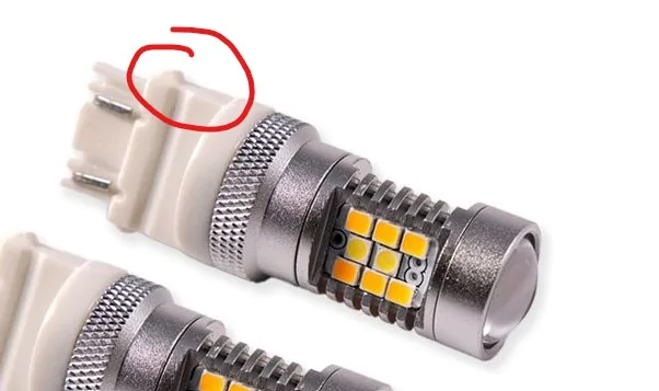

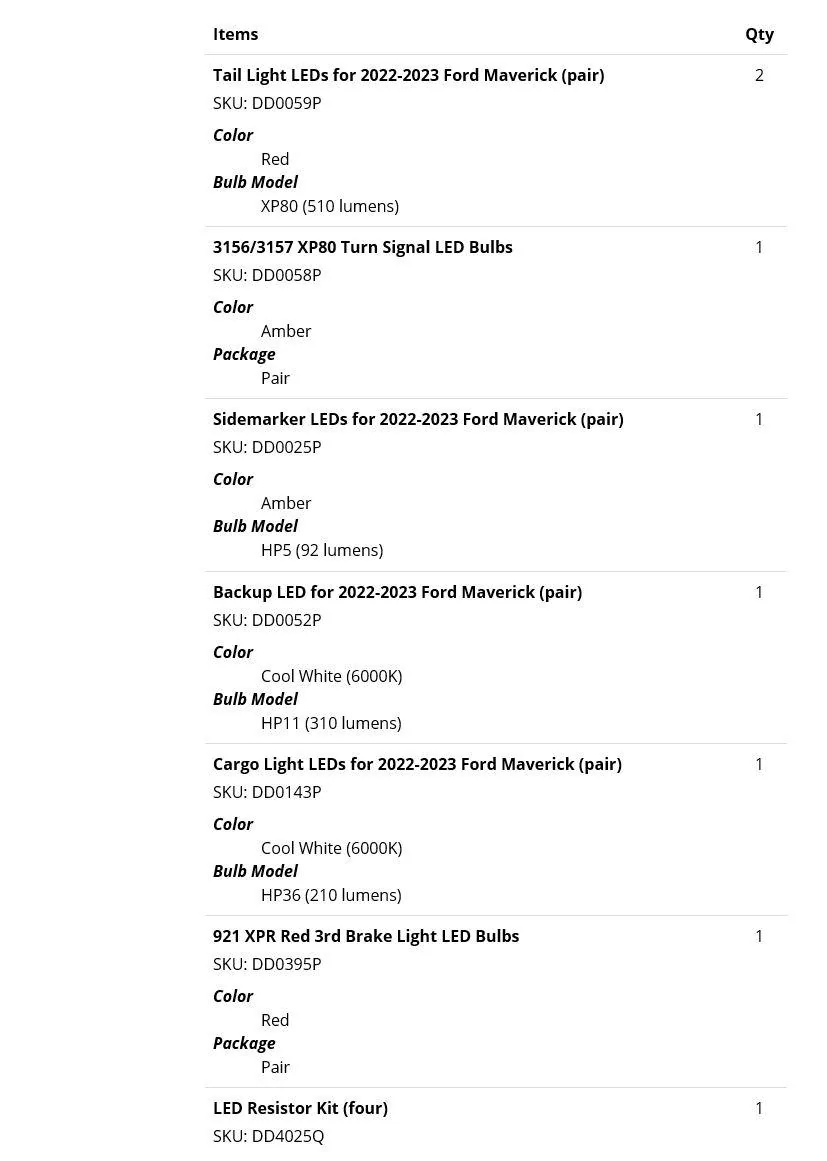

Just wanted to report back on my installation of the Diode Dynamics led bulbs on my 24 Lariat Hybrid Mav.
See attached for what was ordered. Got a nice 20% discount over black Friday. The 6 rear tail light bulbs and front turn signals needed to have the locking tabs shaved off. The Dremel tool made that very easy. The rest of the bulbs were plug and play. I don't notice any hyperflashing on the exterior but the interior turn signal indicator is going at twice it's normal speed and sound. So may need to add the resistors. Sent Diode Dynamics a note to ask about this. Other than that very happy with the new bulbs. Came with a 3 year warranty and no questions asked return policy if not happy with them. Hope this helps others when looking at LED bulb replacements. Only con is price.

Just a quick update on the diode dynamic bulb install. Had some time tonight so installed one resistor on each tail light and one on each front turn signal. The rapid blinking of the interior turn signal is now normal. Never did have any exterior hyperflashing. Just tapped into the red and black wires off each taillight. The most difficult part was pushing back the electrical tape Ford puts on the wires. Then just retaped everything.

So, for the 3156/3157 Diode bulbs for the top rear taillight top location, one-way polarity seems to keep the bulb steady and the other polarity allows it to flash. I didn't play around with the bottom bulb location yet as I wanted to see if these work work in the first place....Using the Dremel sander at the 5 setting was the perfect speed and control to sand the locking 'tabs' off the bulb base allowing it to fully seat - by the way.
