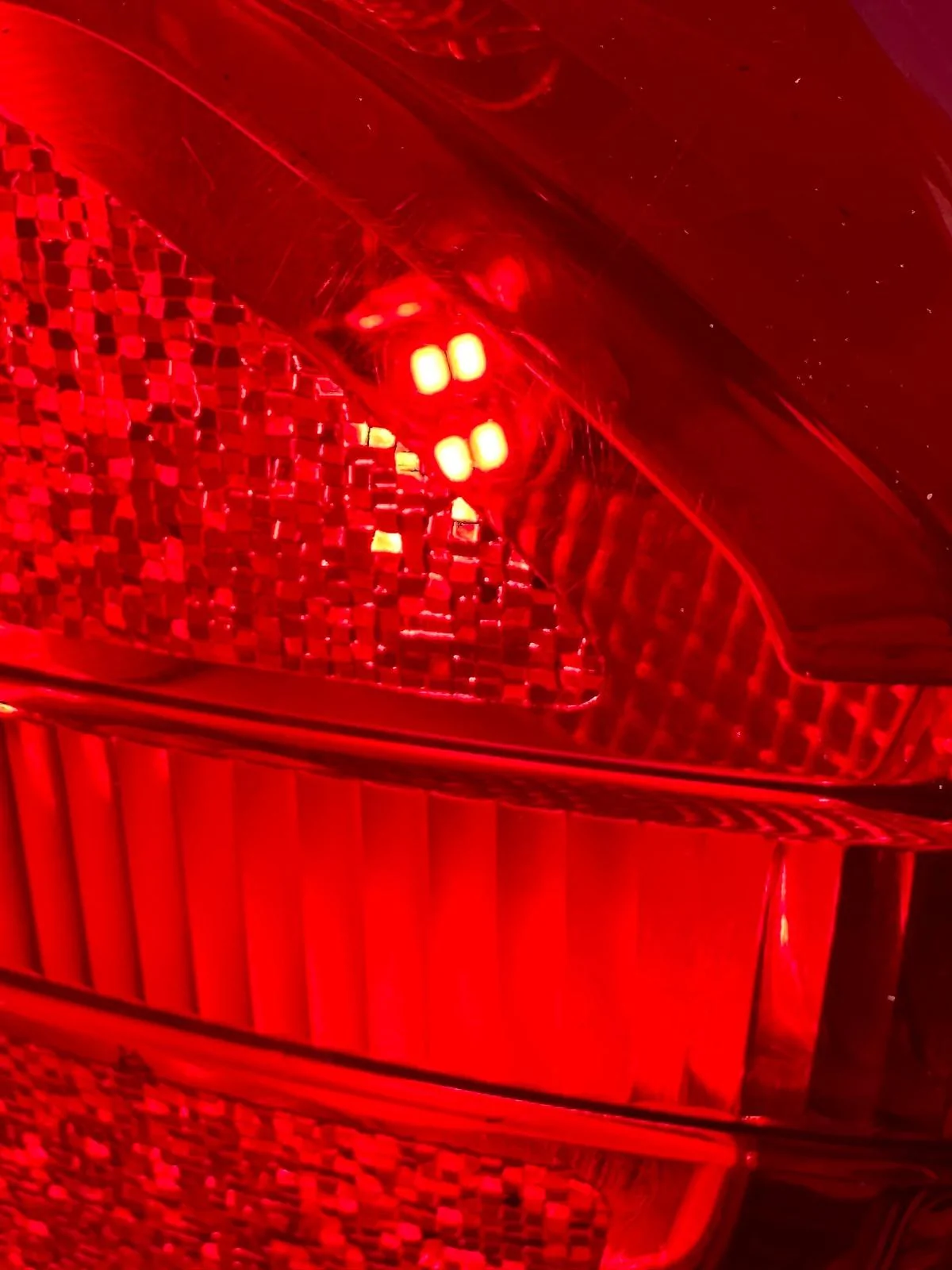

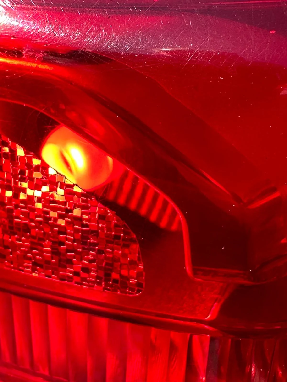

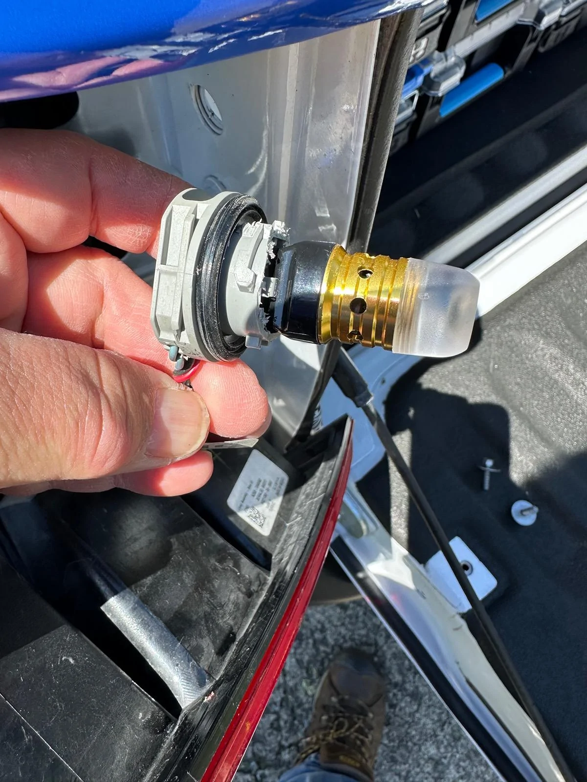

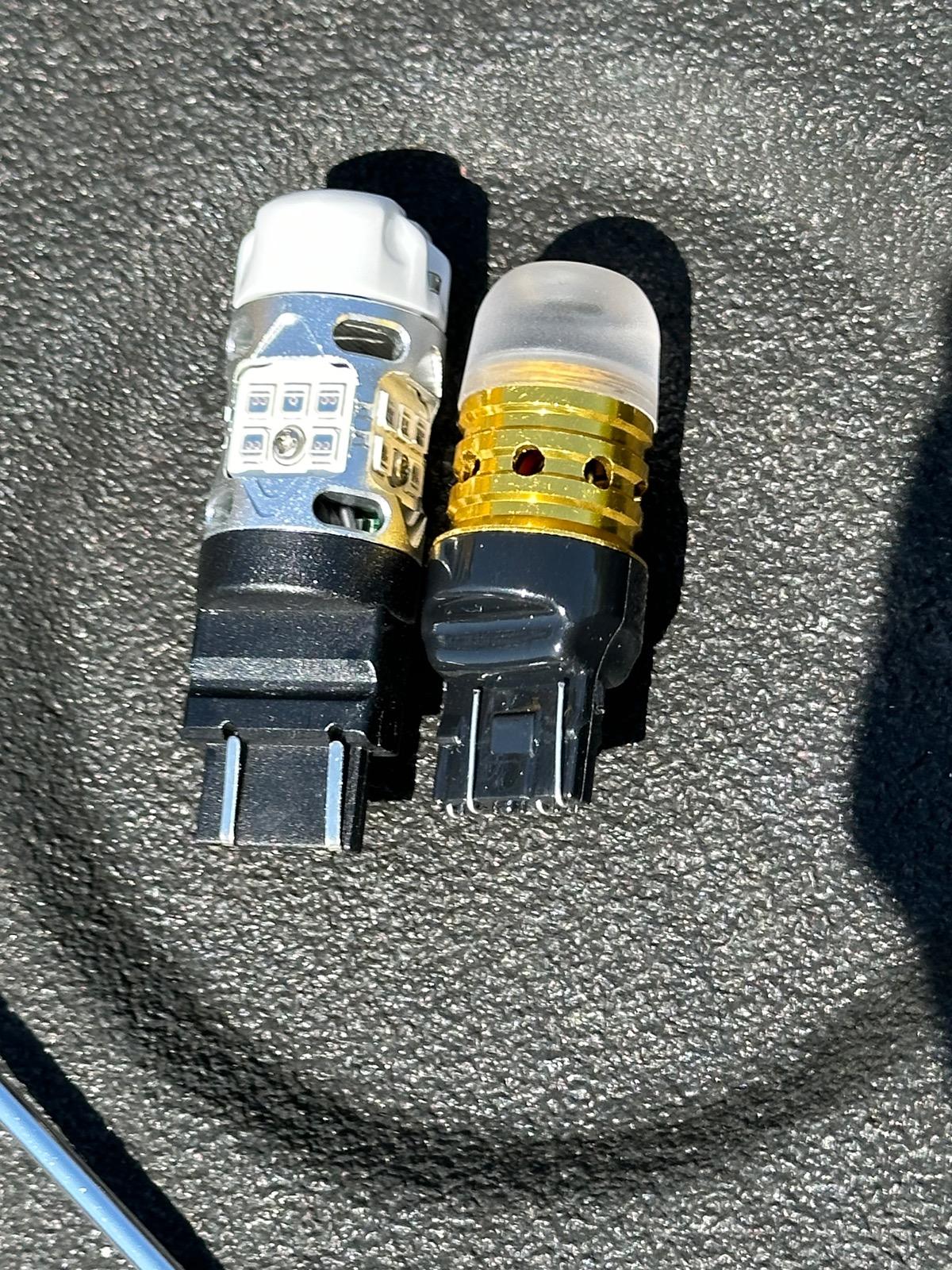

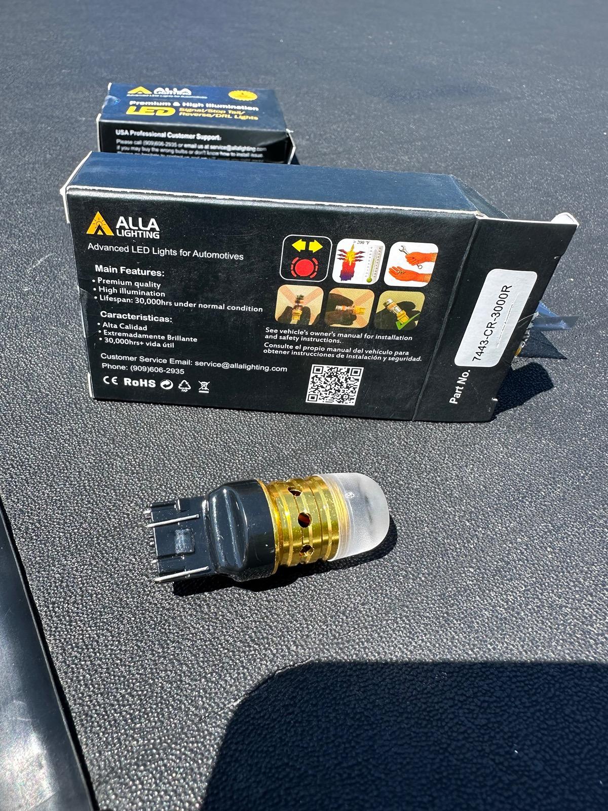

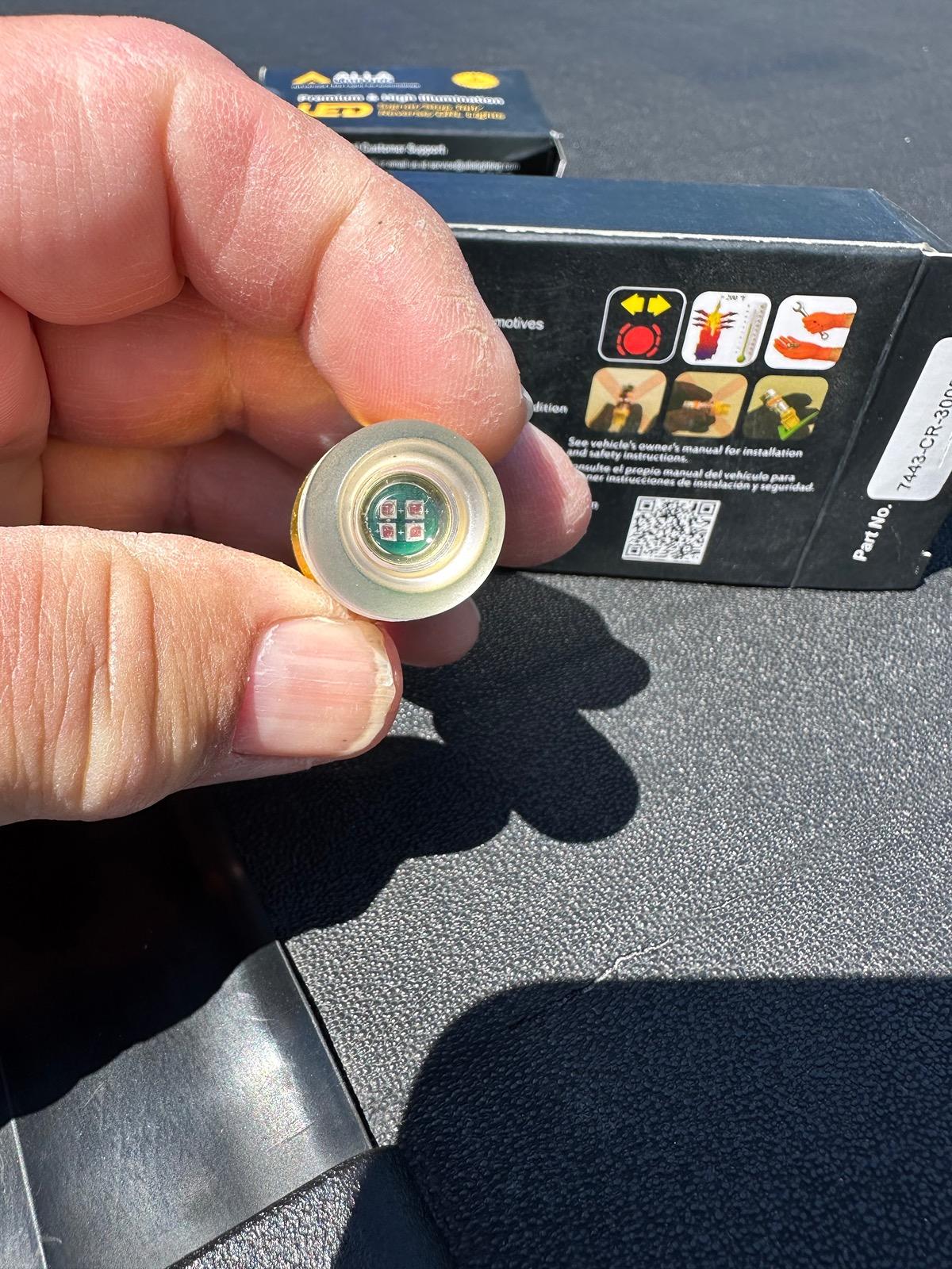

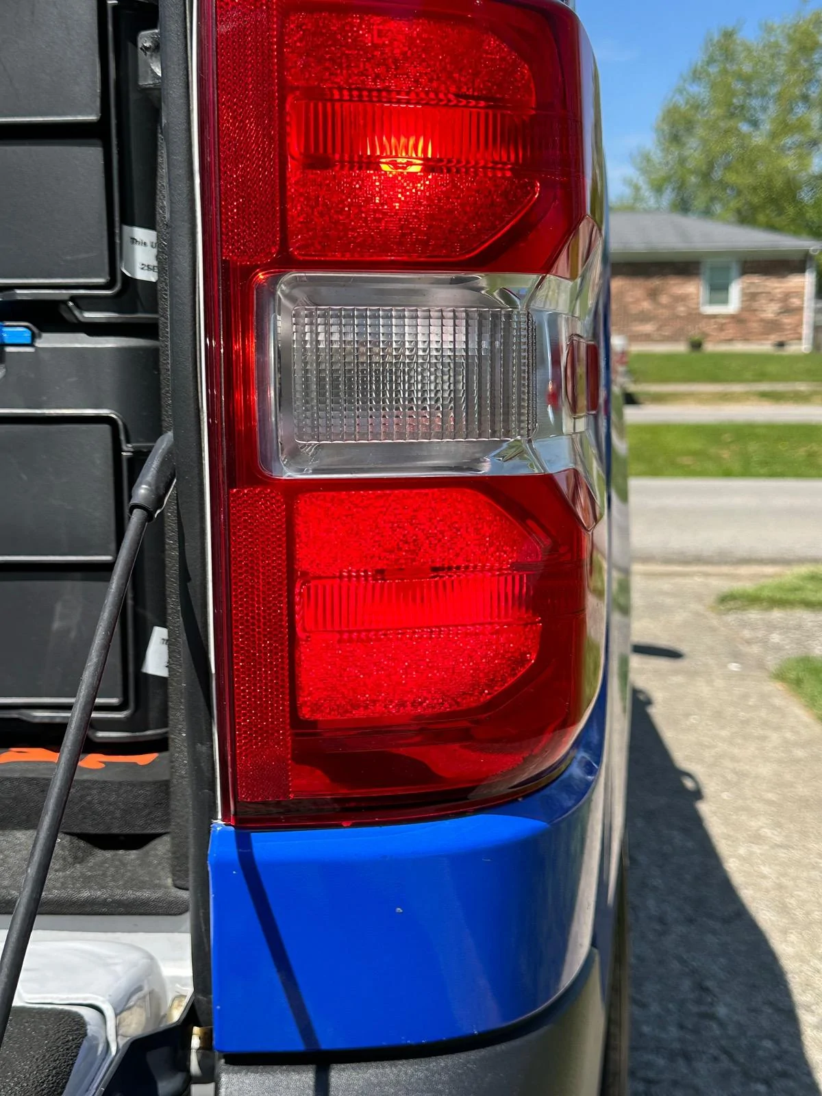

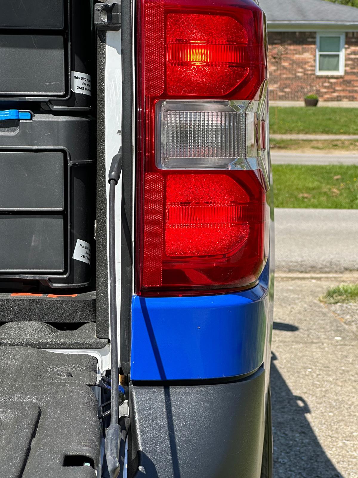

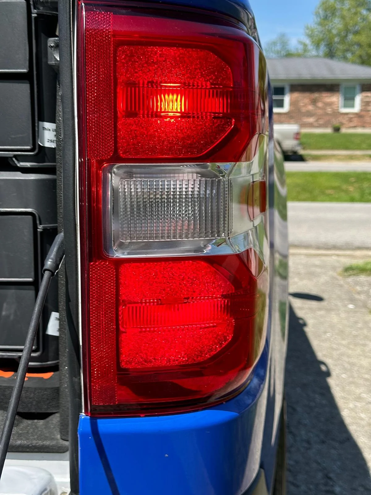

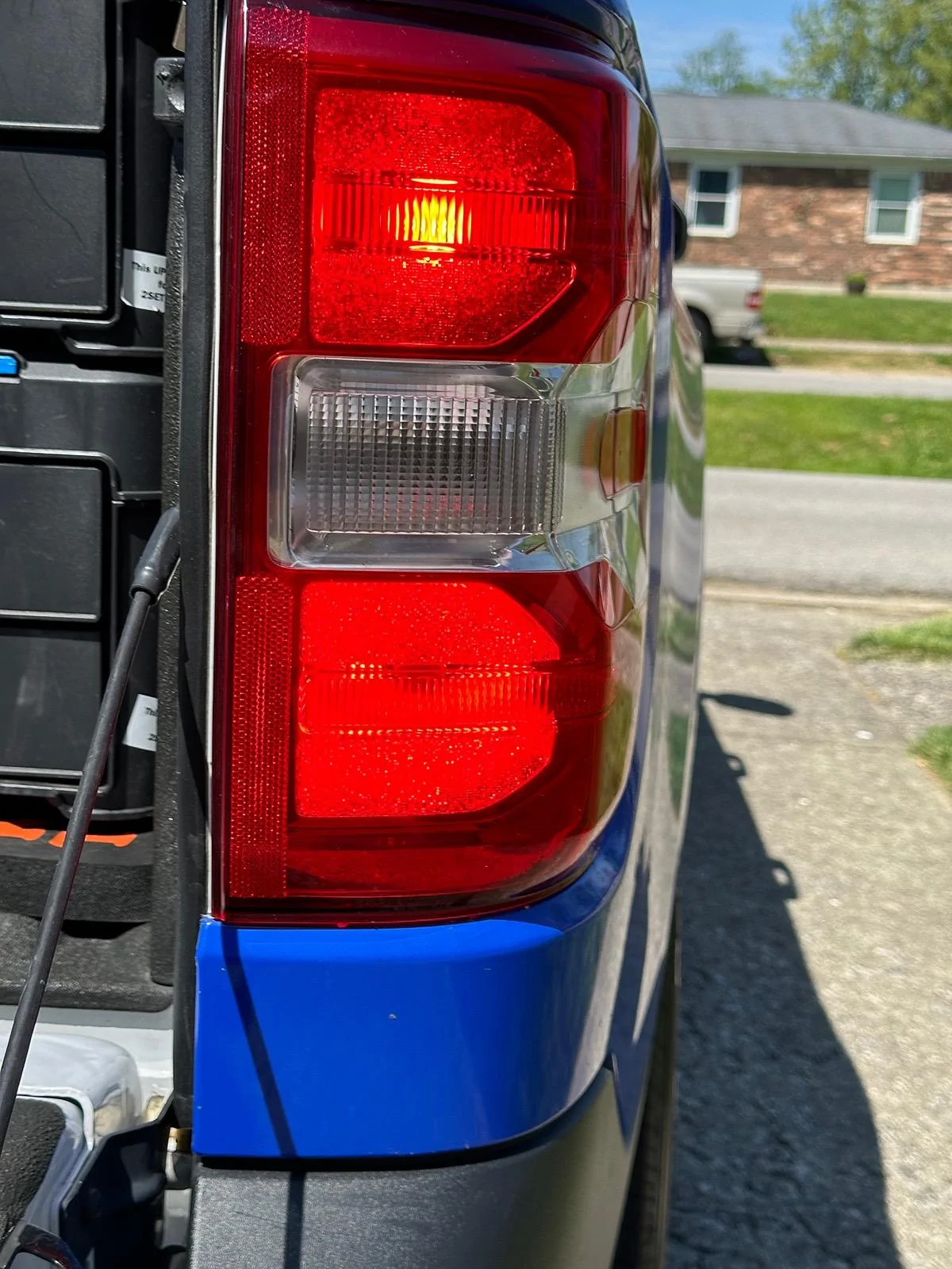

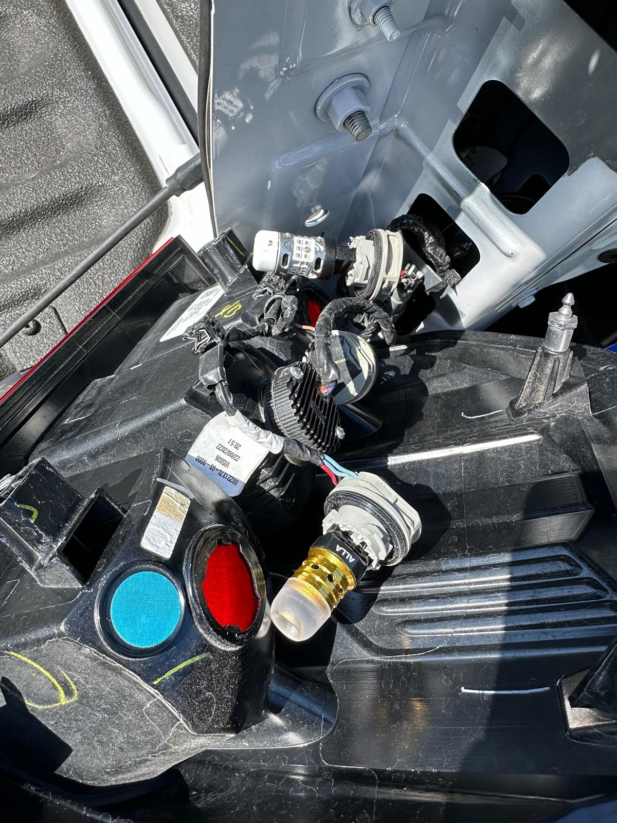

I finally had enough of the Lasfit bulbs burning out in less than 6 months. I called Lasfit and they were nice enough to send out replacements again for the burnt out brake lamps. They did “upgrade” me to the new T3 lamps. I tried them and were very bright when you first turned them on, however after about 4 minutes in of being on, they dimmed down to a 1/3 of there brightness and were freakin on fire they were so hot. I started looking at some ALLA MIN RED on Amazon. Order 2 pairs and WOW. They are projector type bulbs that have a very powerful beam straight out the front with enough spill on the sides. I ran 1 ALLA MINI against the Lasfit T3 in the Same housing. Major difference . The ALLA stayed bright the whole time while the Lasfit tanked down to a glow in around 5 minutes. If Lasfit could come up with a bulb with a larger heatsink to handle the overdriven LED , that would be great. Instaed they just thermal the driver down to unusable level. T3 must stand for Thermal down in 3 minutes

the T3 do work in the Lariat trim after the recall but may cause the interior signal to hyper flash. I resolved this by turning off the warning in Forscan and now I have my LED bulbs and no hyper flash. I regularly check my bulbs anyway so the warning hyper flash is useless to me anyway.

Just don’t use your brakes for more than 3 minutes. They thermal down to glow sticks after that. They would make good hand warmers

Thanks for the response. I used the T3s in my Lariat after the recall and they worked ok (occasional dash hyperflash) for about a month until one of them just no longer lit up. Replaced with OEMs and is now one less thing to worry about until Lasfit or someone else comes up with a more lasting fix.
