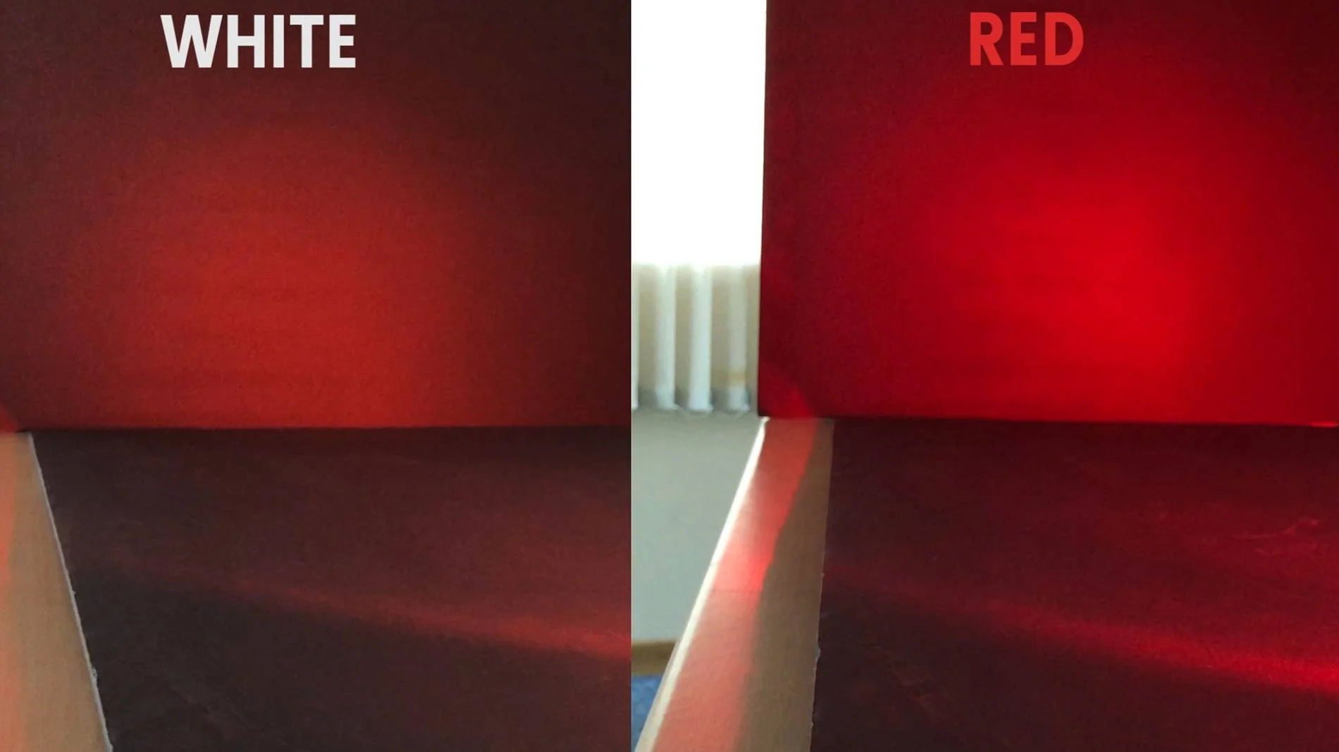

The brake/turn lens is red, correct? Then why are red LEDs being put in? Wouldn't that make the red darker and the driver come up will not be able to tell that the vehicle is stopping.
I would think white would be best.
It actually makes the red brighter and more intense to have a red LED in there. If you put white LEDs in there it will turn pink.
This is an old page but has some explanation and pictures:
https://www.autobulbsdirect.co.uk/b...BEqjz-Ciaczt-SWryMDyUUj1XocaUzV1BlqMcSEMIO_ms
That video was very informative. I was thinking that white would be better. But the light difference can be seen in the picture. I guess I will be putting RED in when the Maverick gets here in January or January February 2025. Oh yes, warmer weather also.
>>Temp got up to 25 degrees & I went ahead & put the RED ALLA LEDs in along w/the backup bulbs from Lasfit. What a difference.

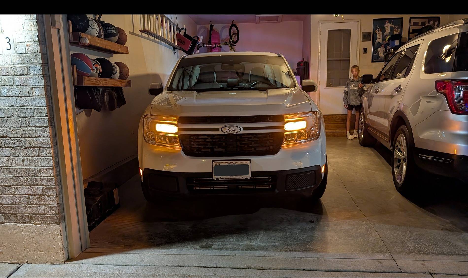

If you want LEDs for the rear brake/turn signals your best option is the diode dynamic bulbs. As like others have already mentioned lasfit no longer makes them for the rear. Lasfit only makes the front parking lights/turn signals which I do like and they're bright but they're not a true Amber.
It might be hard to tell in the picture but they're like a dull Amber is how I describe it.
