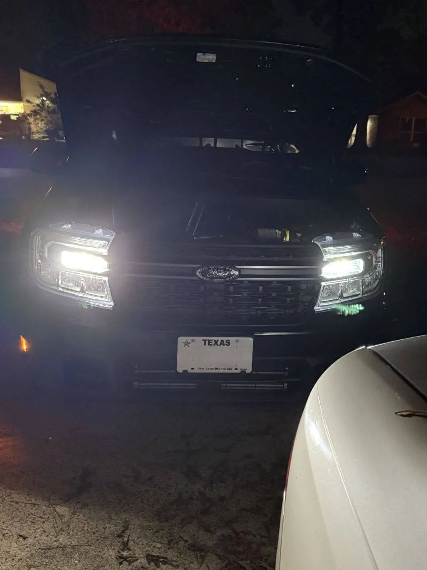

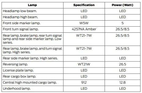

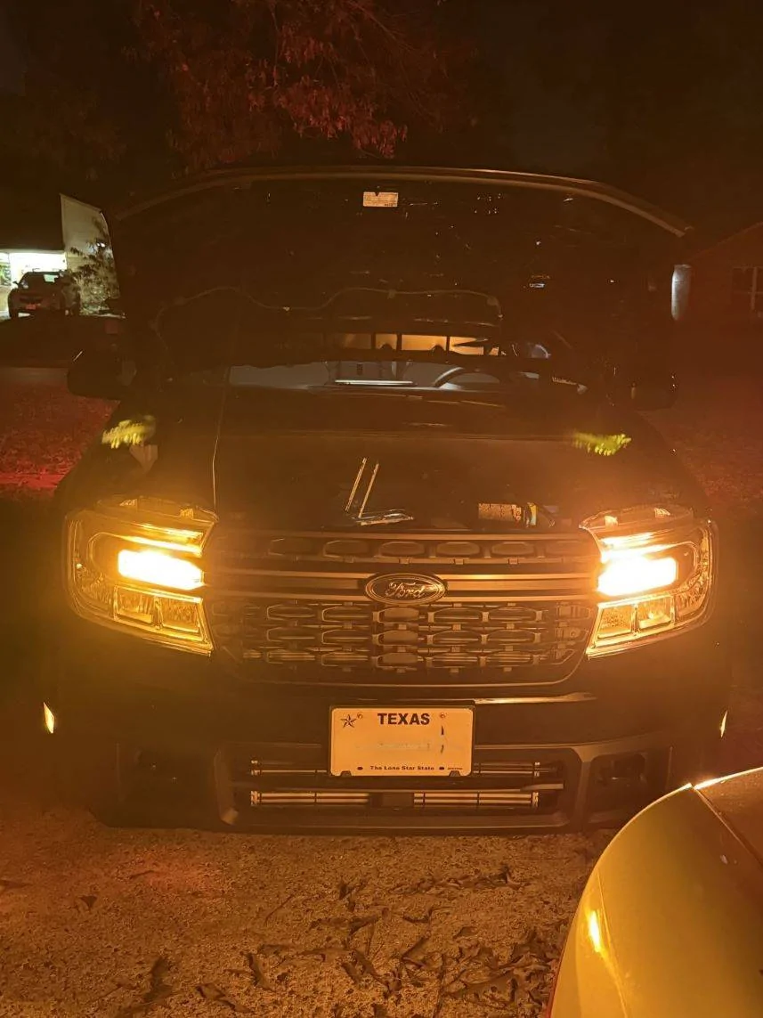

Found the list in owner's manual.
https://www.lasfit.com/products/ford-maverick-led-bulbs $167
This is five different bulbs.
diodedynamics.com only had the front Switchback $35
DD has all the bulbs (actually more), their website just isn't as friendly for finding by vehicle. Such a better product, I wish they would improve their website. But if you're willing to make a couple extra clicks...
The turn signals and the rear bulbs are all 3157 style (or they have the switchback as shown in this thread), the side markers are 194 style, the visors are 28mm festoon style, the third brake light/cargo lights I didn't order as I replaced mine with a F150 LED unit. They also have the add-on fig light kit, which I have been thrilled with. For the 3157 style bulbs you do have to cut, trim, or sand the little tabs off the sides of each bulb. That allows them to snap into the sockets and does not affect the DD warranty (3 years, except fogs are 7 years).
The only "catch" is the Forscan/resistor "work" needed.
I have had mine for almost a year now I believe and would do it exactly the same if I had to do it over again.

I'll make a quick guide - maybe save some trouble and encourage more people to buy a quality product even if it is a little more work. These are going to be the "mid-brightness" level for most, if you want brighter or dimmer you can still use this as a guide to find what you are looking for. Remember the 3158 style bulbs will need the tabs removed.
Front turn signals:
XL/XLT: https://www.diodedynamics.com/4257-hp24-switchback-dual-color-turn-signal-led-bulbs.html (Only one brightness available Qty: 2) **This is the bulb that started this thread**
Lariat: https://www.diodedynamics.com/3156-3157-hp11-turn-signal-led-bulbs.html (Amber Qty: 2)
Sidemarkers:
https://www.diodedynamics.com/194-hp3-led-bulbs.html (Amber Qty: 2)
Taillights/Brake Lights:
https://www.diodedynamics.com/3156-3157-hp11-tail-light-led-bulbs.html (Qty: 4)
Reverse Lights:
https://www.diodedynamics.com/3156-3157-hp11-backup-led-bulbs.html (Qty: 2)
Third Brake Light:
https://www.diodedynamics.com/921-xpr-3rd-brake-light-led-bulbs.html (Only one brightness available Qty: 1) **I have not used this bulb**
Cargo Lights:
https://www.diodedynamics.com/921-hp36-cool-white-backup-led-bulbs.html (Qty: 2) **I have not used this bulb**
Sunvisor Lights:
https://www.diodedynamics.com/28mm-smf1-led-bulbs.html (Qty: 2)
