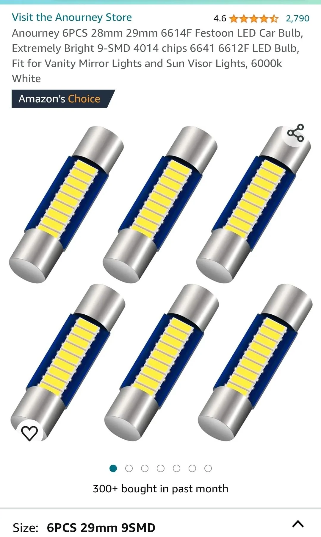

when upgrading mine, I think I'll go with this brand:
https://www.amazon.com/gp/product/B09W2Z5737/ref=ewc_pr_img_1?smid=A3IRWXE7MBLWWJ&psc=1
seems like a lot of manufacturers "overclaim" the lumen output..based on what I've read, these bulbs *should* be beteen 900 & 950lm, but manuf. is claiming about 500...while not as high as others' claims, it's nice to see someone not jus tpulling numbers from where the sun doesn't shine
I got mine from Diode Dynamics and they claim to be a true measured 16 lumens. They are on the verge of being too bright. I don't know how accurate those other measurements are, but don't forget that you are basically staring into these lights when you use them and you really don't want them too bright.
