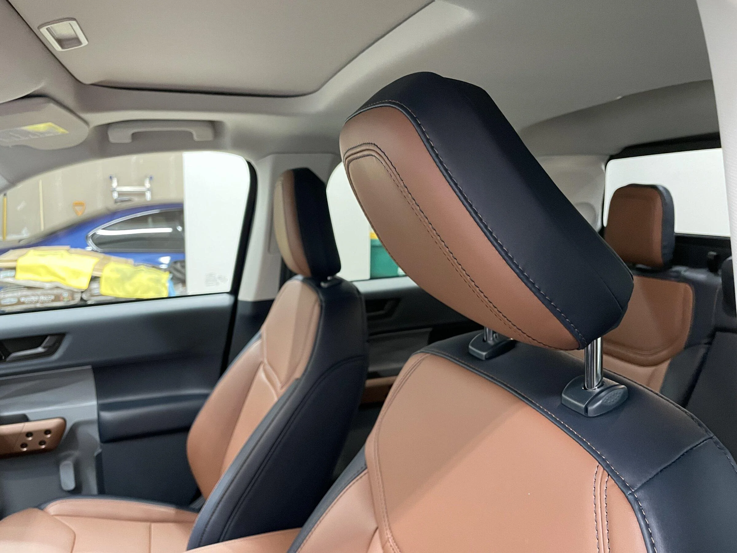

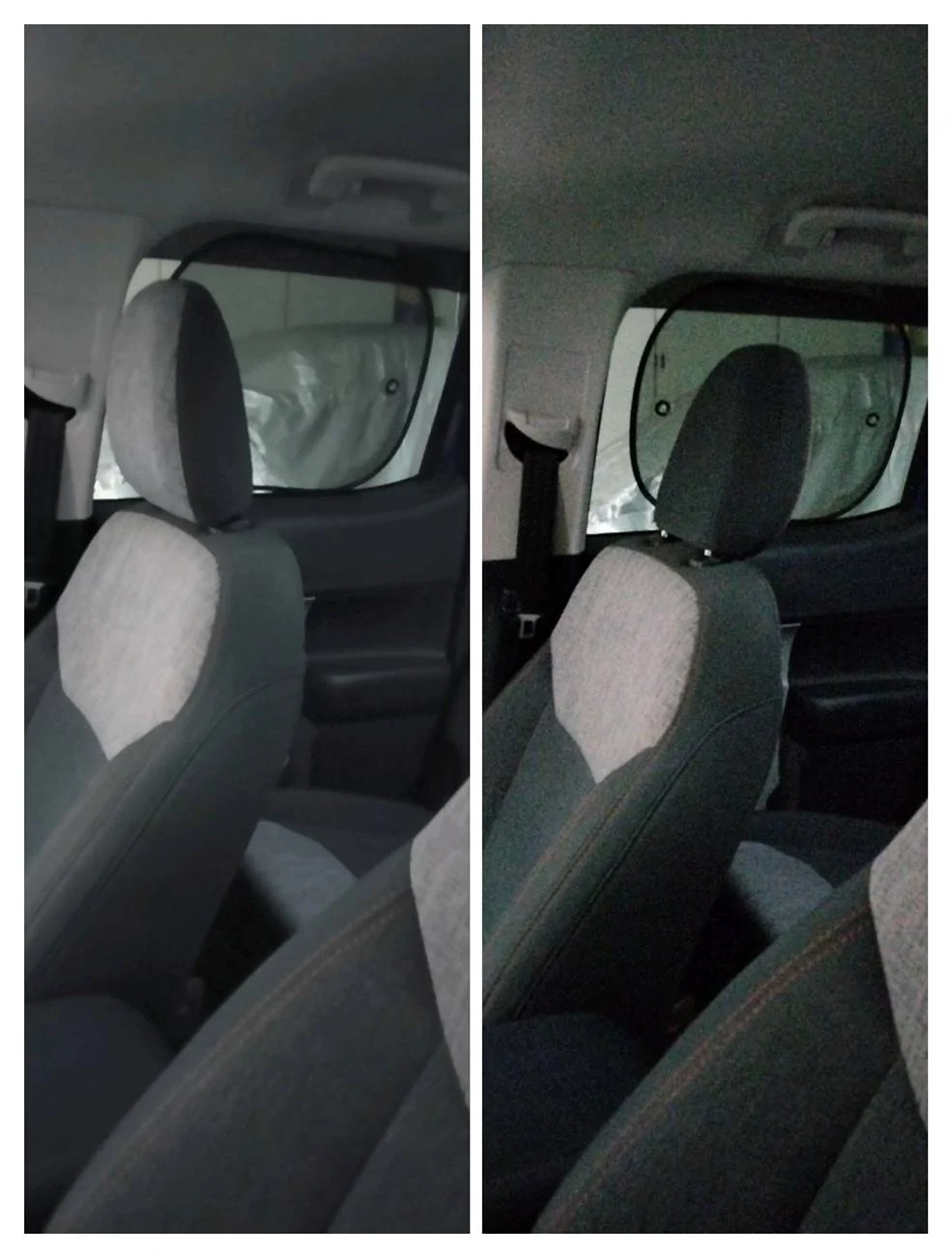

Yes, old thread.
I just got my 2025 Lariat, but as far as I can tell the headrests do not tilt. I'm hoping I'm just doing it wrong as I find the headrest too far forward and just removed it. Can anyone confirm one way or the other?
Can you rotate them 180° granted they will not snap into position.
I recall seeing a thread where someone replaced the headrest from another model and it wasn't as forward. I'll probably look into that, but the headrests do fit in backwards meanwhile.

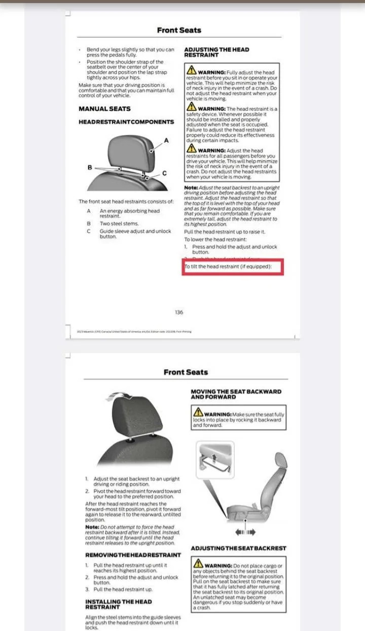

Those headrest's were from a Ford Escape and just so you know. The supports are not an exact fit to the receiver in the seat back. They had to be trimmed or new plastic receivers installed.
Attachment from 23 Maverick owners manual 👇👇👇

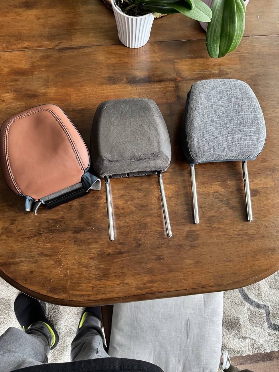

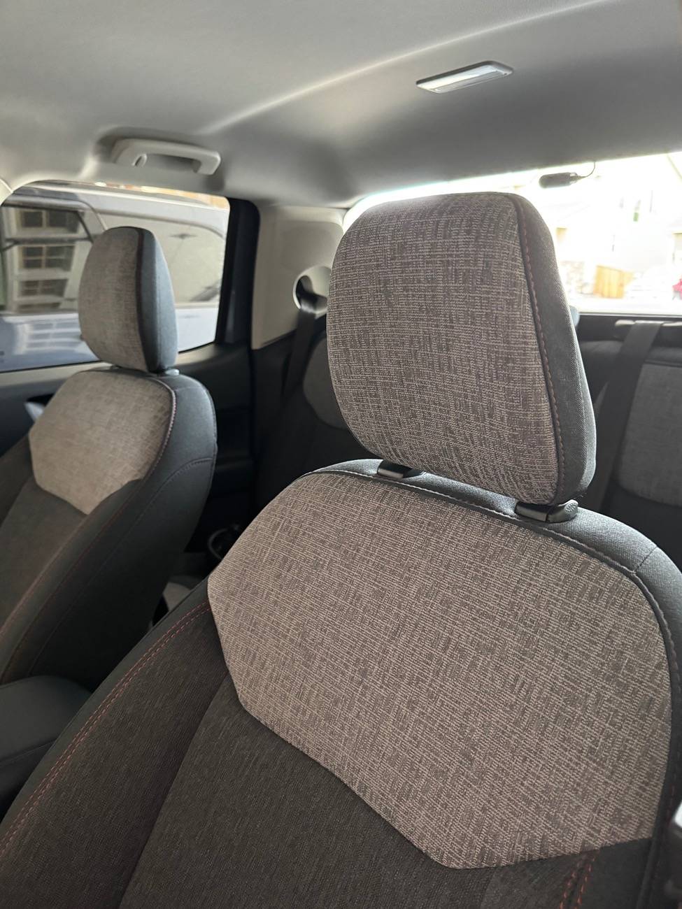

I had the same issue as OP, hate the non adjustable headrest. I swapped my 24 XLT cloth headrest cover with a lariat leather adjustable headrest with no issue. The cloth cover doesn’t have as much cloth to be stuffed into the posts but it’s barely noticeable from the backside. Functions great. Ordered the headrest from a totaled Mav off eBay - you could buy it OEM as well.
