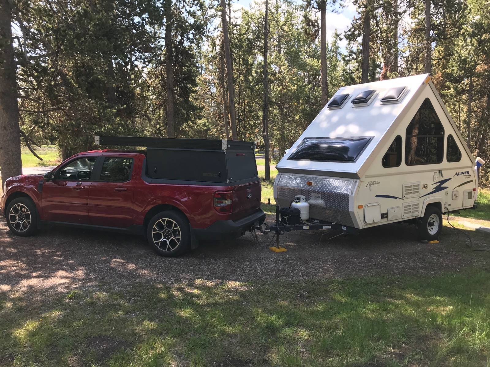

Just an update for the dangerous types out there. I rewired the truck so as to make lane centering work with a trailer attached. I pulled a camper trailer out from Connecticut to Montana and back, the last part being a 27 hour sprint. It worked great especially toward the end!
Ford Maverick Lane centering inop when trailer connected, dealer couldn't fix. IMG_3322
What did you change?
I installed a 2nd trailer plug (retained original) and 1) wired trailer tail lights from the original plug, 2)signal/brake from the factory rear signal light housings (right and left) (I switched 2 of the taillights over to LED), 3) battery recharge from one of the two circuits Ford provided for options, 4)ground to chassis. On my 23 model year Maverick even with a factory trailer plug, Ford did not provide trailer brake wiring even know they recommended trailer brakes at 1600 lbs trailer weight, so 5) I installed a "Autowbrake" and used the same on the 2nd trailer plug of my 25 Maverick to control the brake circuit.
