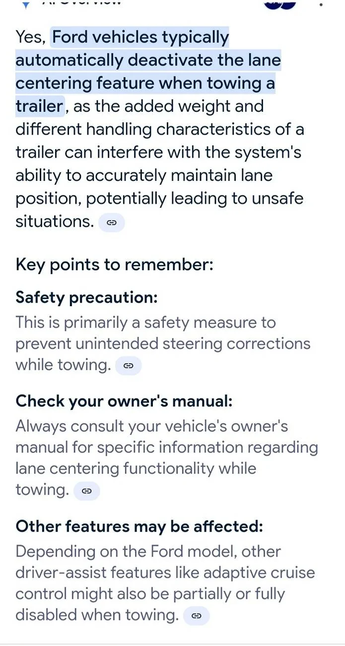

According to Ford it's exactly about safety. Starting in 2023 Ford decided with their larger trucks to deactivate Lane centering while towing.
F-150 owners were complaining about it in 23.

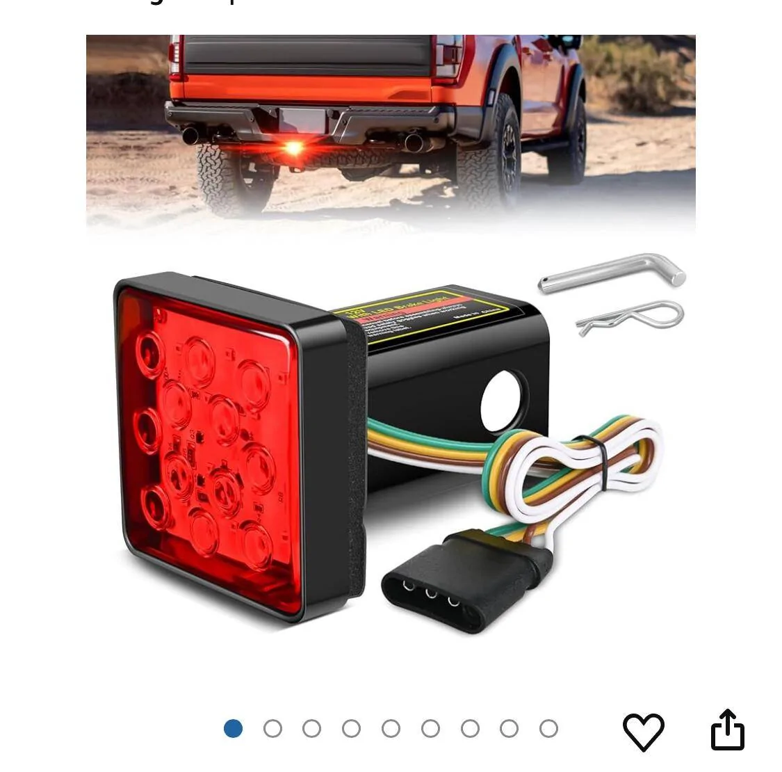

It also turns off blind spot monitor.
It detects power going to trailer lamps to know there is a trailer.
It does not matter the size or weight of the trailer, nor the mode.
You lose those features also if you plug in a decorative / auxiliary light to your trailer plug. Like these:

I don't know if it's still true. There was a time when that would also disable the start and stop.
