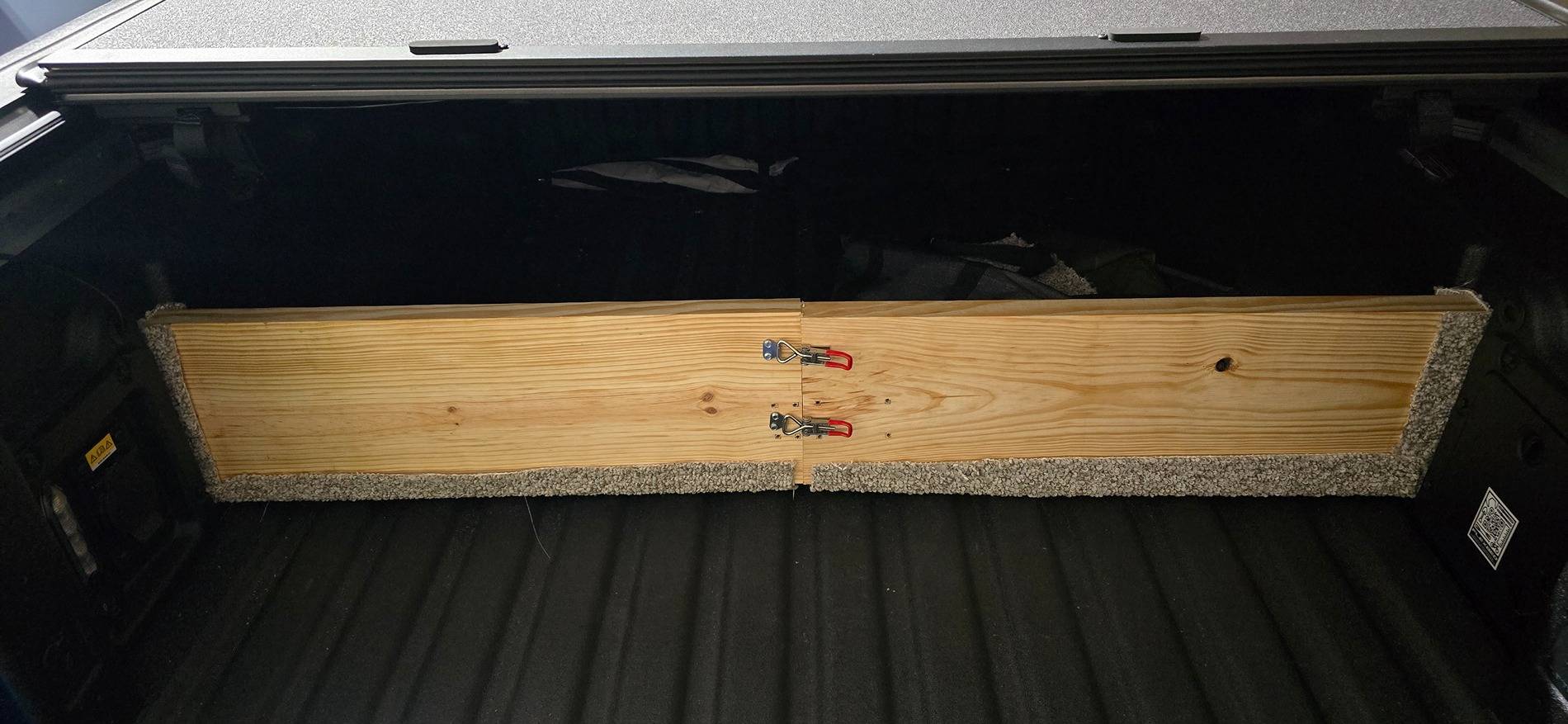

Ford Maverick Keeping storage items from sliding forward in the bed 1000026367
I used a 2x10 with hinge in middle and carpet to help with the fit. Easy to put in and take out.

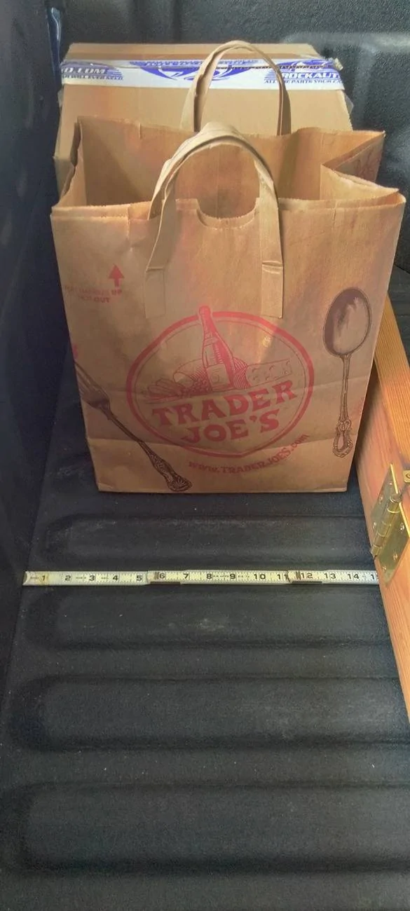

For me, when using a 2x6. The storage area between the board and tailgate is way too small. It only gives you 15 in of storage.

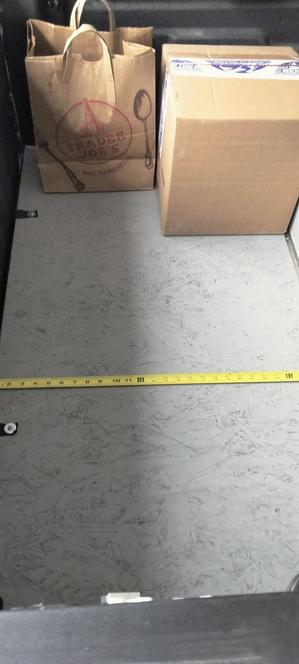

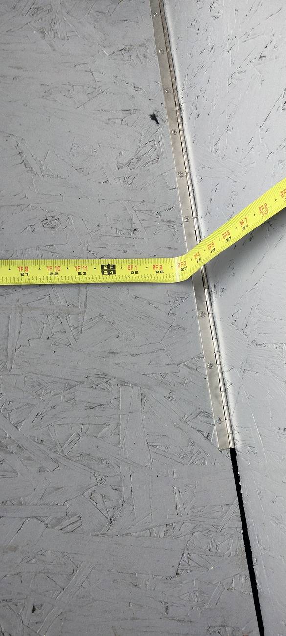

In answer to your question is...
Yes I made my pullout tray.
I specifically made it, the same size as the storage area behind the second row seats in my wife's Escape. 90% of the time that area is enough storage area for us when we go shopping. Cutting around the wheel wells was the toughest part.

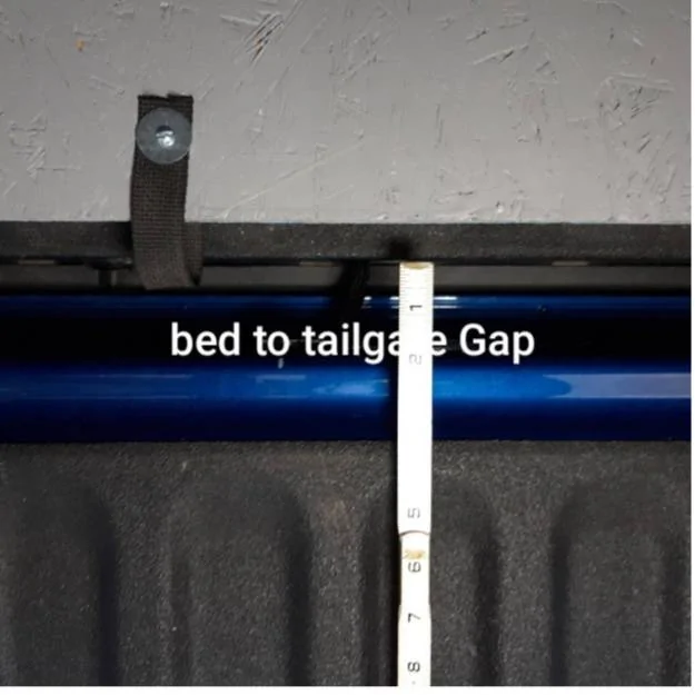

I wanted mine to be light, so I could slide it out onto the tailgate covering the Tailgate Gap. It's
I made it out of particle board.
Home Depot had a piece that was the perfect size. I had them cut it for the upright portion.
Wood, piano hinge, attaching hardware and discounted unwanted paint at harbor freight. Total out the door, less than $30 ?
Ford Maverick Keeping storage items from sliding forward in the bed 20250331_083813
At 70 years old with not a great back. I'm not lifting stuff out of the bed while bending over the tailgate.
Rather than dragging stuff across the Tailgate Gap and possibly getting hung up there. I wanted something that I could pull to me that covered the gap.

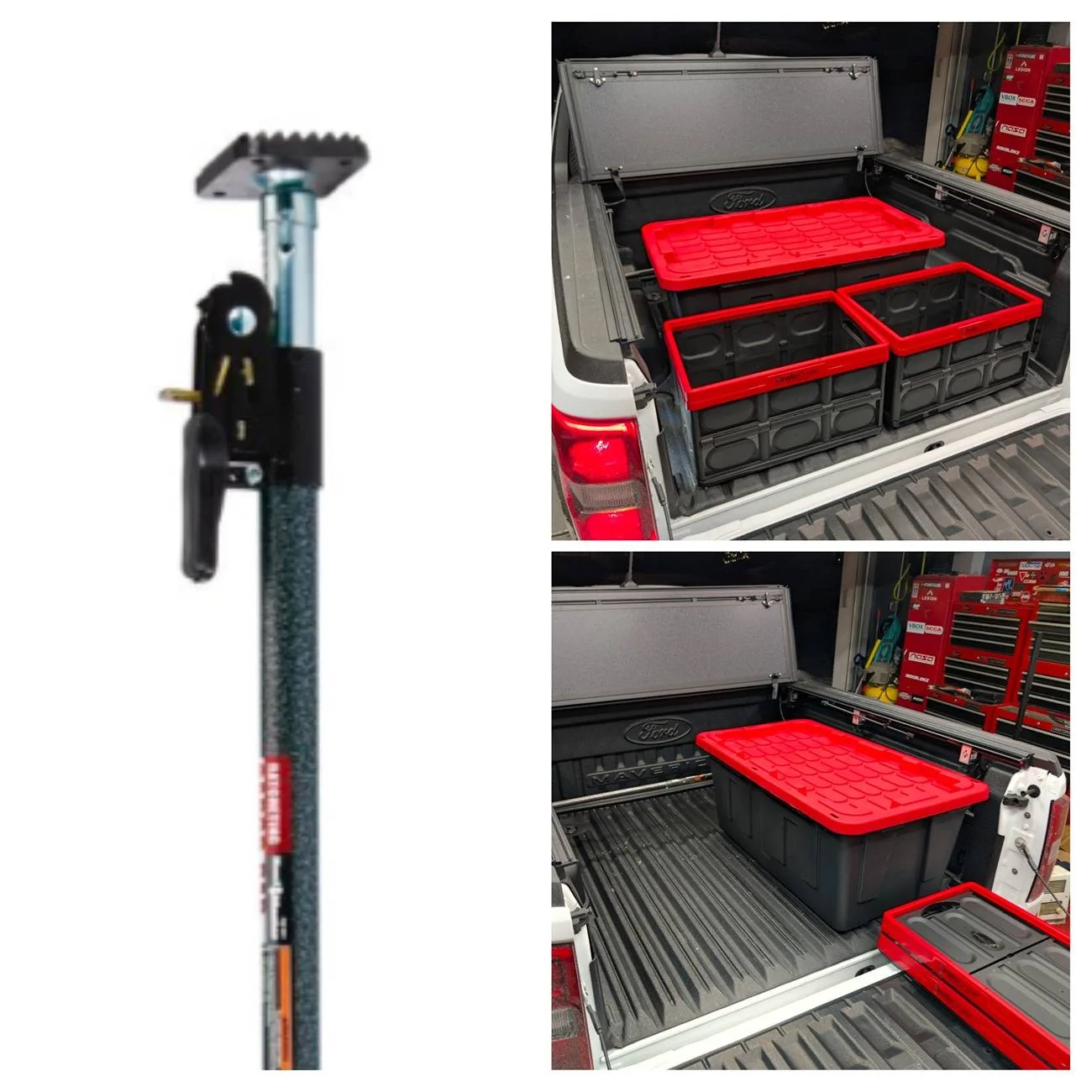

I like a basic ratcheting cargo bar. Combined with some collapsible storage crates, it handles loose items and can be quickly reconfigured on the fly to stow bigger stuff.
By far to simplest way to keep stuff separated in the bed.i have two in mine

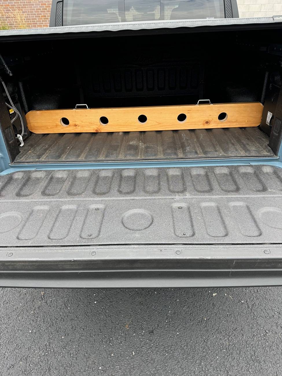

@Glen Baker LLC I made this one out of a 2X6 and rounded the corners, then drilled the holes. It goes in and comes out really easy and is suprisingly light.

Your 2x6 looks nice, with the holes, which lightens the weight. The handles and rounded ends are great for easy removal.
Using a 2x6 a 2x4 or 2x10 does not solve MY issue of too little room between the board and the tailgate.
. I found the 15" of storage space from the board to the tailgate to be inadequate for our shopping needs. My design gives 27 inches of storage area. I didn't like having to bend across the tailgate multiple in order to pull items out of the back. When I can pull the whole tray to me once.
And if I need the full bed. I pull out the end brackets, the front portion lies down and I can use the whole bed and have nothing to store.
