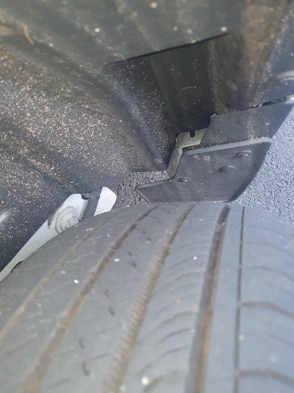

You spray down from above and behind the rocker. Here is the view from above. This is in front of the rear tire. The previous pic was looking inside. Knowing is most of the battle here. I didn't know that the rockers needed flushing before, now I do. Helps to park uphill for drainage, which I am anyway. I flush them at the self-wash bay now too.

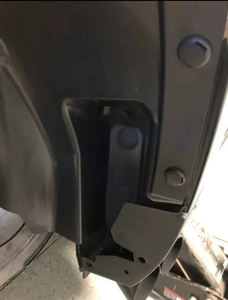

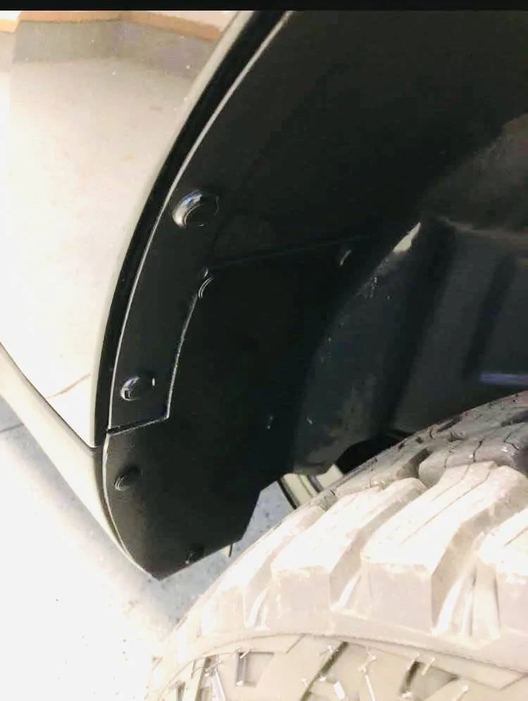

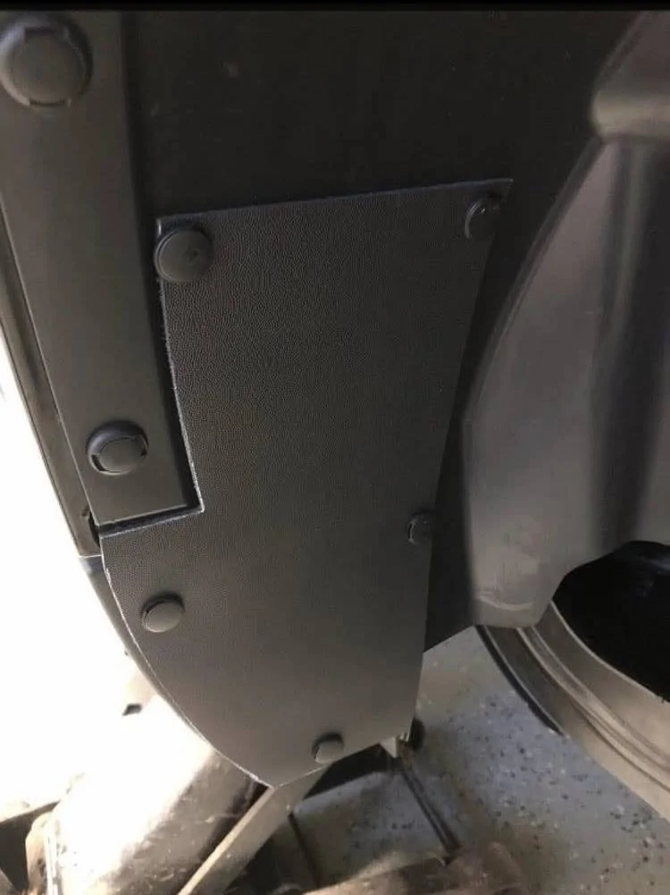

I made these. Stopped a big % of the junk from being thrown on from the rear tire. Plus side looks more finished wheel well as well. See before then after. Some members mention I should contact Mabett or another Maverick Amazon seller and have them make these. 🤔🏁
