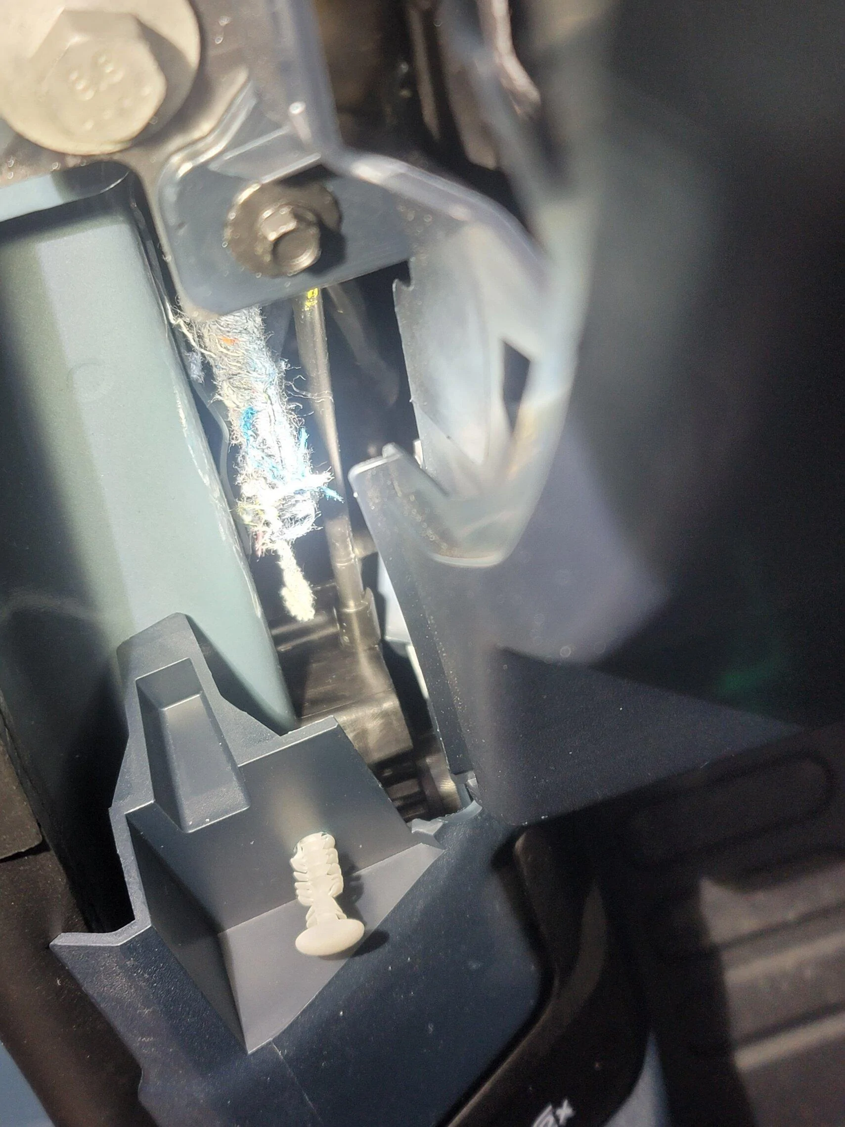

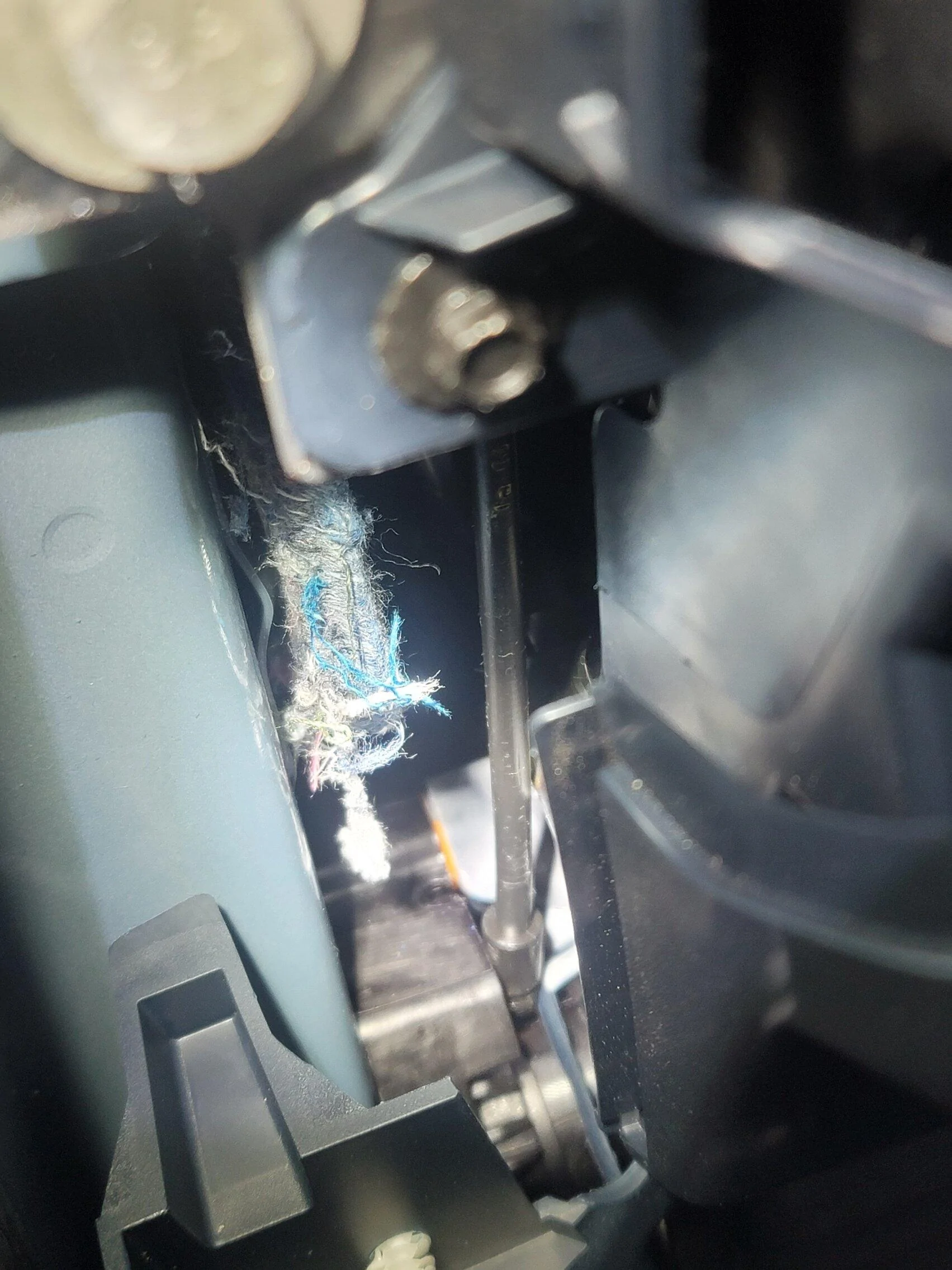

Has anyone had any issues/problems with the hood release mechanism?
The cable came off the release handle so when I pulled the handle the entire cable moves instead of the inner cable attached to the latch. My dealer looked at it and ordered a new handle mechanism. (and of course it's back-ordered). I can still get under the hood by using a pair of pliers to hold the cable while pulling the handle.

I have seen the video where an assist spring was added to help lift the hood free of the latch. IMO, I'd sooner cruise a boneyard to find a more suitable spring than the one used if that's the only solution. Older Rangers had a spring built into the hood(well, bolted in place) that pushed on the top of the latch when the hood release was pulled. The latch stuck up into a square hole in the hood and rotated a finger onto a spot in the hole to keep the hood down. When the finger latch was released, the spring(arm style) would push a bit to open the hood. It seems the spring was optional based on year/equipment, and whether there was sound deadening material on the underside of the hood.

I have that, and may be able to drool some onto the cable sheath where it rests in the slot. If not, I will have to remove the lower panel. Too old to fit down into the pedal space readily any more, and when I try, I find I have pain things I did not even know were there.
Honestly, this is a crappy design as a retainer. Even making the slot into a "L" shape would have been a better idea(I think), and not much more difficult to assemble. Assuming the slot is part of the die for the plastic to be injected into. What do I know...

I was thinking about bending the edges of the bracket up a little. Very small width (part of the problem) so might not actually do much and getting to it probably not worth the effort.
RE hood springs: I think I've found adjusting the small bumpers at the front may have solved my issue. Backed them out 1/2 a turn and seems to be working better so far.
Raising the bumpers 1/2 turn will be my first step. It couldn't hurt.
