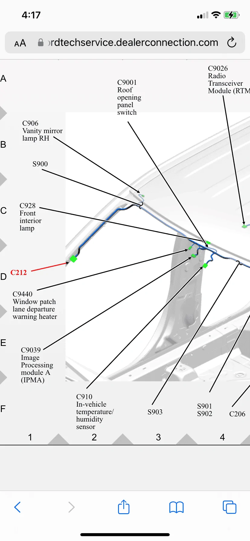

Have them look at connector C212, it’s behind the passenger a-pillar trim panel, they probably pinched this harness when installing the new airbag lower tether bolt, I’ve had to fix other techs hack work after recall 22C20 has been done, found that harness smashed behind the tether twice now
Ford Maverick Interior lights staying on after side curtain airbag recall IMG_9249

Ahh… thank you for the sketch @50s4ever! They did say something about replacing a connector next so hopefully C212 is the one. I will check and find out.
I truly appreciate everyone’s expert advice here. Nice to know Ford is backed up by such great service experts!

Well, I got my truck back yesterday with all the interior lights working correctly again. I was given the service information second hand, but it looks like @Senior Master Ford Guy and @50s4ever get to split the prize. 😂
From what I was told, “the connection was bad in the back of the map light itself”. I assume they are referring to connector C928 in 50s4ever’s sketch.
Not sure which side of that connector is male, but they said “the pins were loose” and that the “new connector” has everything fitting properly and the switch functions as it should. I’m guessing it was the C928 connector in the harness itself that they replaced.
In any case, thanks again to both of you for taking the time to respond and pointing them in the right direction. After driving around for 1 & 1/2 weeks in a ‘22 Code Orange F-150 Raptor beast (loaner), I’m just delighted to have my little Mav back! 😎

Problem Resolved:
Got a copy of the official service report with this additional information.
“Found that while testing pin fitment, pin 3 of connector C928 for circuit VLN33 was not being properly secured in connector allowing overhead console module to push pin out of connector. Replaced connector. Test overhead console. All ok at this time.”
