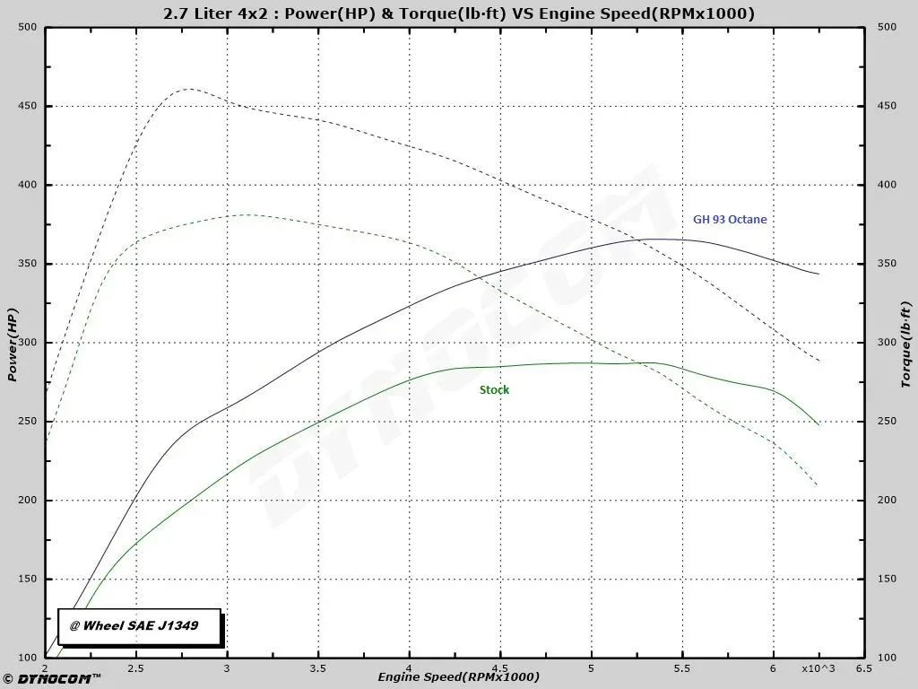

I had an E85 tuned '18 2.7 F150.... I've never seen a gas tune get 450hp on a stock 2.7, do you have a dyno chart?

Ford Maverick Intake noises - anything to be gained? 1782782229686-id
380 HP and 476 torque on 93 octane. I was using the 10x conversion of exhaust air flow (44+ pounds WOT) for HP at the crankshaft. Crank HP vs rear wheel difference.

Gotcha. That is in line with typical 93 perf tunes. The 2.7 has a ton of margin....

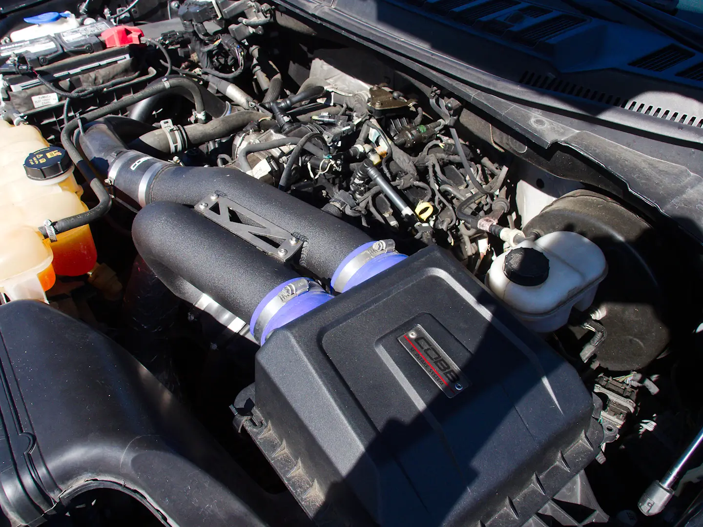

Nothing wrong with personalized bling for the vehicle! But calling the stock CAI a POS is overdoing it. They are NOT pretty but they work as well as any aftermarket CAI. Hell I have a COBB twin tube CAI on my F150, wanted to find out if independent intake runners would make a difference. Butt dyno said yes, timed runs 0-80 MPH said no (it slowed down). This started a week long series of experiments for a retired motor head to wrap his fat head around. Equipped with a Draggy and monitored exhaust air flow experiment ensued. From no filter at all thru a bunch of configurations I managed to get better 0-80 times with the COBB CAI modified to use the stock style panel filter. This was a fraction of a second fastest over averaged runs, not any real gain but consistent. It is a closed air-box as I did not want any under-hood air in the intake. I does look good though, once past the plumbers nightmare on top of the 2.7!
Ford Maverick Intake noises - anything to be gained? PA160002
